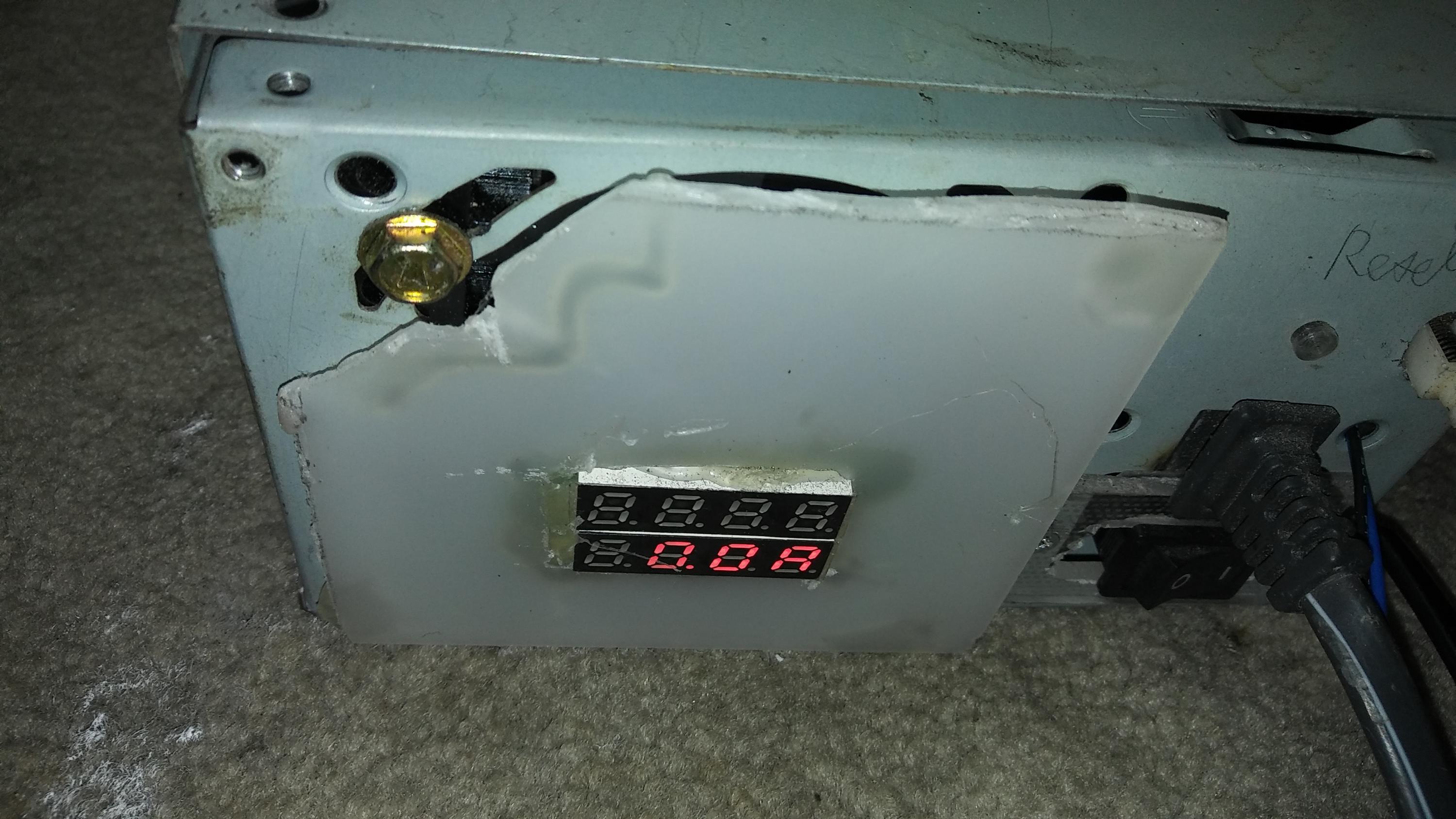

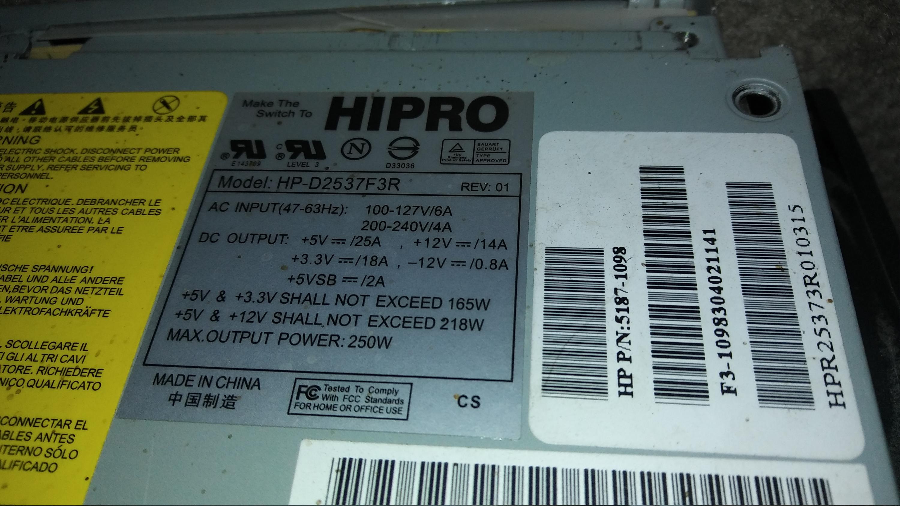

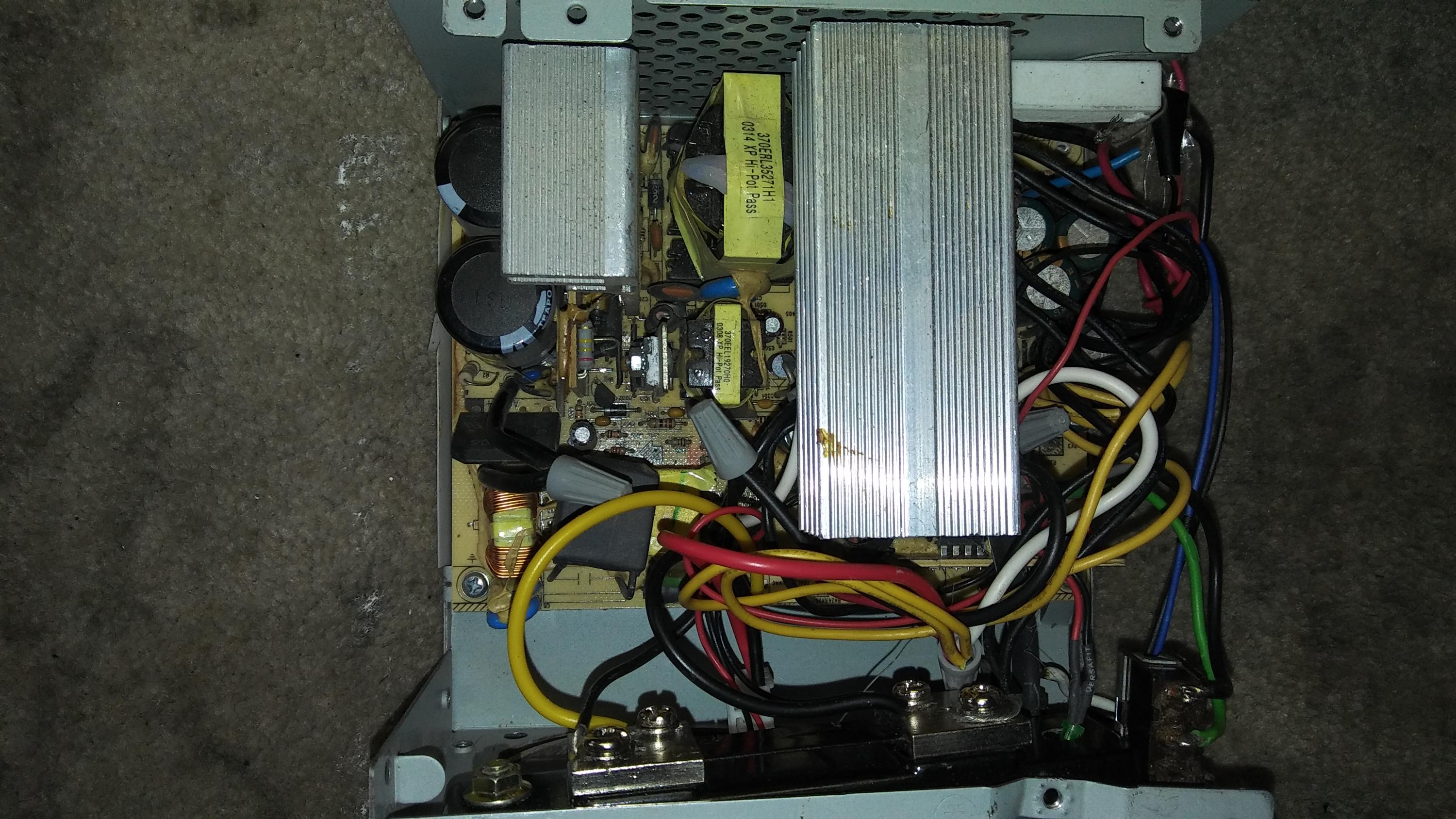

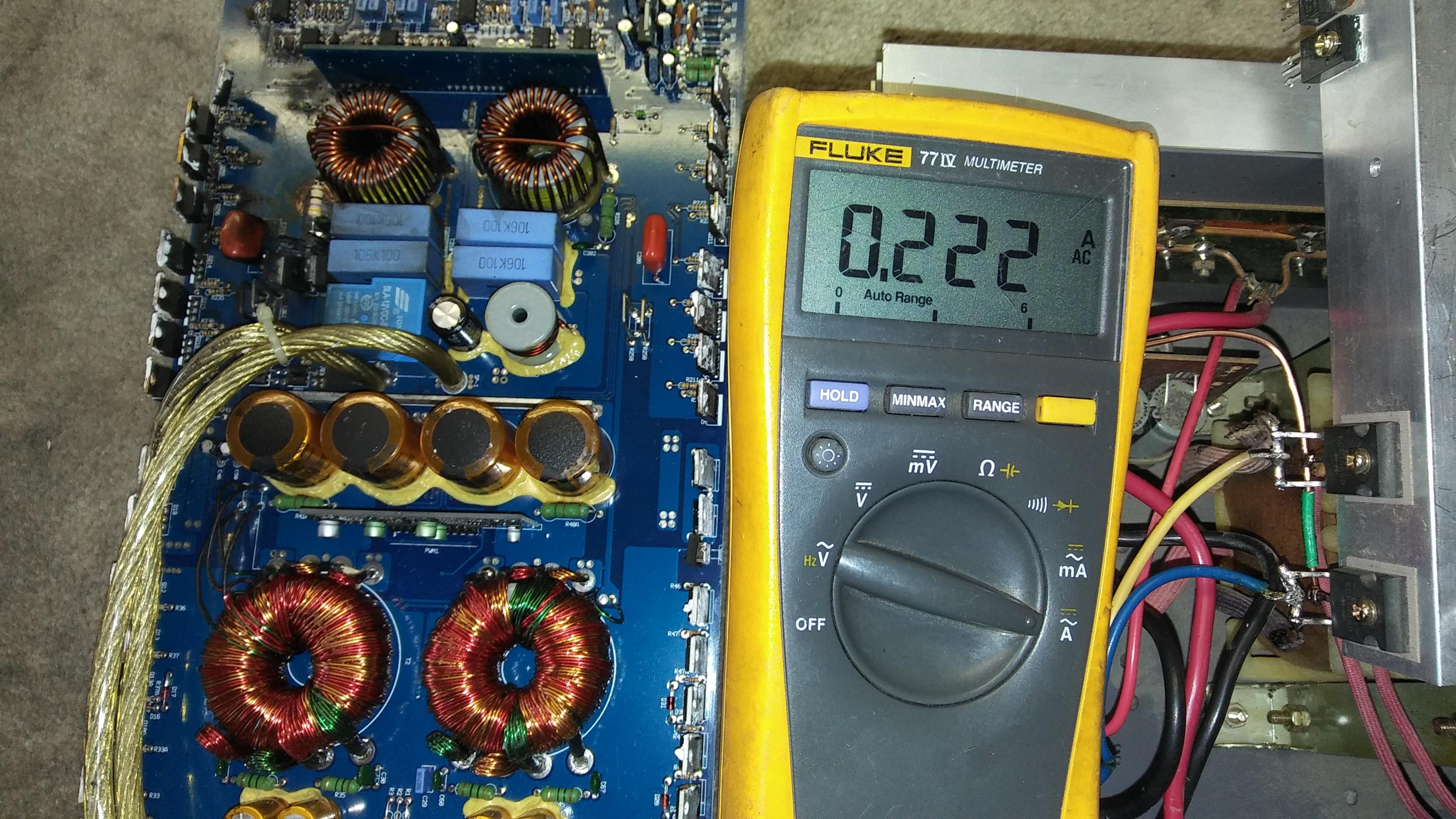

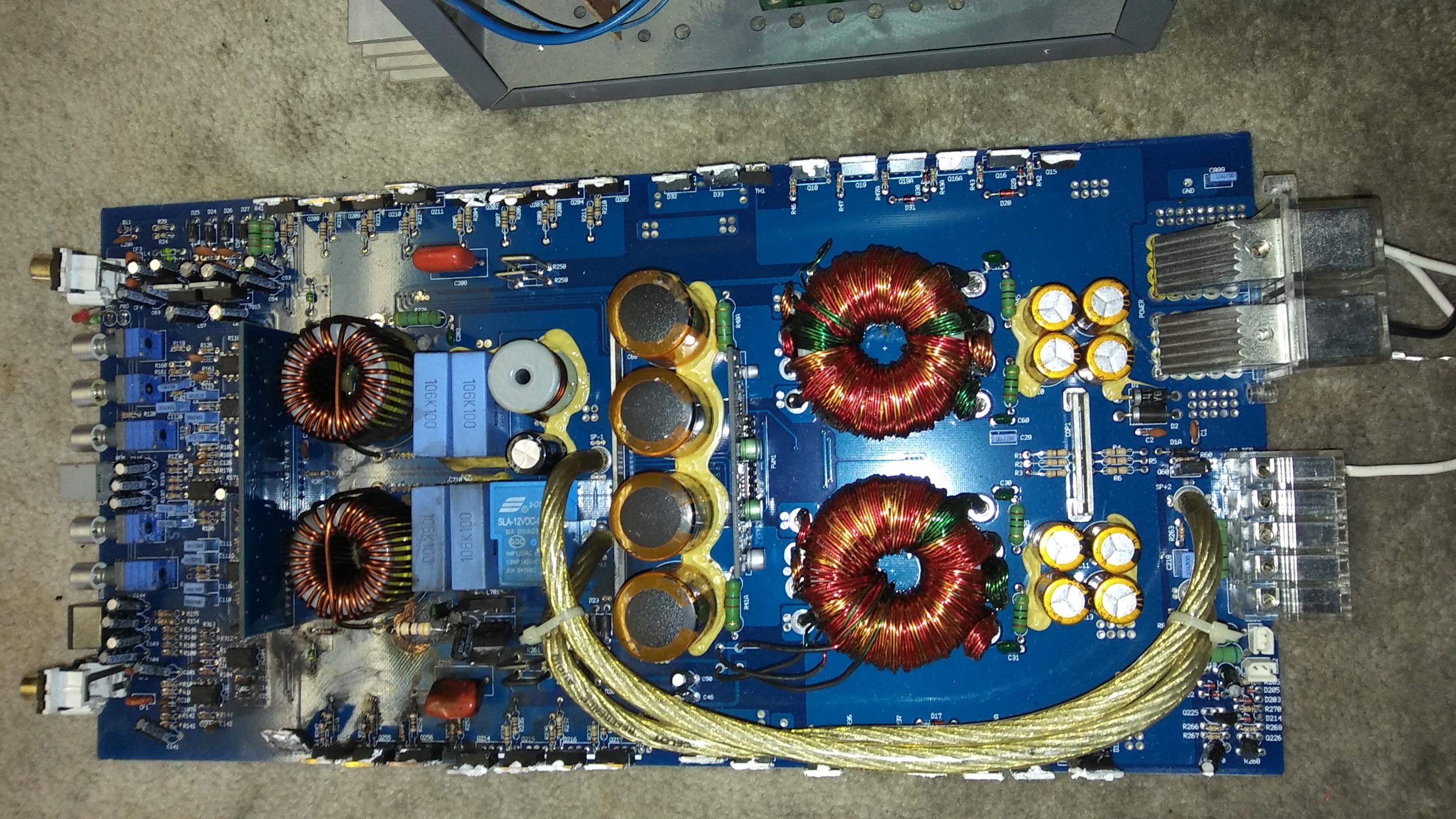

    This car Amp I use my PoorMan's ATX power supply keeps cutting off the ATX power supply. I will need more current for start up the Car Amp.
    PS: In the picture show 0.2A but the surge current keeps on cutting the ATX power supply? With the one I just fixed, Amp. works flawlessly?

      Re: Full wave rectifier vs bridge rectifier?
      try NTC resistor to slow down power up .
      this might be interesting ..http://nevarllajf.com/daniel/?page_id=44
          my room heater is 2kw
          better to use atx to keep car battery charged up .. then amp should always start up if you dont run it for long
              car amps are expecting a large reserve supply . big capacitor might do it or lipo battery ..
              atx supply is weak link here .. be gentle with it ..keep the bass down and use high ohm speakers . i used to run everything from 12v for years then i got mains supply again .. 48v supply is much better .i will go for that if i lose mains again .
