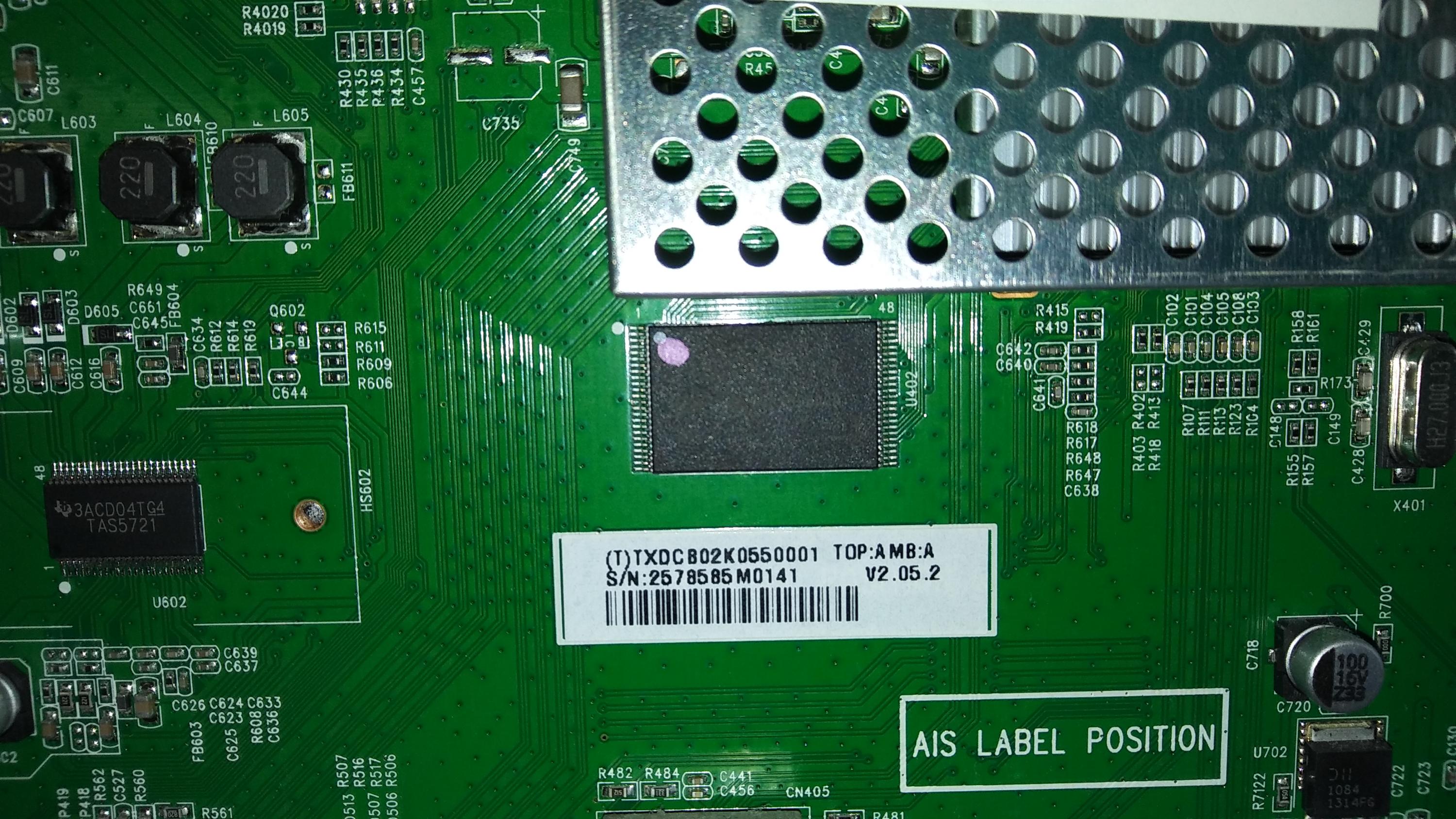

This vizio-logo-keep-stay-on TV only works in freezer. cover it with snow then works. I found out is EEPROM problem( test with Dust-Off), the PCB for this TV is $28.94, I have ordered but I love to read the information in the EEPROM then write it to the good one. For fun!
PS: TV is 500i-A1 756TXDCB02K055 Main Board (for LTYWNTBP), EEPROM is MICRON 29F16G08CBACA
MT29F16G08
