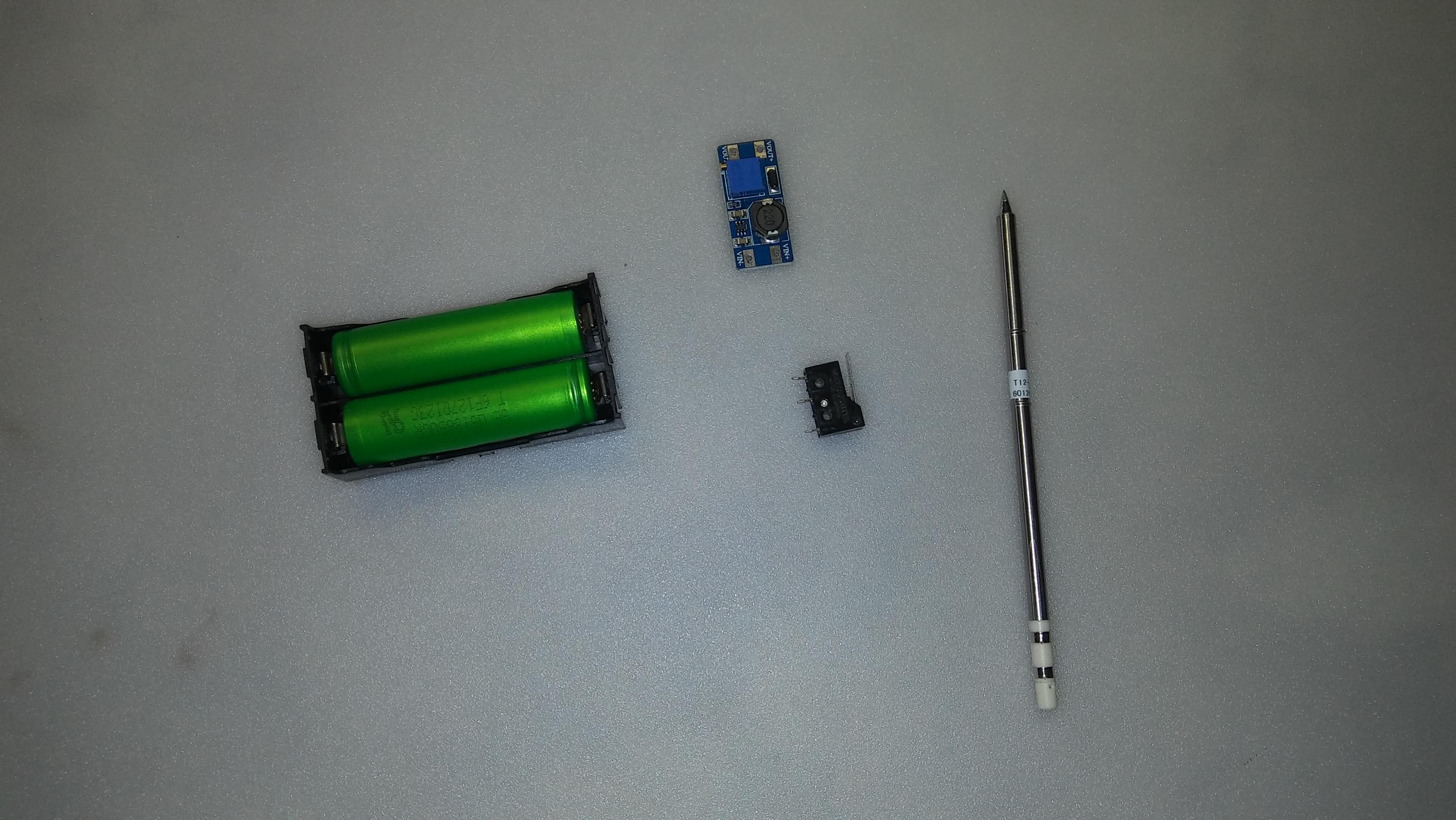

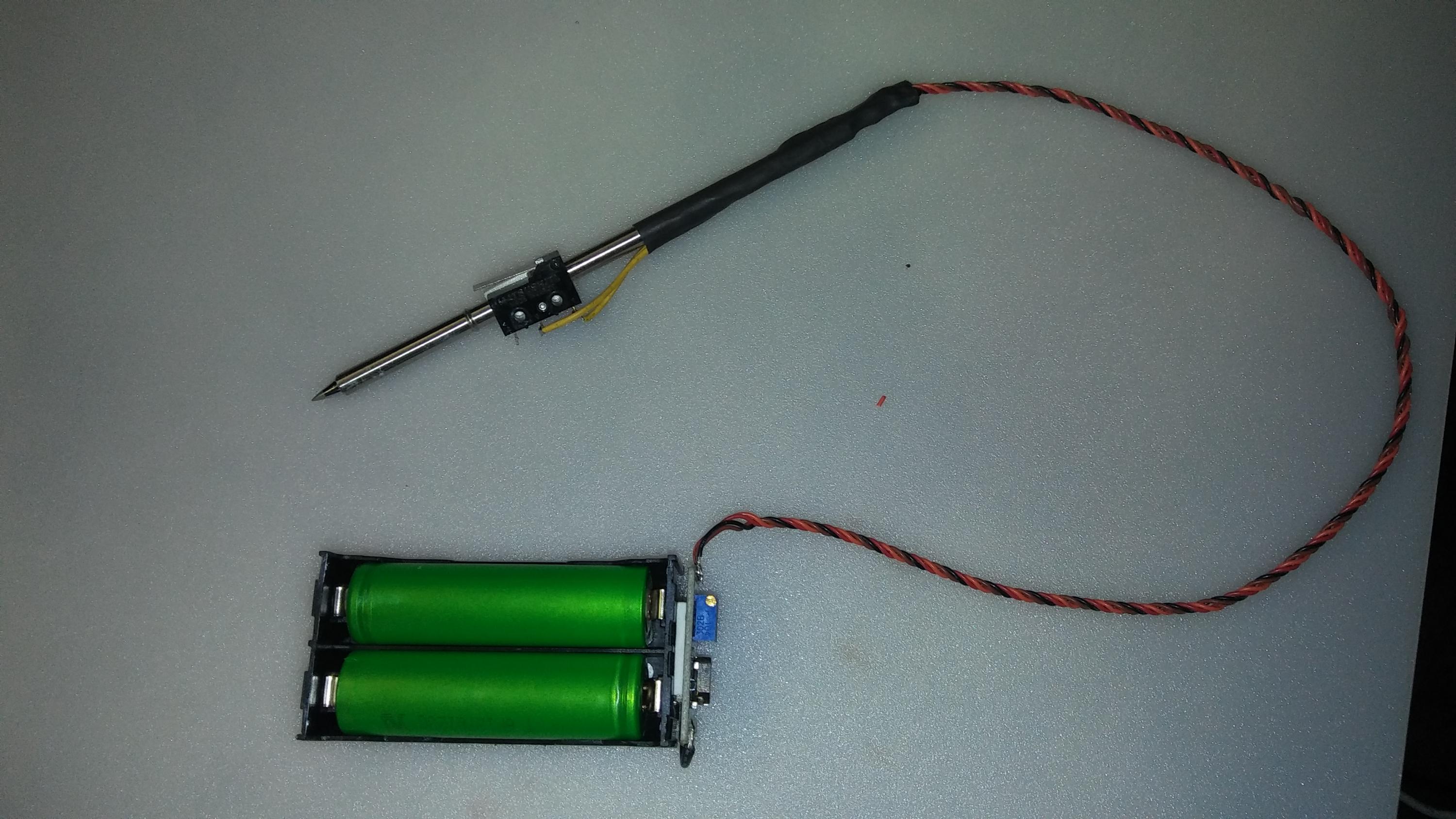

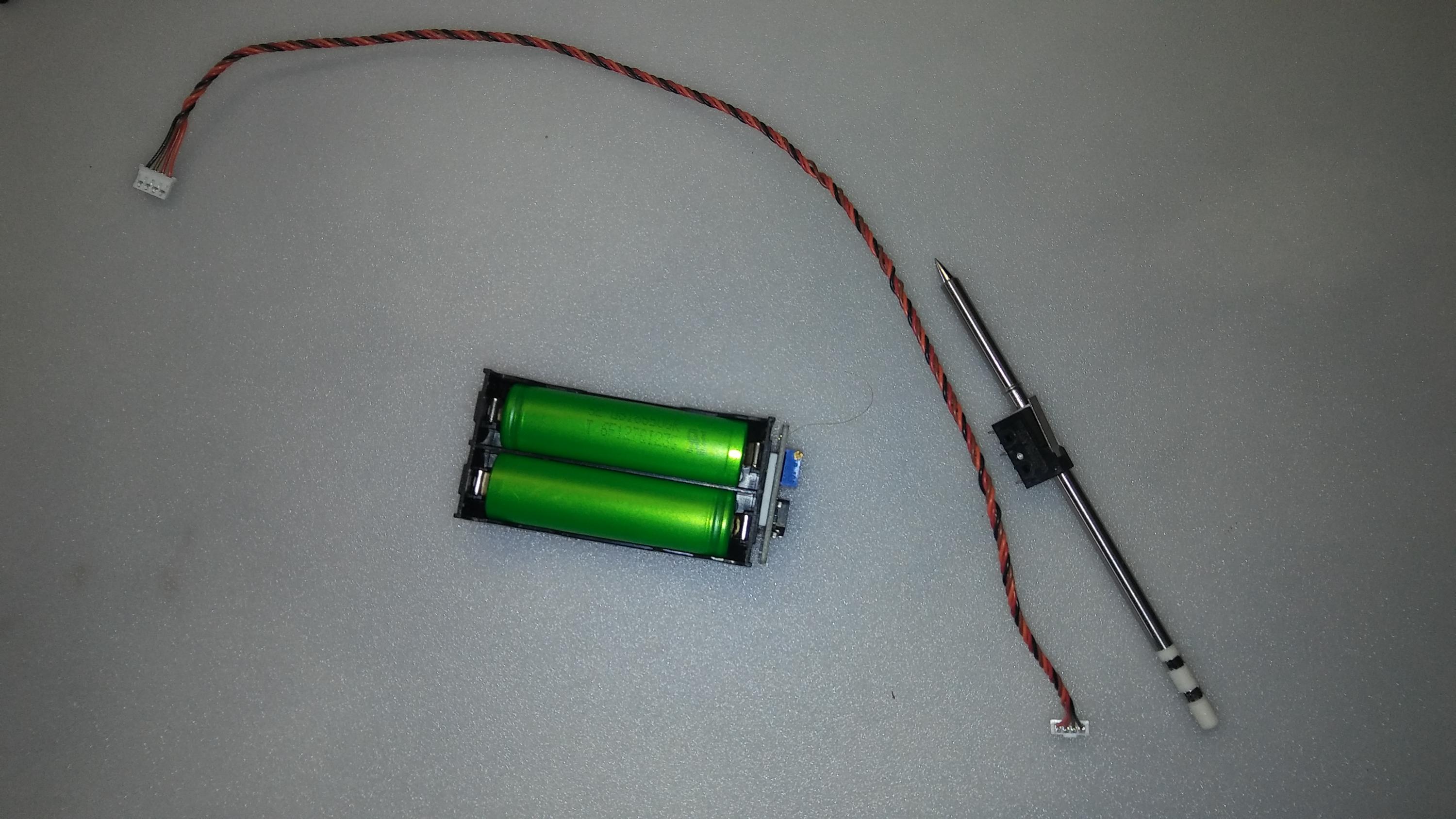

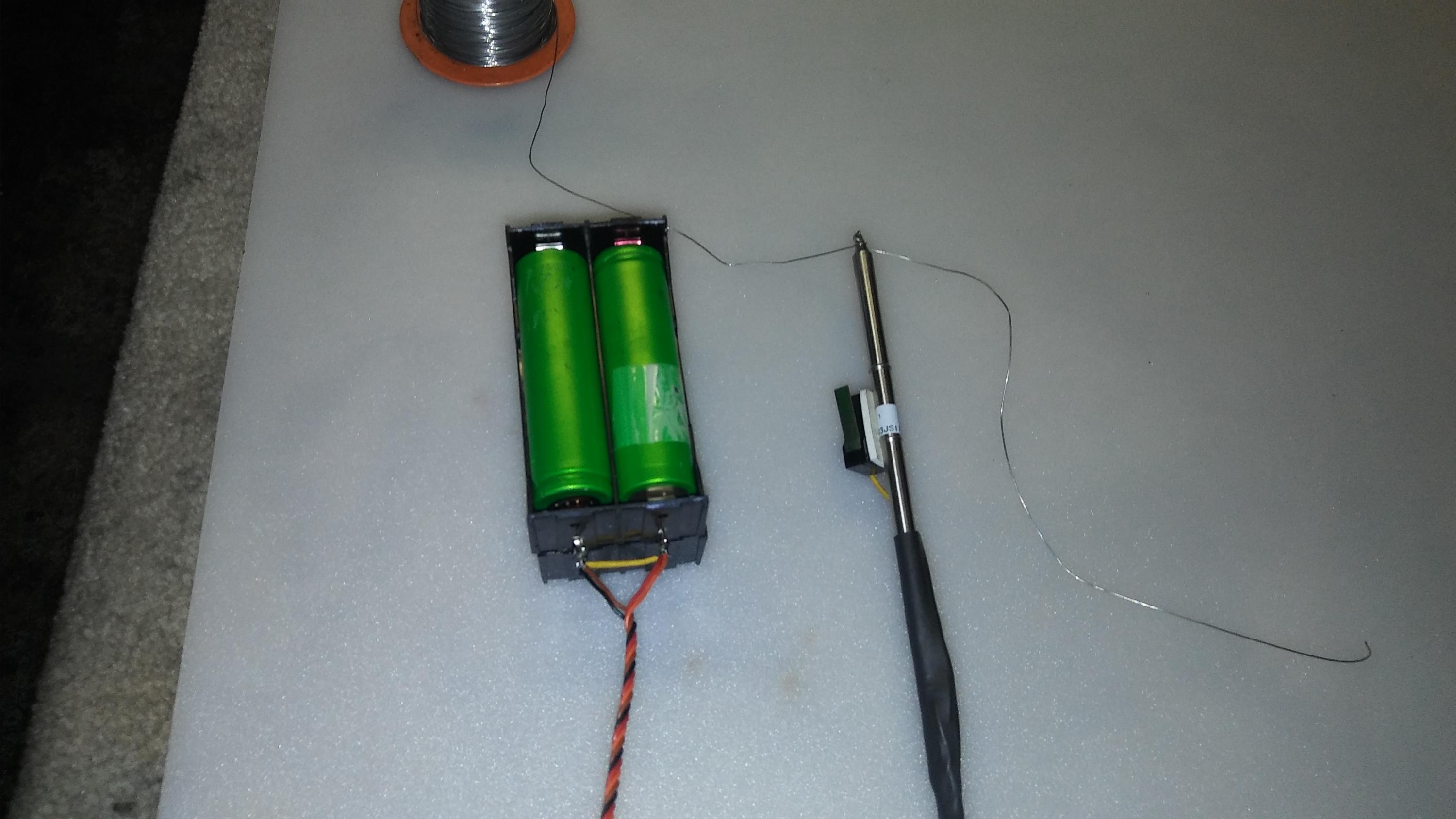

    T12 battery portable iron
    T12 iron tips + two 18650 + MT3608 2A Max DC-DC Step Up = battery portable T12 iron......................
    PS: 10 sec to heated up the iron, voltage adjust to 24V.

    So the load IS (T12) at 24V @2A OR MORE? which is about 48W @2A of power (t12 is rated at 70W).
    So How much current are you drawing from those two 18650 connected in series to provide about 8V to the boost converter?
    I estimate at 6A or more, I hope you have good protection circuit not to allow over current and not allowing the batteries to discharge to unsafe level before being recharged, and battery can handle high current.
    It remind me those E-Cig that people modify to get more heat but ending blowing in their face.

      You are right when I push the on button it drop to 12v, will test more and give feedback, I think use 4 x 18650 will be better.
      PS: Will try 2 x 18650 without boost converter. voltage is not that important because I did not use the Thermocouple , it depends on current.

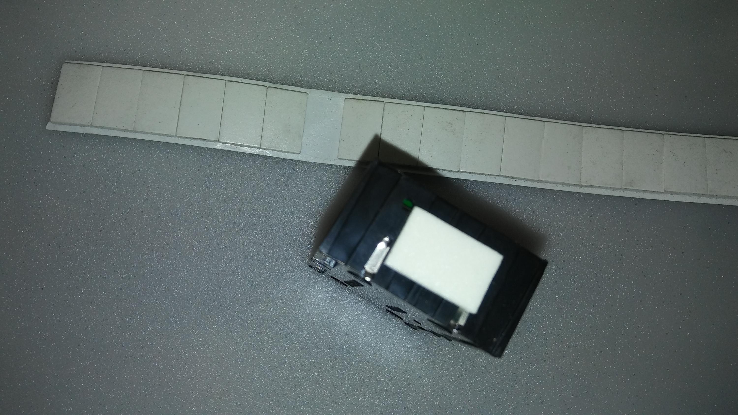

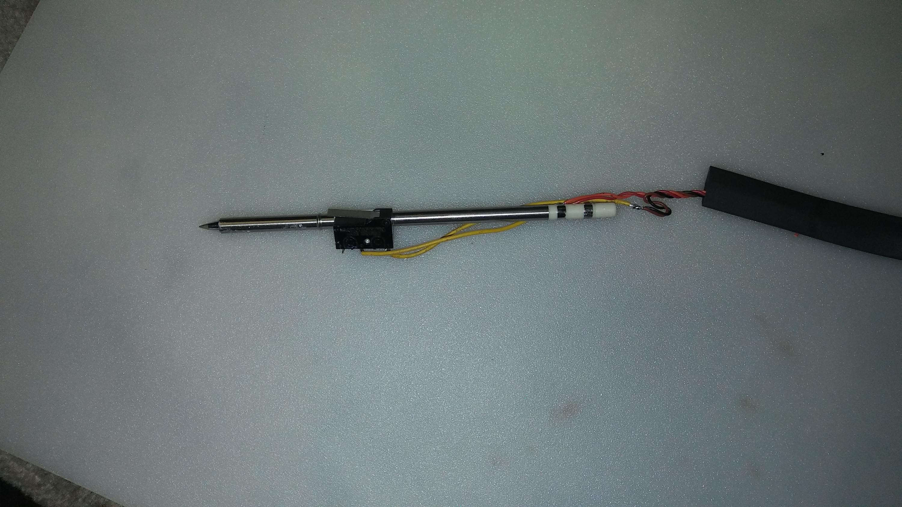

        BTW, that micro switch has the load current or input current flowing through it? I hope it can handle the current as well if you use it that way instead of using as on/off control signal to turn off the Boost converter circuit through the control signal pin.

            "micro switch has the load current or input current flowing through it"
            YES it was a 3A 250v switch, the load current did flow through it, change to MT3608 PIN 4 (EN) will be better.

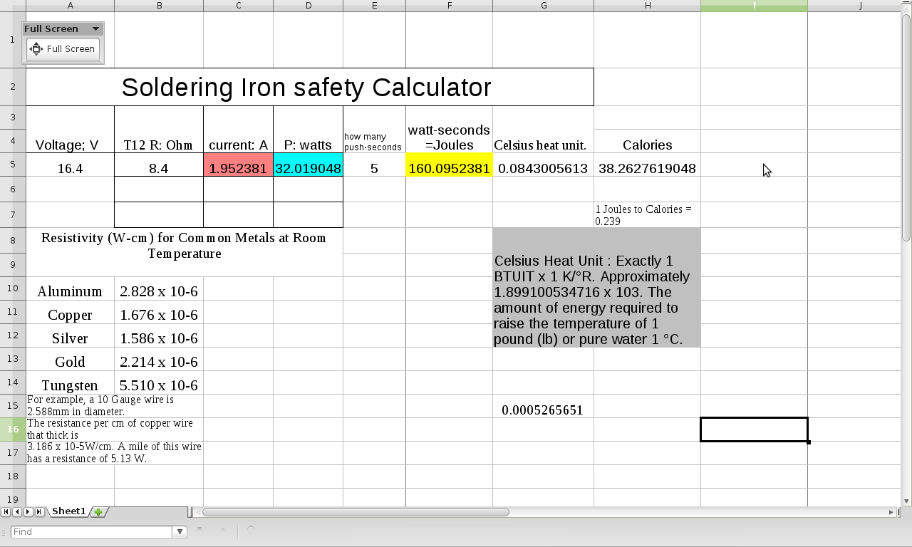

                      • capwizard
                        • Jun 2016
                        • 1991
                        Re: T12 battery portable iron

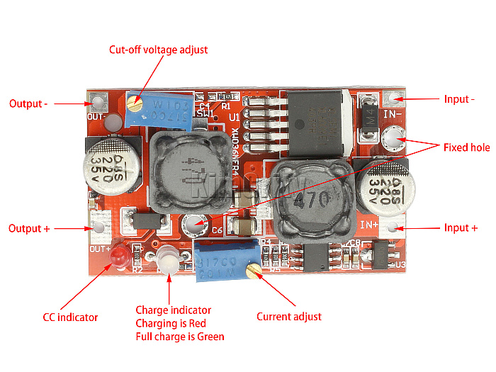

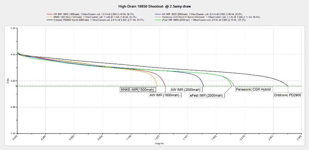

                        budm Thank you for safety issue and safety current calculations. Sorry, the dc module Ive used has on fire problem will change different one, with the one has current adj and voltage adj ....with adjustable current to fit with different type of batteries..... might be avid some safety issues......pic 1
                        High Drain Batteries for Sub-Ohm Vaping
                        http://ecigarettereviewed.com/best-h...hm-vaping-2015
                        Maximum current on non protected 18650's
                        http://www.candlepowerforums.com/vb/...tected-18650-s
                        2.1Ah 18650 cell can safely deliver 3A because its below "2 times Capacity" which is 4.2A
                        5 common lithium-ion battery myths explained
                        https://batterybro.com/blogs/18650-w...yths-explained
                        Panasonic NCR18650B 3400mah Amp Limit & 18650 Battery Datasheet
                        http://www.batteries18650.com/2015/0...0-battery.html

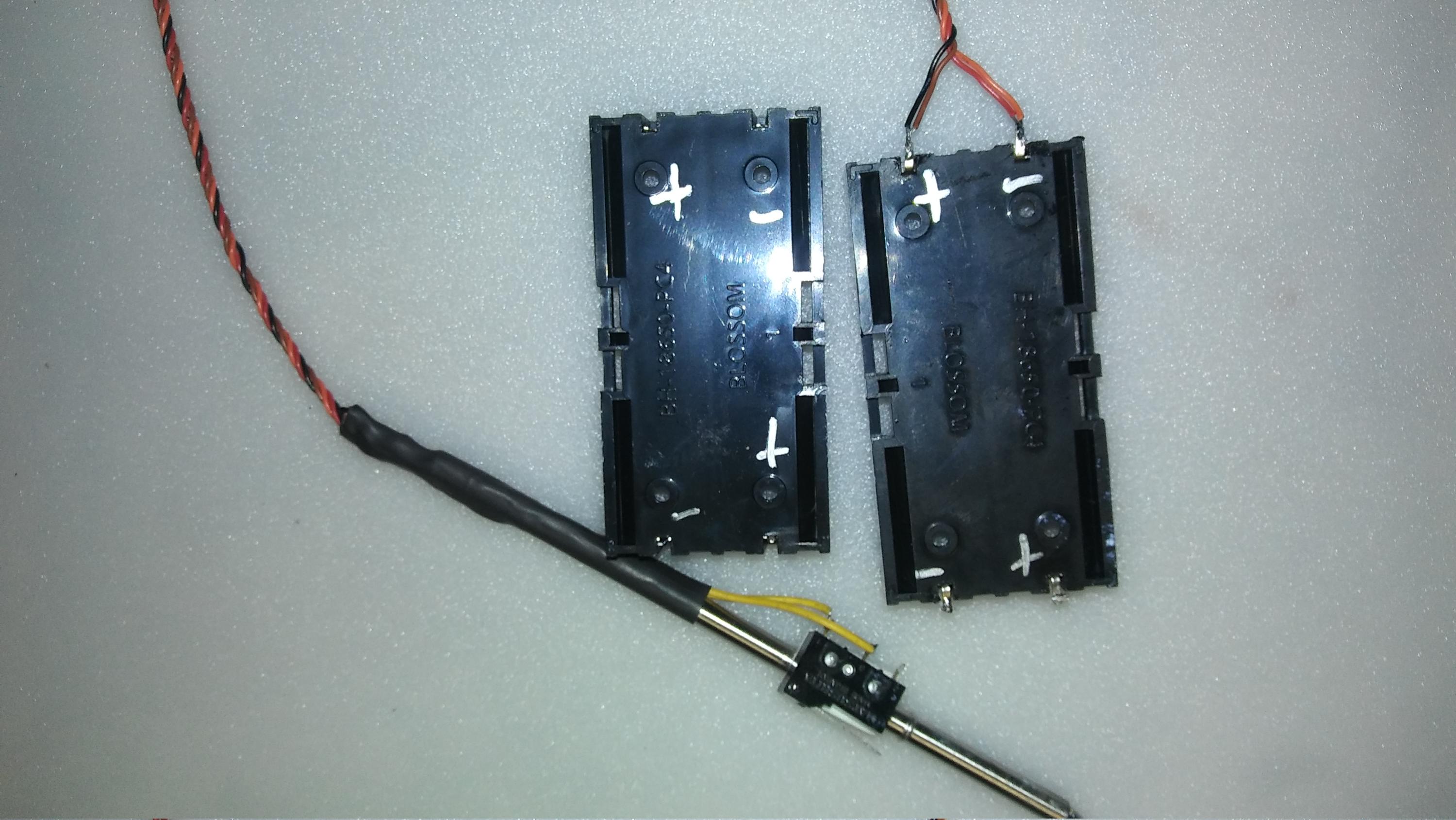

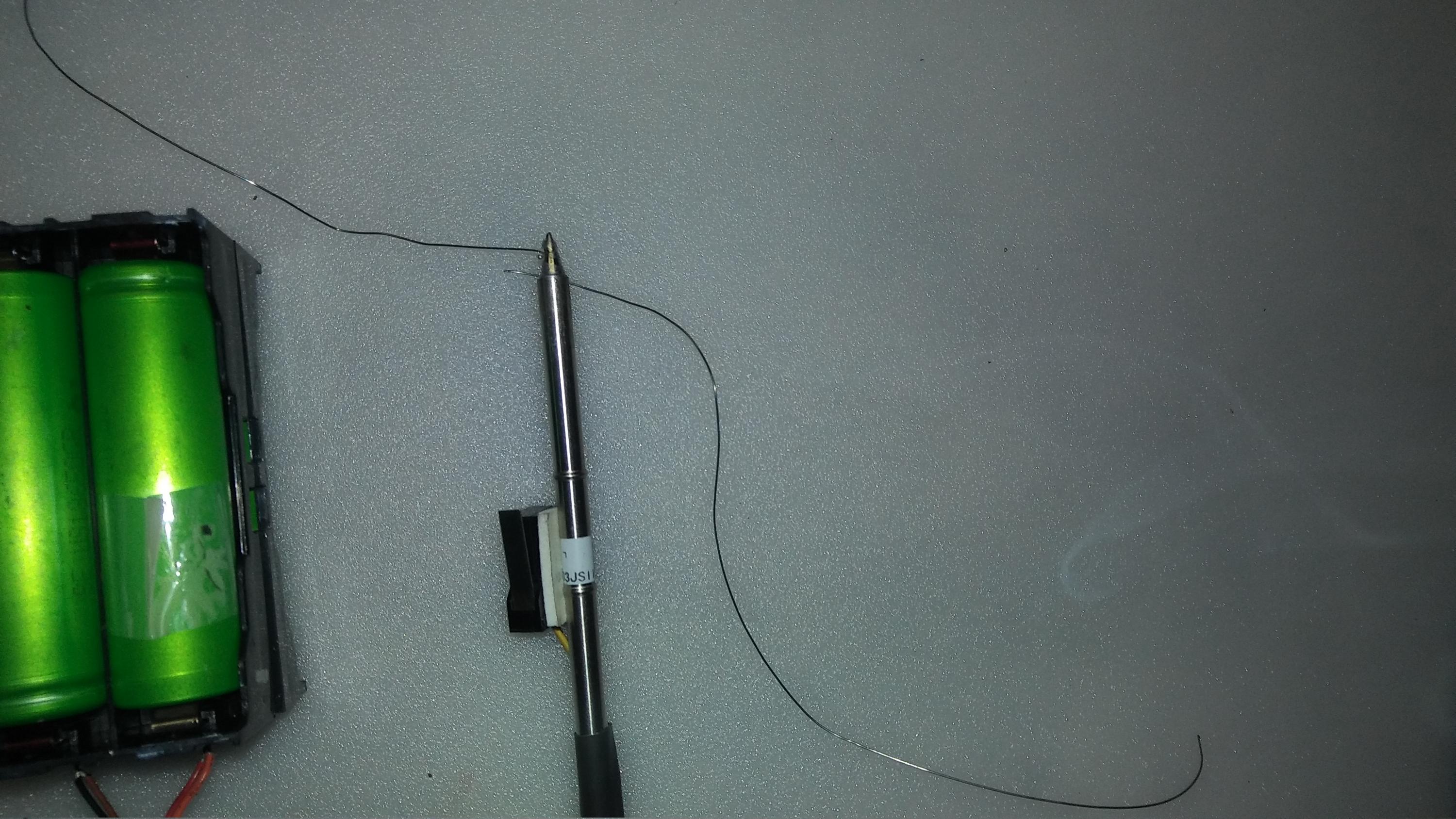

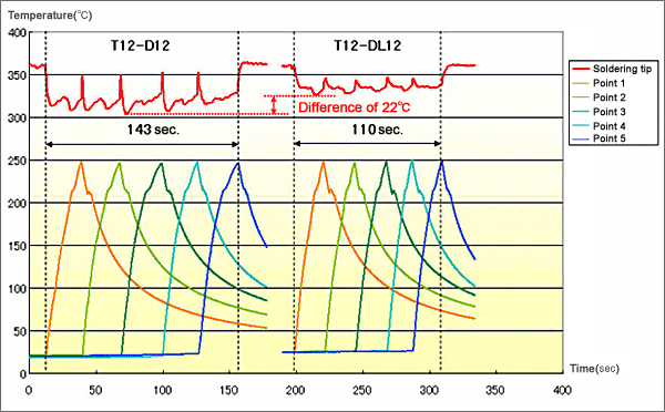

                          4 x 18650 works good!.........10 seconds to melt solder.......................
                          T12
                          http://www.hakko.com/english/product...x951_tips.html

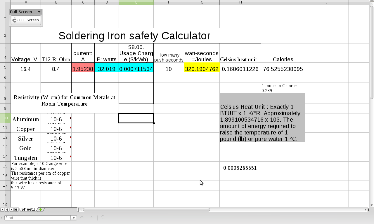

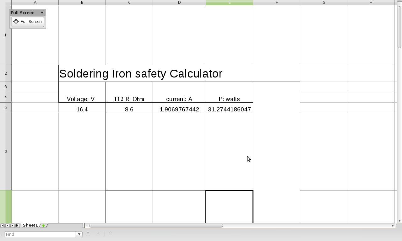

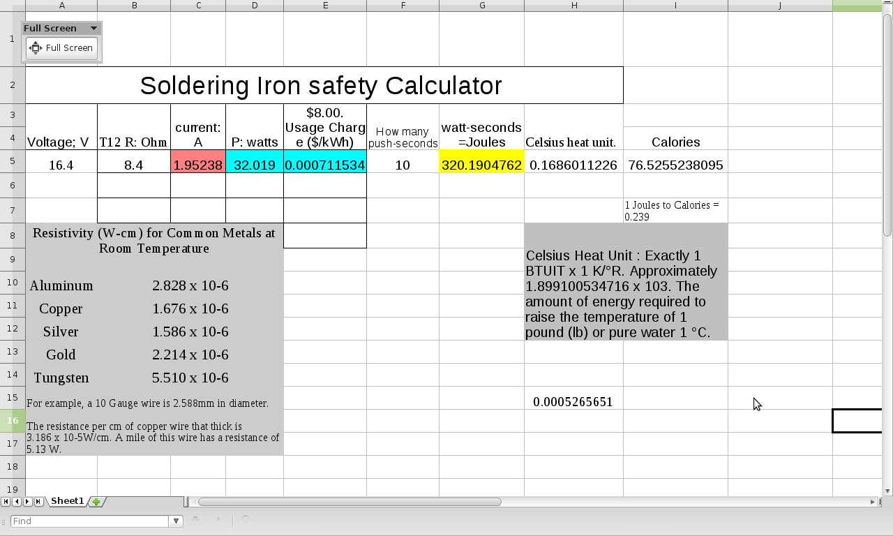

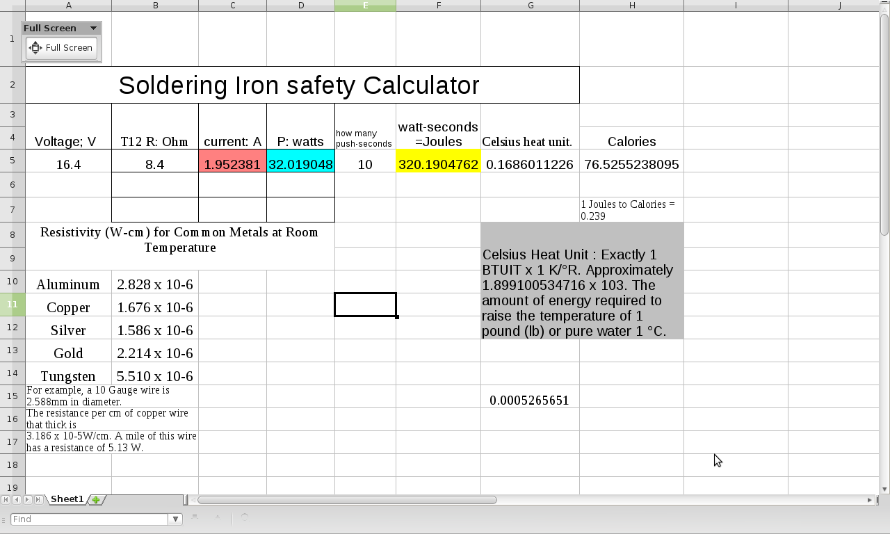

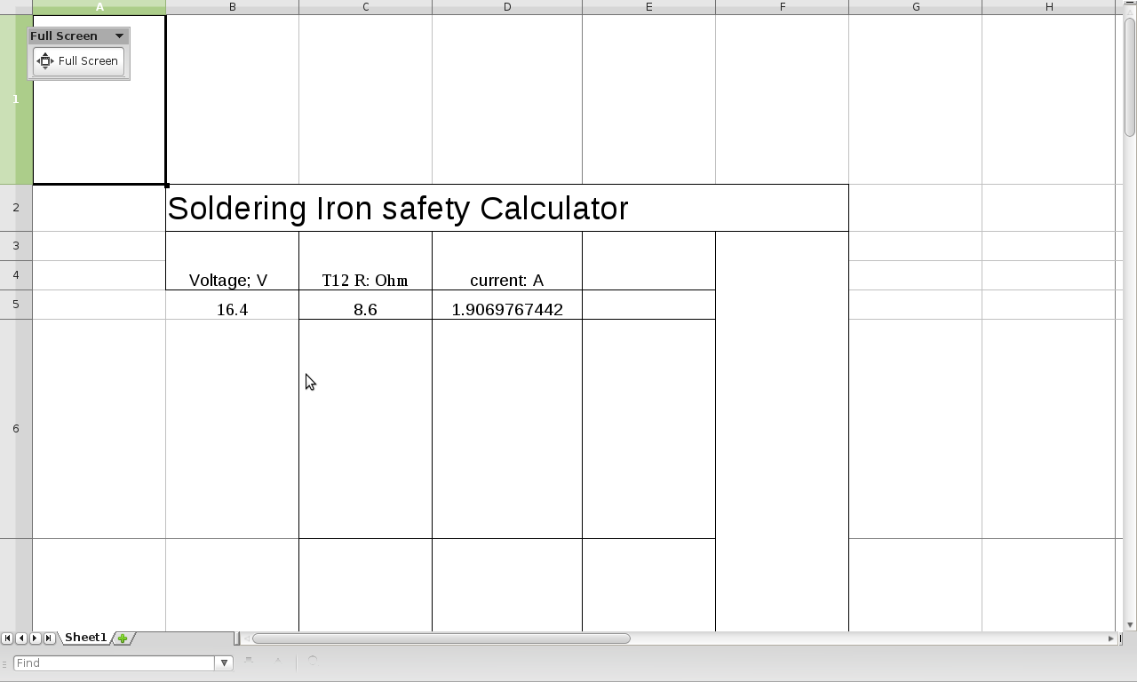

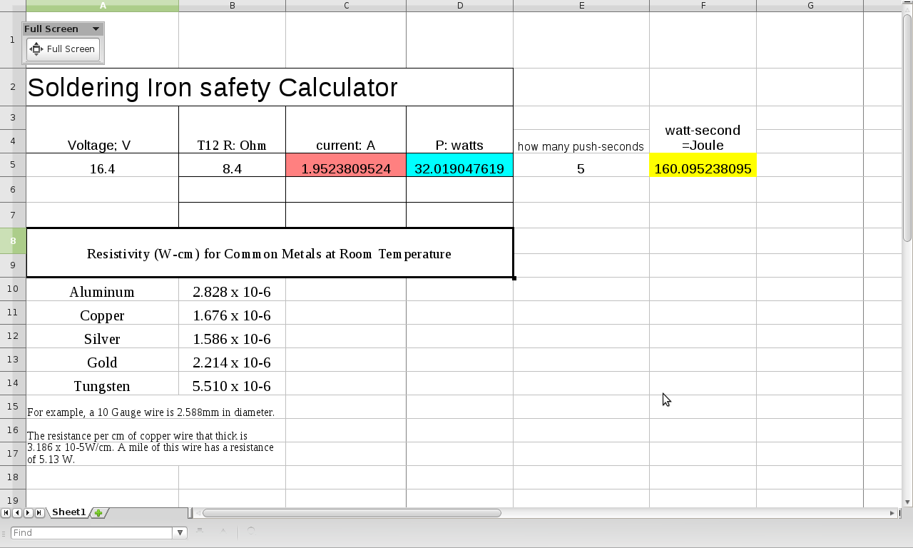

                            Better safety calculator.......Thank you .....budm........with Joules..........
                              Add Celsius heat unit, and Calories for fun.............
                              PS: KWh = $8 here, How much it will cost you, In this case is battery, so not 100% correct, it needs to count energy lost.
                              PS: How many Joules need to heat up iron tips to 280F?
