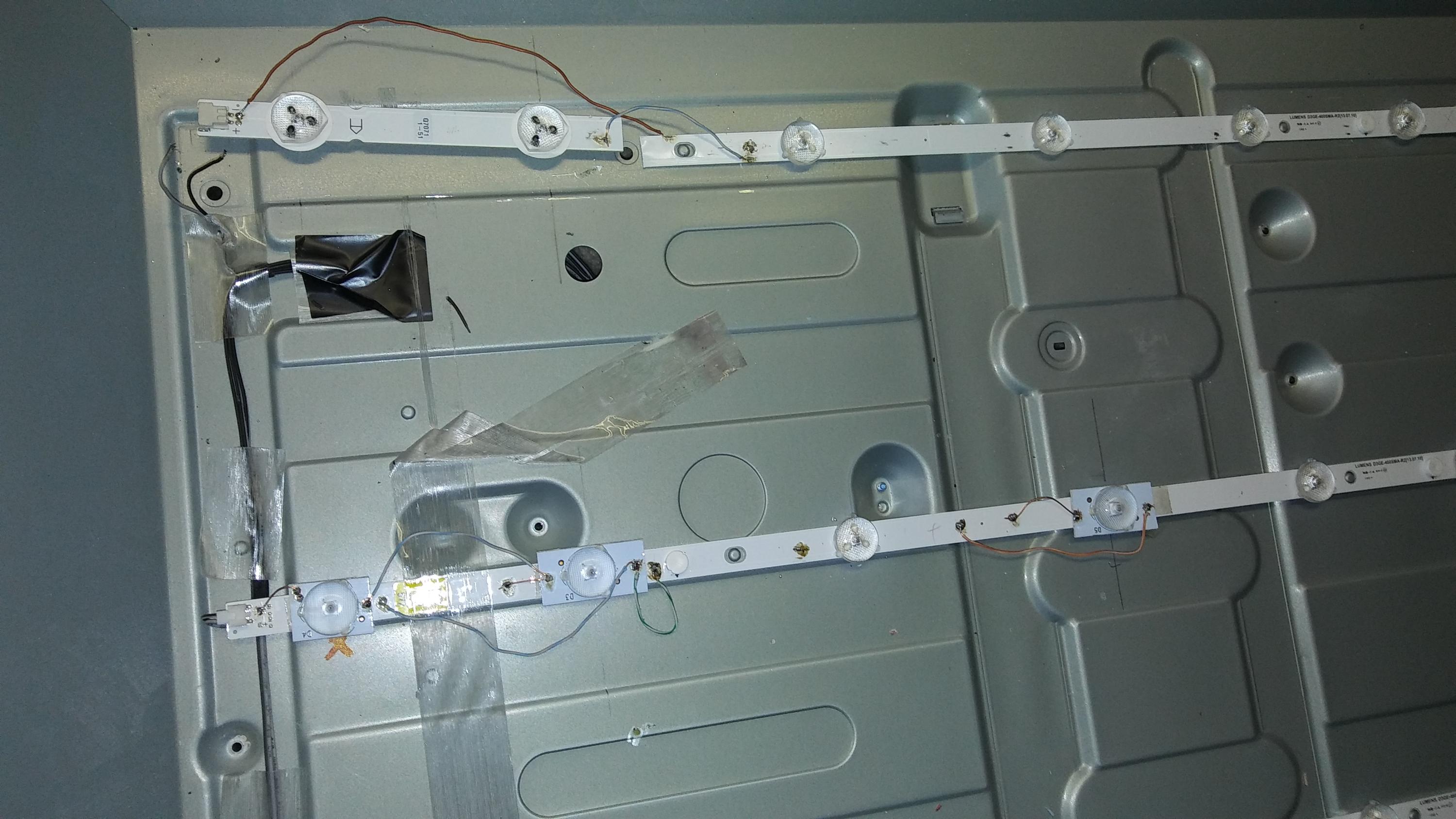

                PCB has white paint so I can't see the copper traces too good, LED polarity keep change also confused me.
                Fist I tested 10 LEDs no good, gave A low estimate, end up need to change all LED strips. I do have only need to change one or two LED and fix the tv, over here I mean the DOG.
                Now is third day still sit on my bench, but I work over here and there about 10 different items.

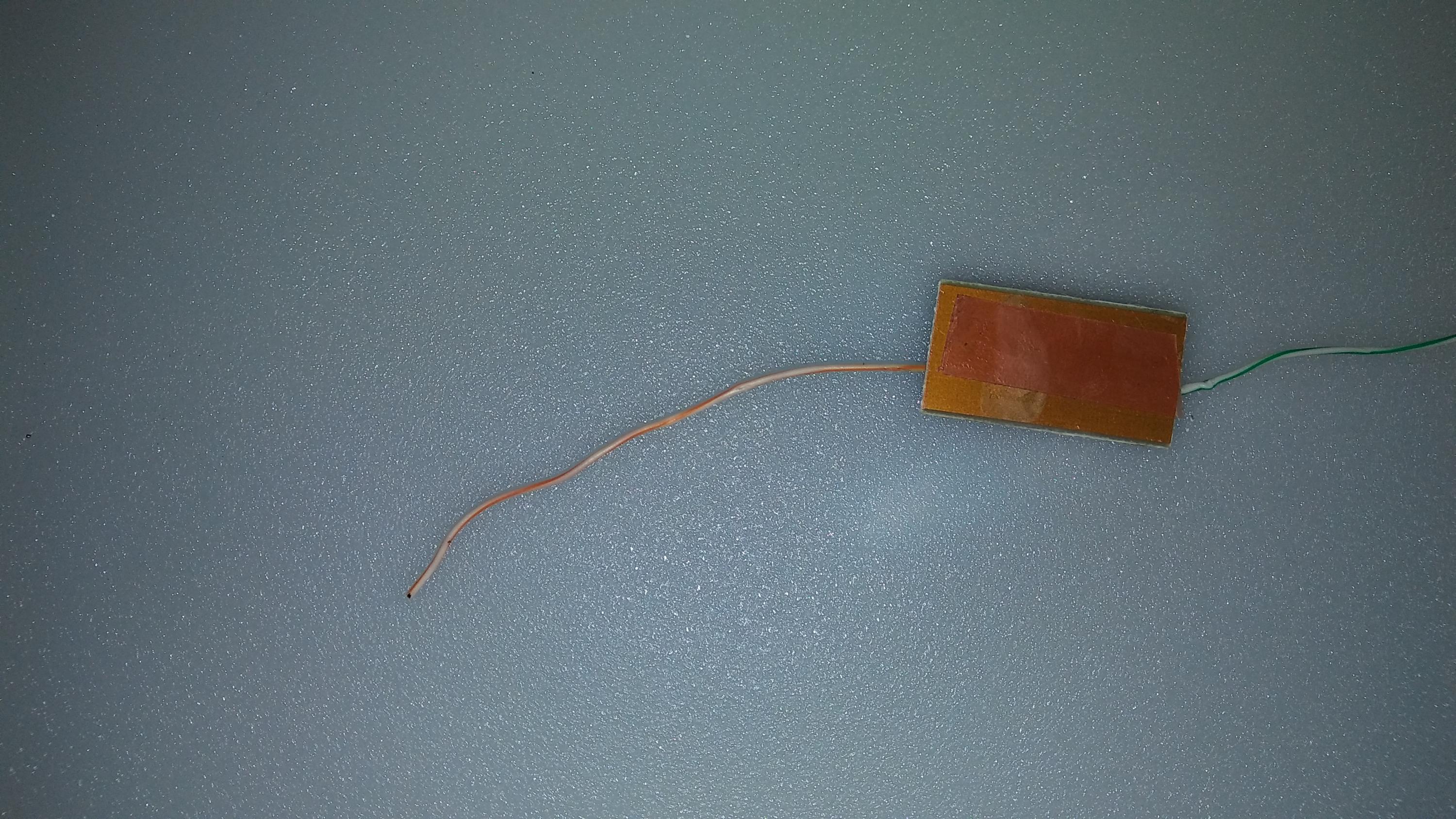

                      Re: changing Direct-Lit LEDs take too long.

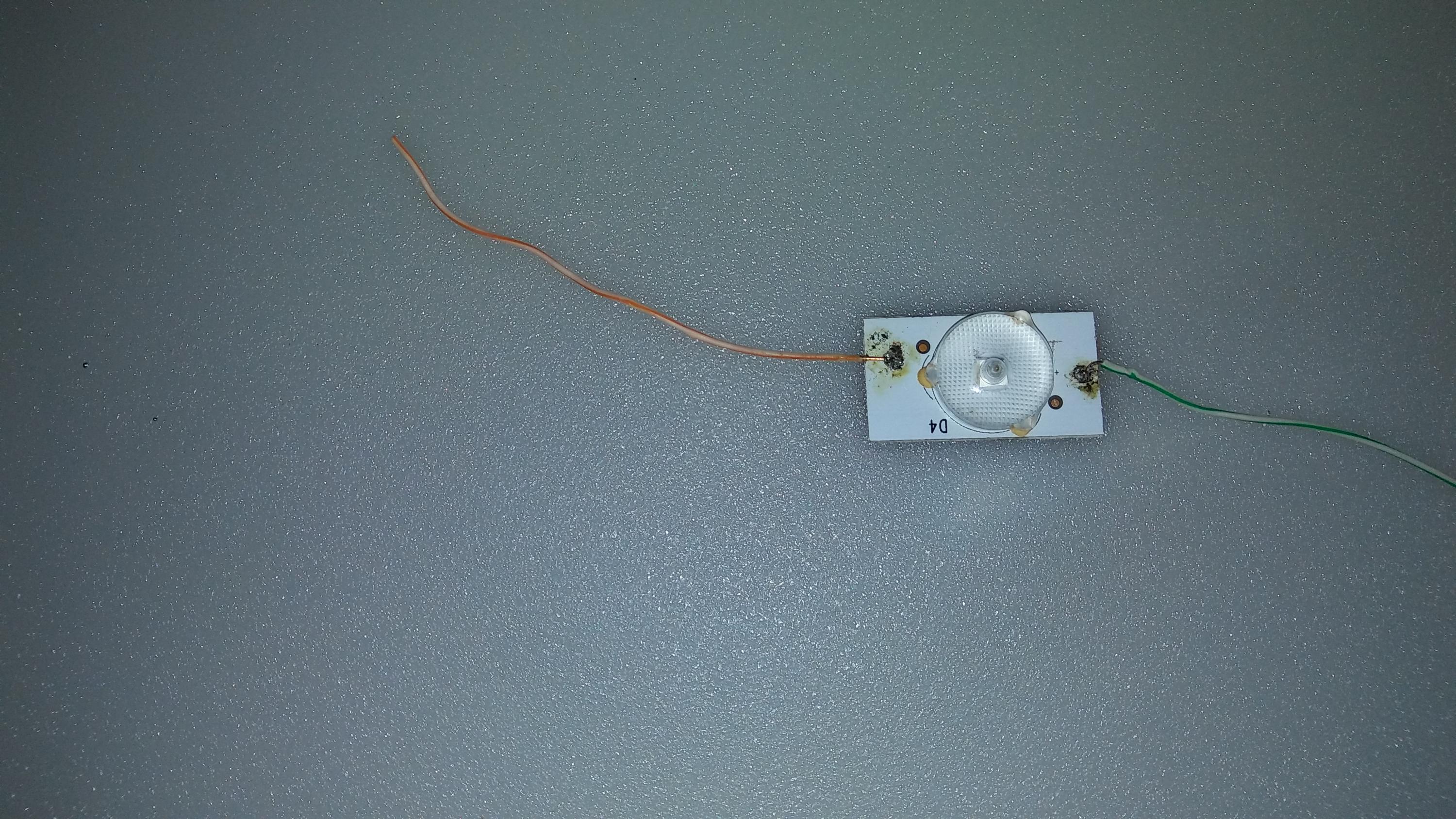

                      Premade the dLED universal modules when you need it will be faster. Does anybody have better idea?
                      PS: the back of LED module has 3M double tape preinstalled.

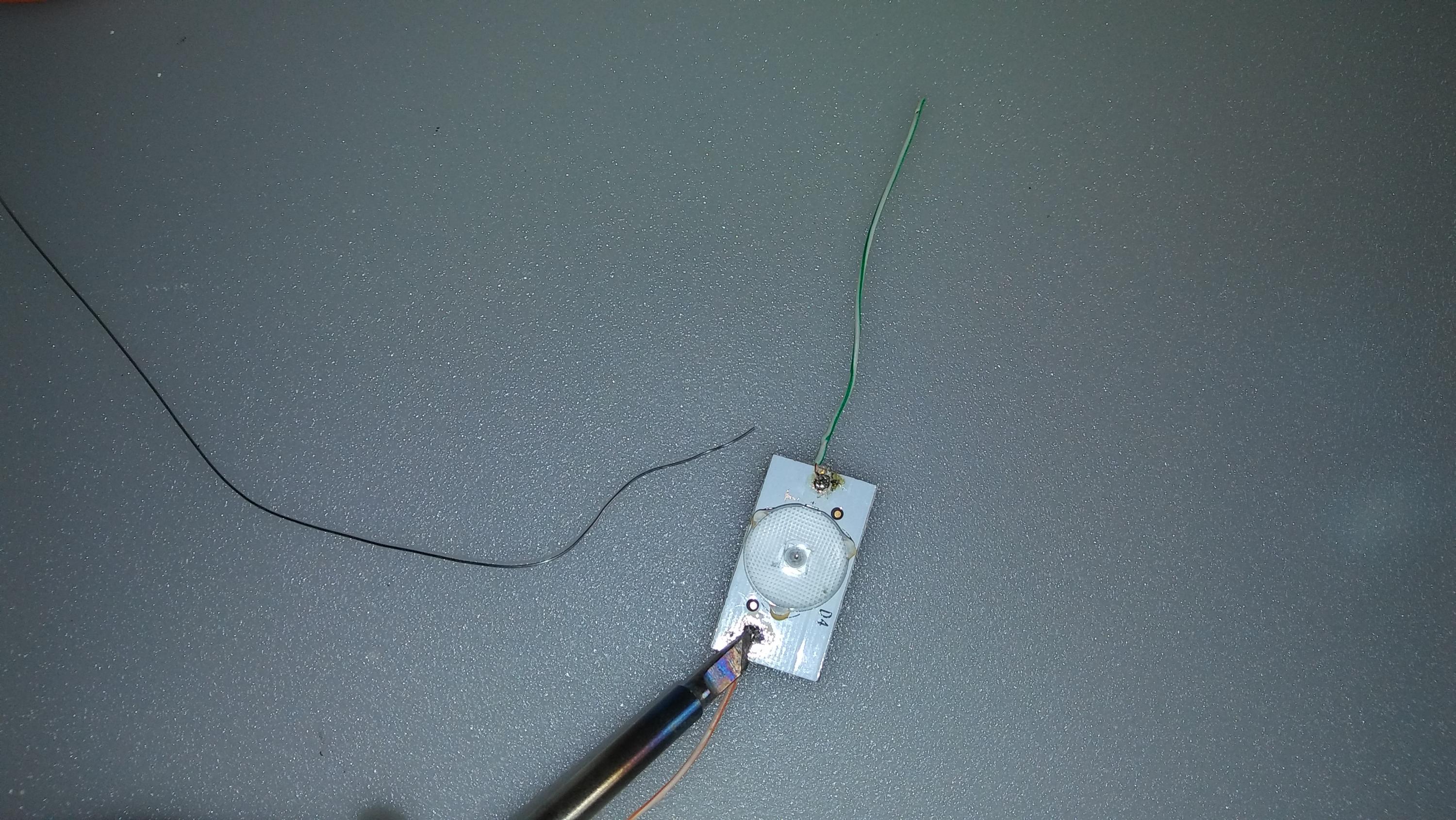

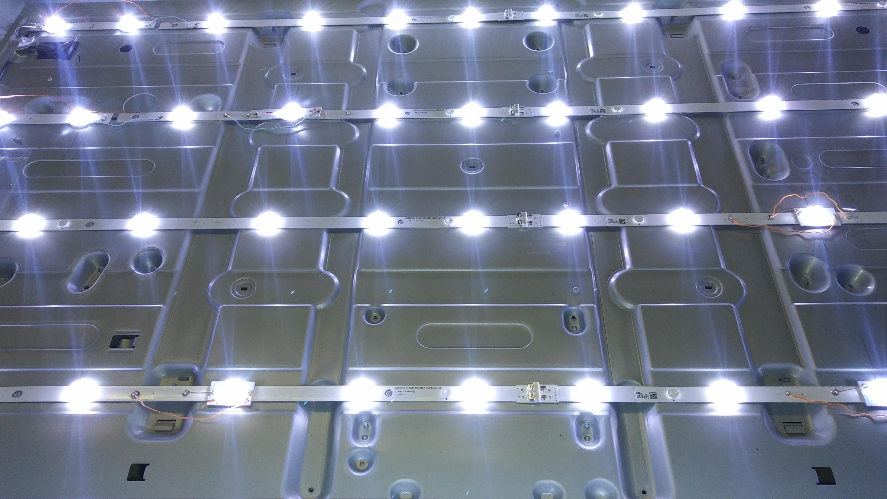

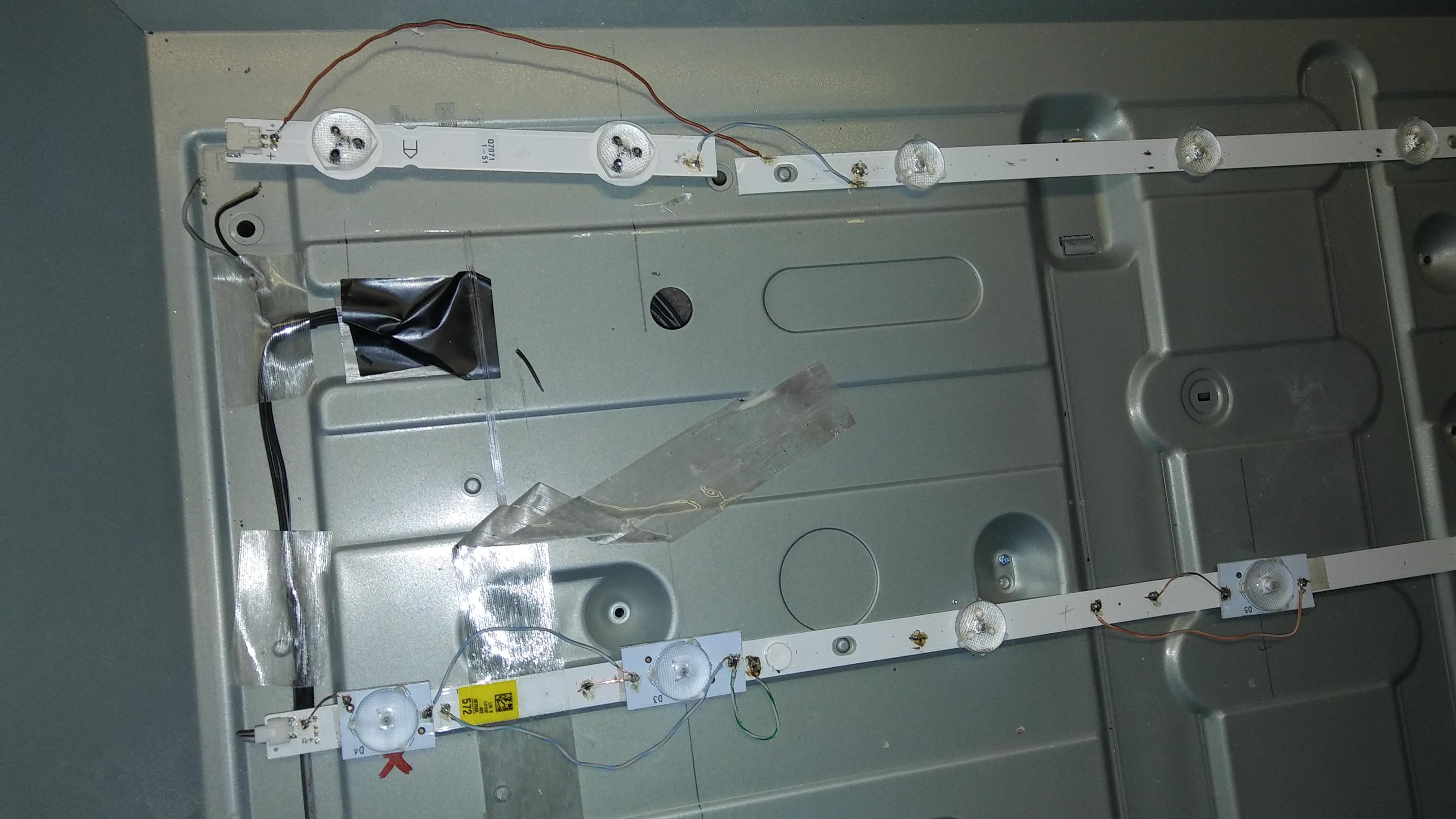

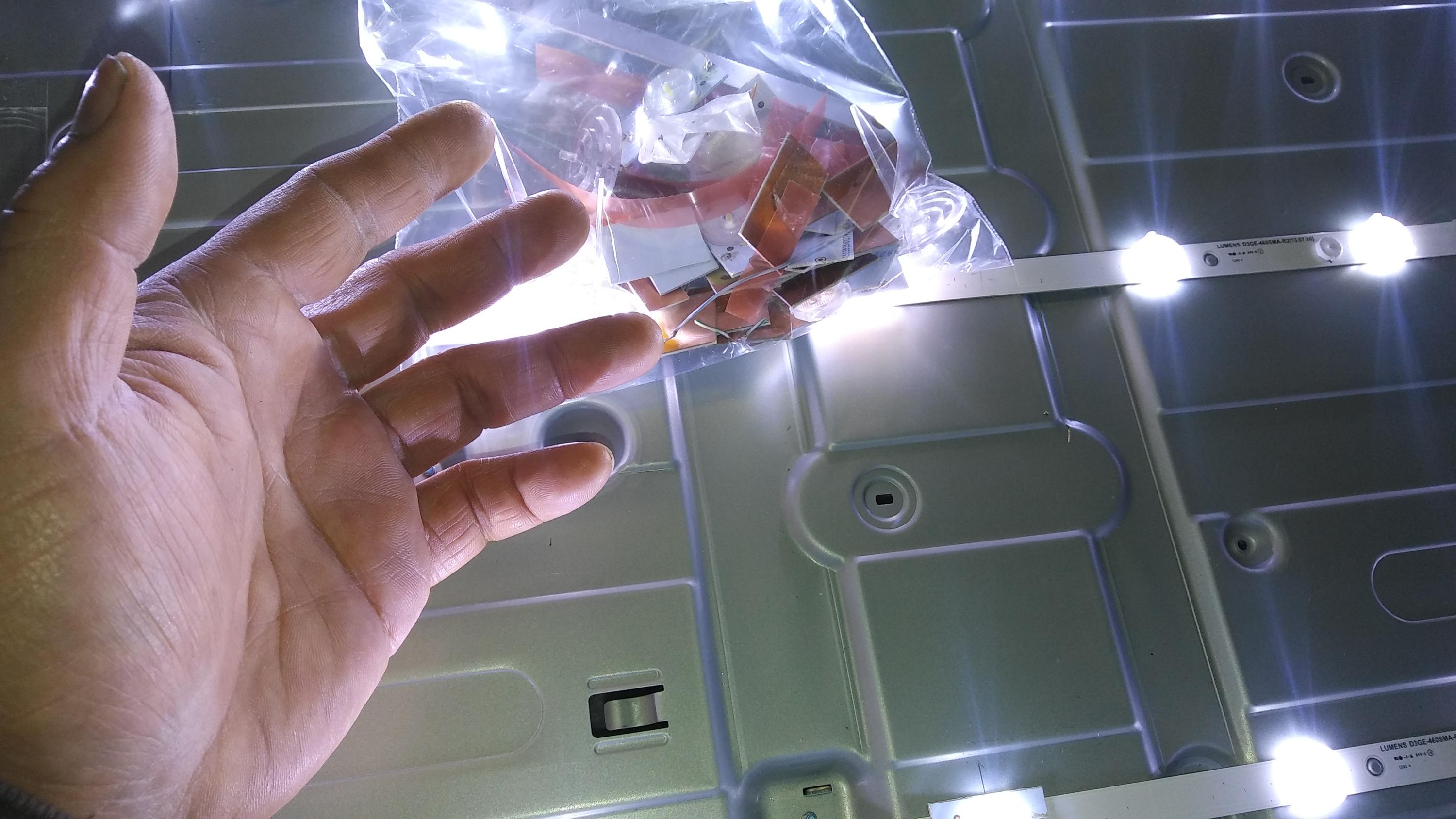

                        TV is working finally.......
                        Pic2 is the parts has been changed. TV is UN46FH6030FH
                        PS: You know what just right now, came in the similar one has the same problem UN46EH6300. Oh... my God!!!

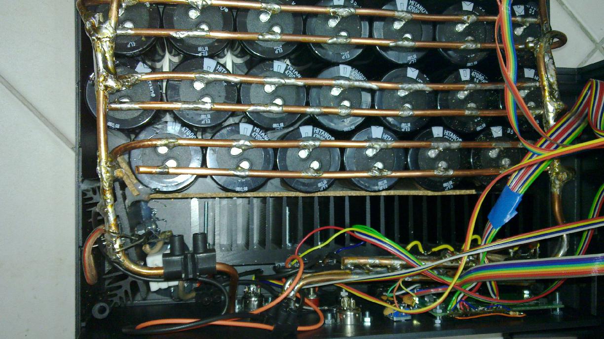

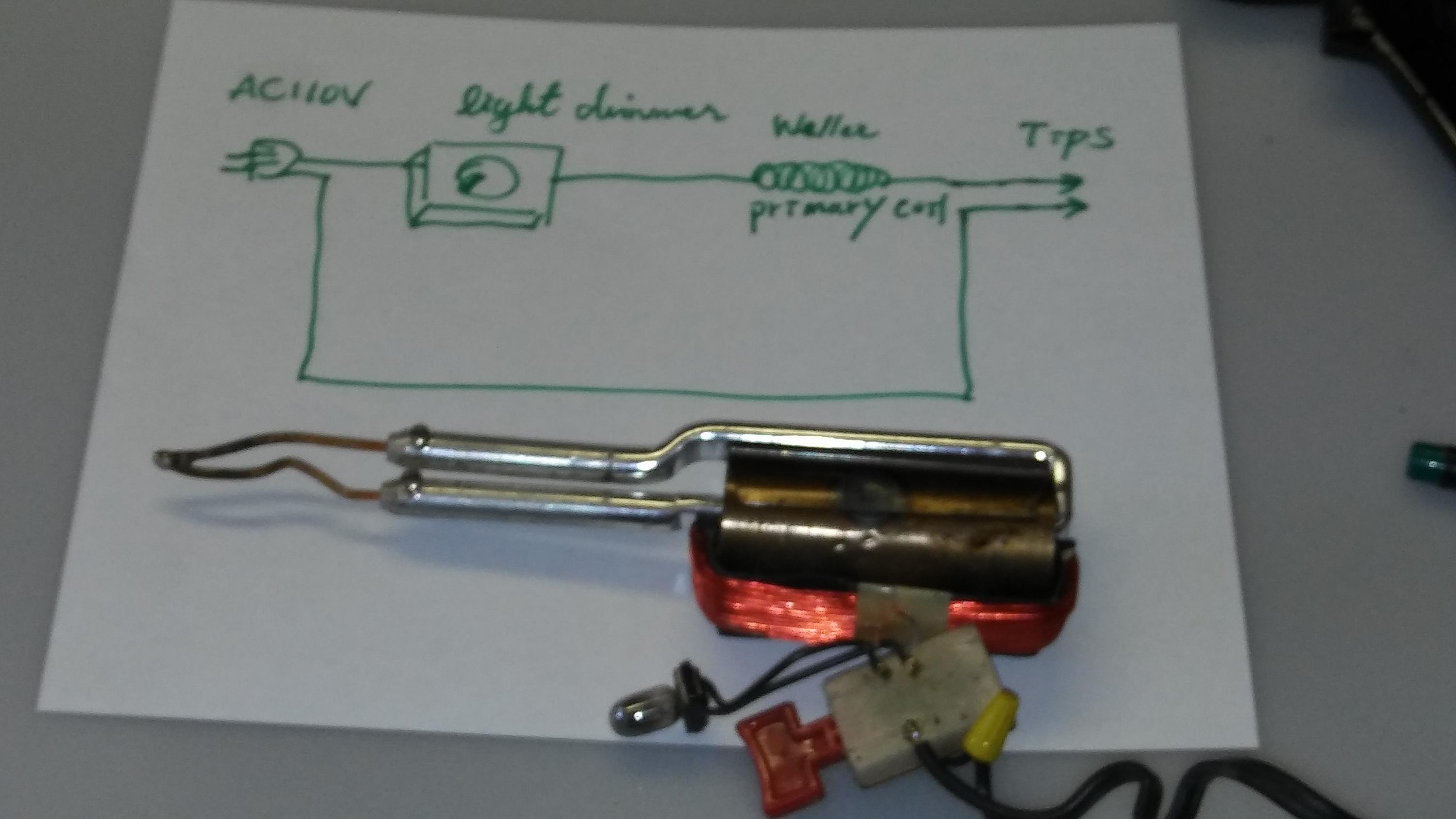

                          Can I use mini spot welder to save time of tedious wires jumping?
                            You could use a battery spot welder if you modified the amount of time or current to do the welding you would not need very much time or current
                            Or you could make one out of a microwave oven transformer and a time controller and a set of battery welding stud pins if you want to make one send pm message and I will try to help you make one it takes a little time to make one I made one but I have not made a case to house all the hardware
                            Here is what you would need
                            A modified microwave oven transformer or find broken microwave oven on the side of the road or dumper diving
                            A mil-second timer
                            A set of battery welding stud pins
                            And battery welding strapping very narrow very thin
                            All of these items can be bought on eBay

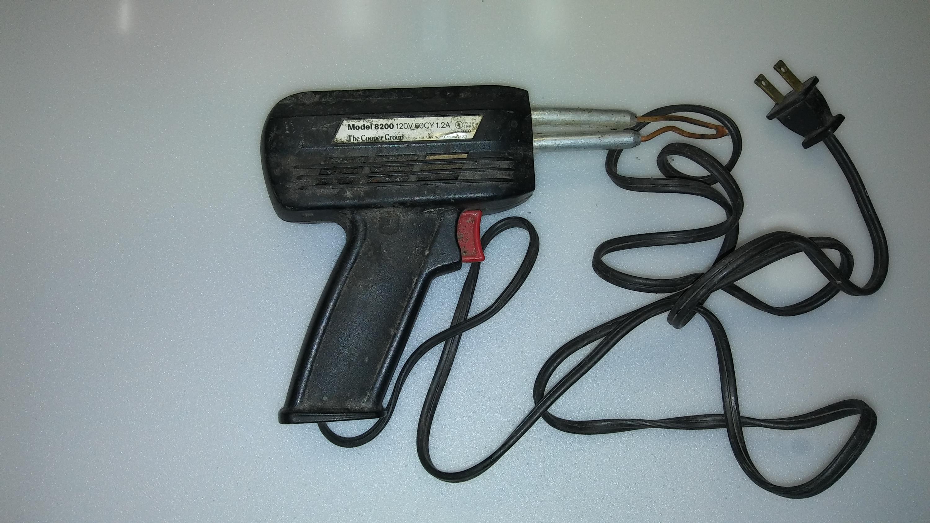

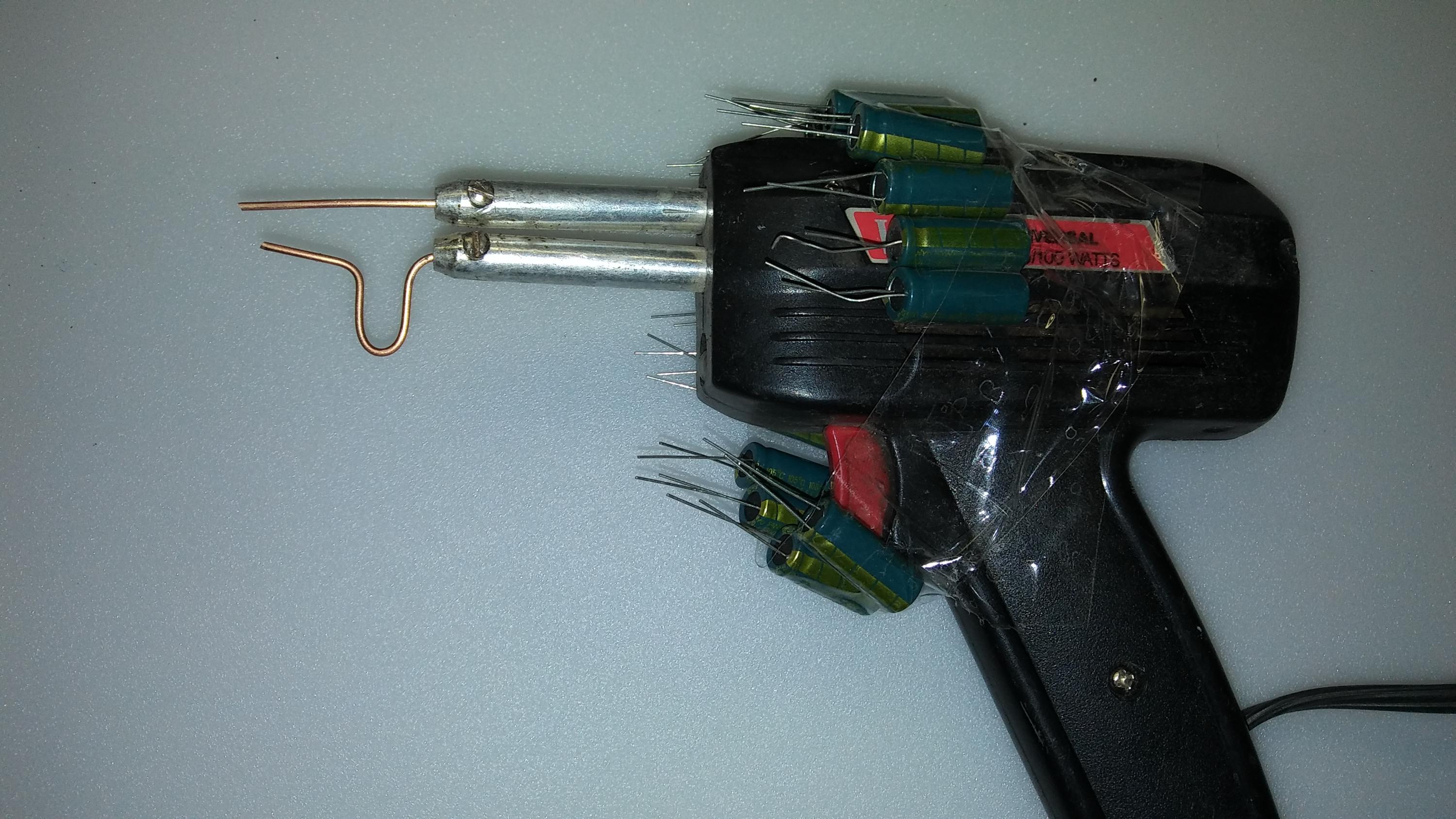

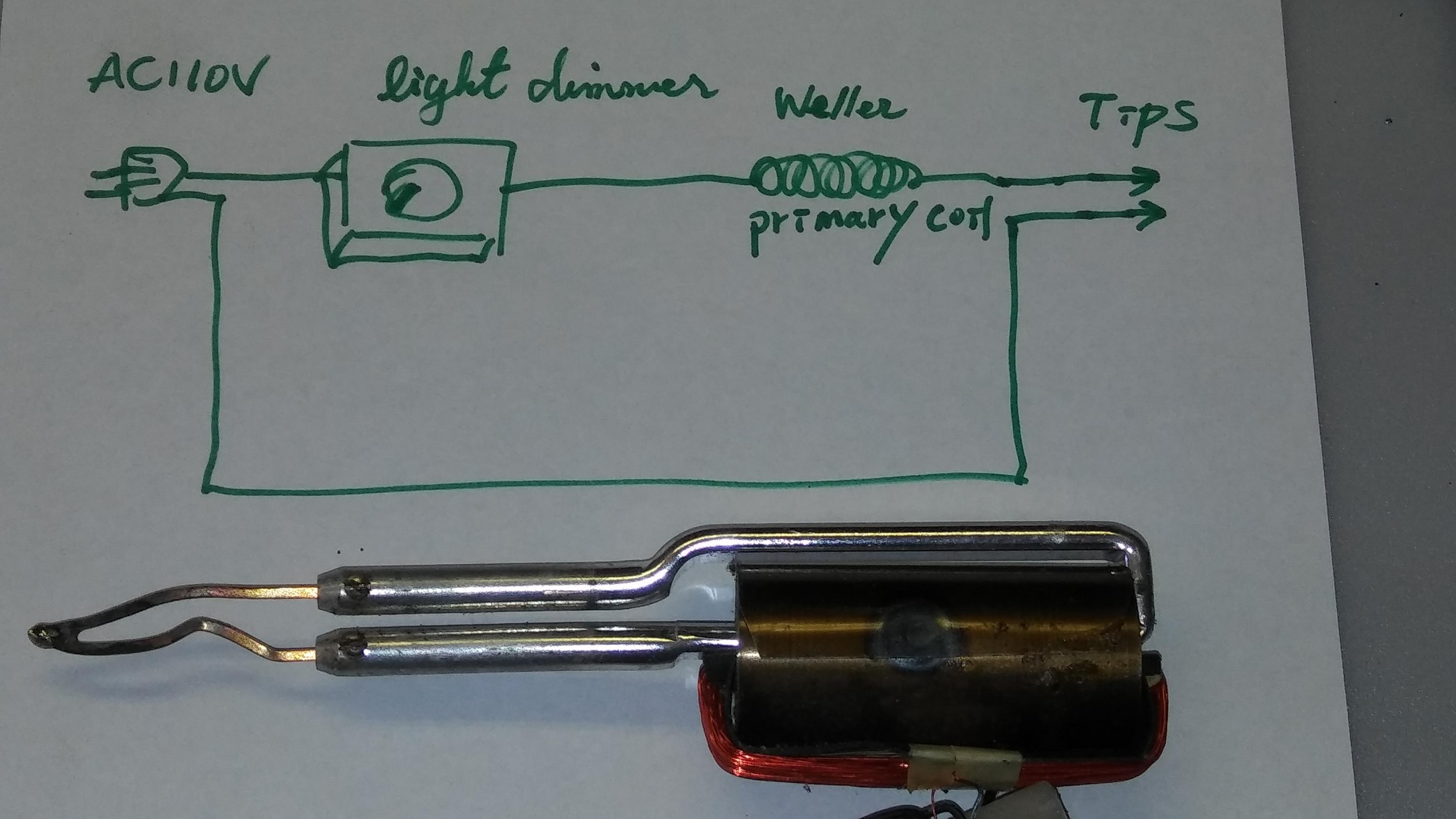

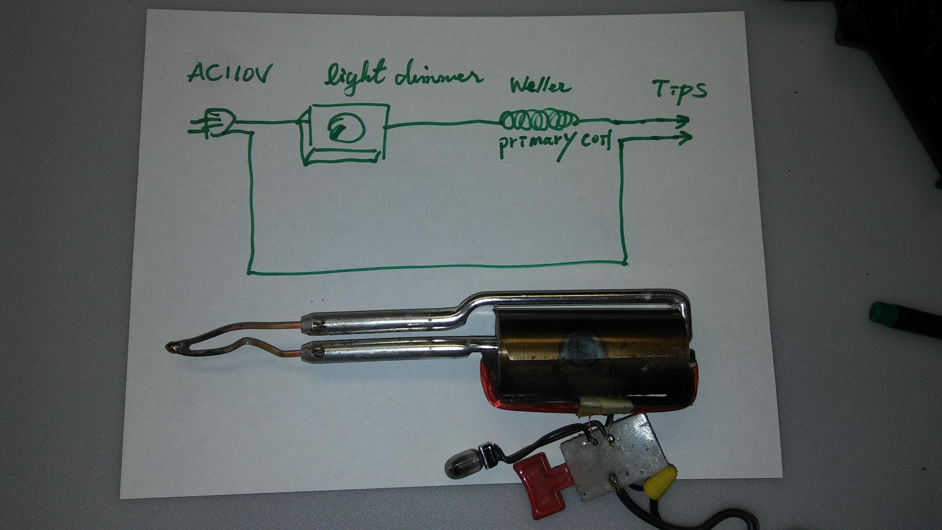

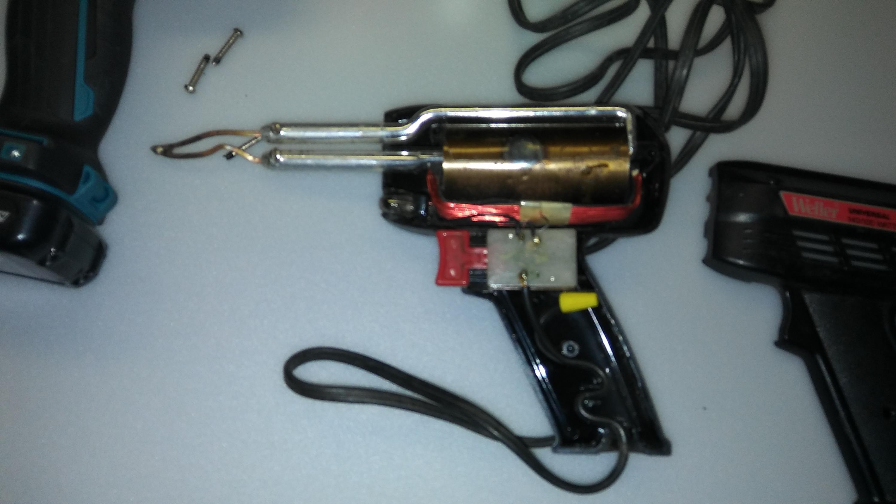

                              Thank you very much for your inspiration and Sorry for the holiday delayed response.

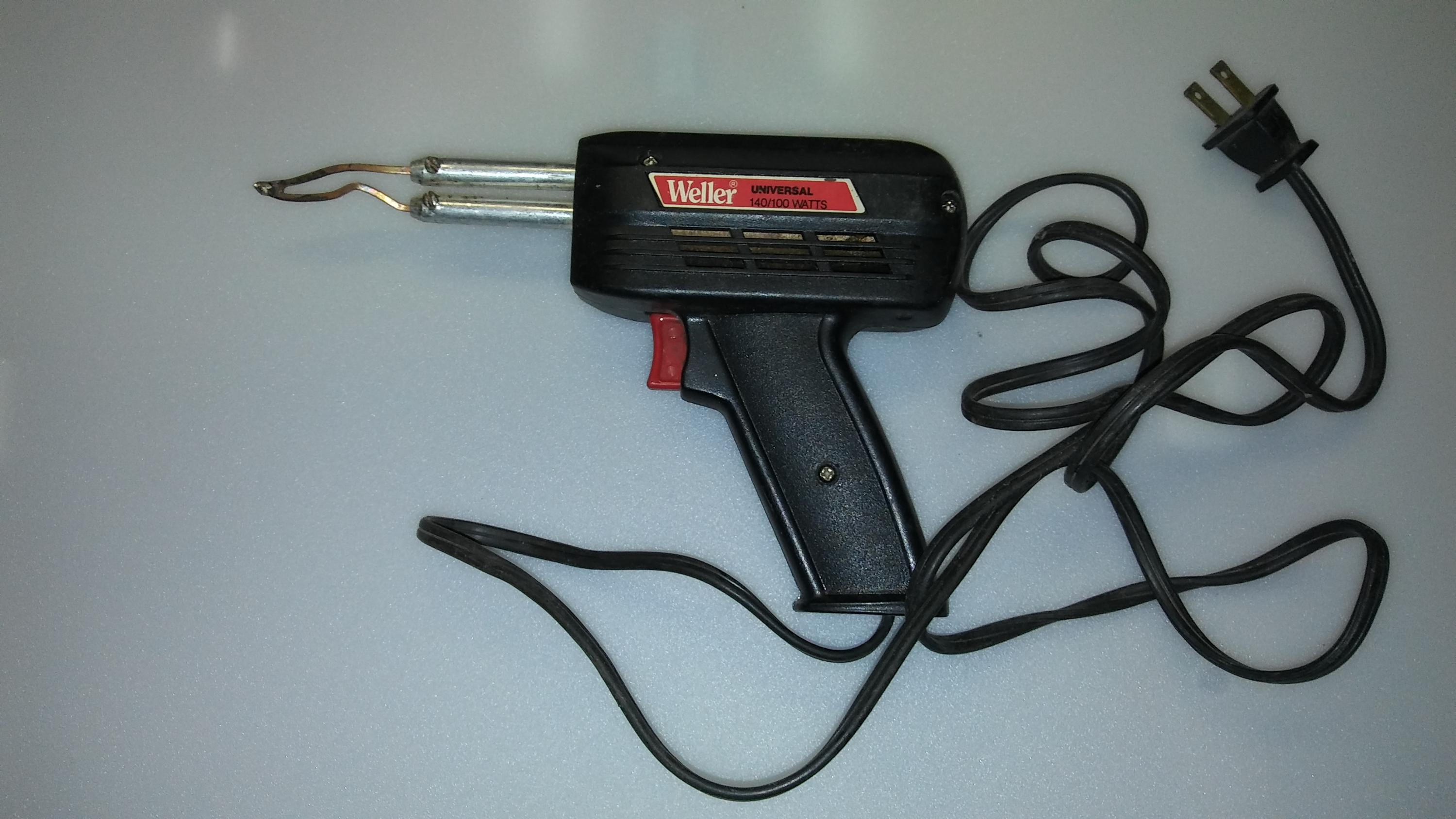

                              sam_sam_sam "A modified microwave oven transformer or find broken microwave oven on the side of the road or dumpster diving"
                              the problem is that too heavy for my project. So... my idea is hand hold device, use Weller solder gun (only has AC 1.2 v output),diode and caps(3300/16v), I called this " suicide bomber"(pic 5)........Can anyone help with this project? How many caps and Watt-seconds will be need? .....................

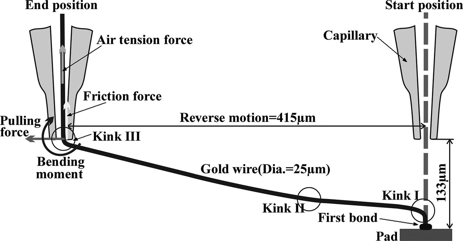

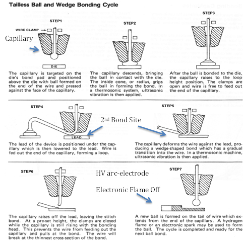

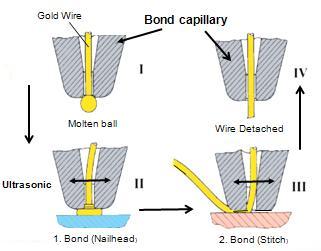

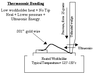

                              My homework:
                              New Large wire bonder SHB-150R
                              https://www.youtube.com/watch?v=TPZKHrGiAsM
                              IC Wire bond looping process
                              https://www.youtube.com/watch?v=Mi9_ll_Z8mk
                              Ball, Wedge and Ribbon bonding
                              https://www.youtube.com/watch?v=fazeH4PHvpk
                              Wedge Bonder Training Video
                              https://www.youtube.com/watch?v=quA4INmeSbo
                              Copper bonding
                              https://www.youtube.com/watch?v=cCHXIYnYMTc

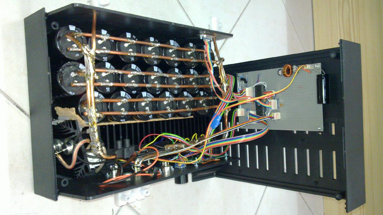

                                http://ultrakeet.com.au/write-ups/cdWelder

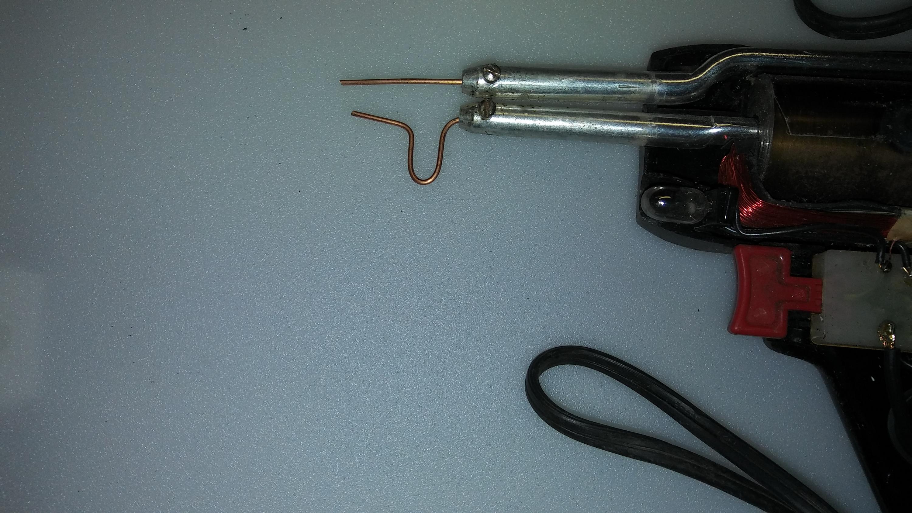

                                  Thank you, I need A simple one and this one you gonna need gloves too...
                                  PS: the Weller transformer act as A current limiter.

                                      It is going to be trial and error
                                      The first thing to do is the soldiering gun with out any caps at all then see what you get also take voltage reading so you what voltage caps you need I would start with .5 fards capacitors and see what results you get if it does not weld hot enough then jump to a one fard capacitor until you get the the results you are looking for

                                        I going to be trial and error
                                        Also once you get the right results then you need a mil-second timer or use a SCR driver controller to give you fine adjustment control of your welder to weld
