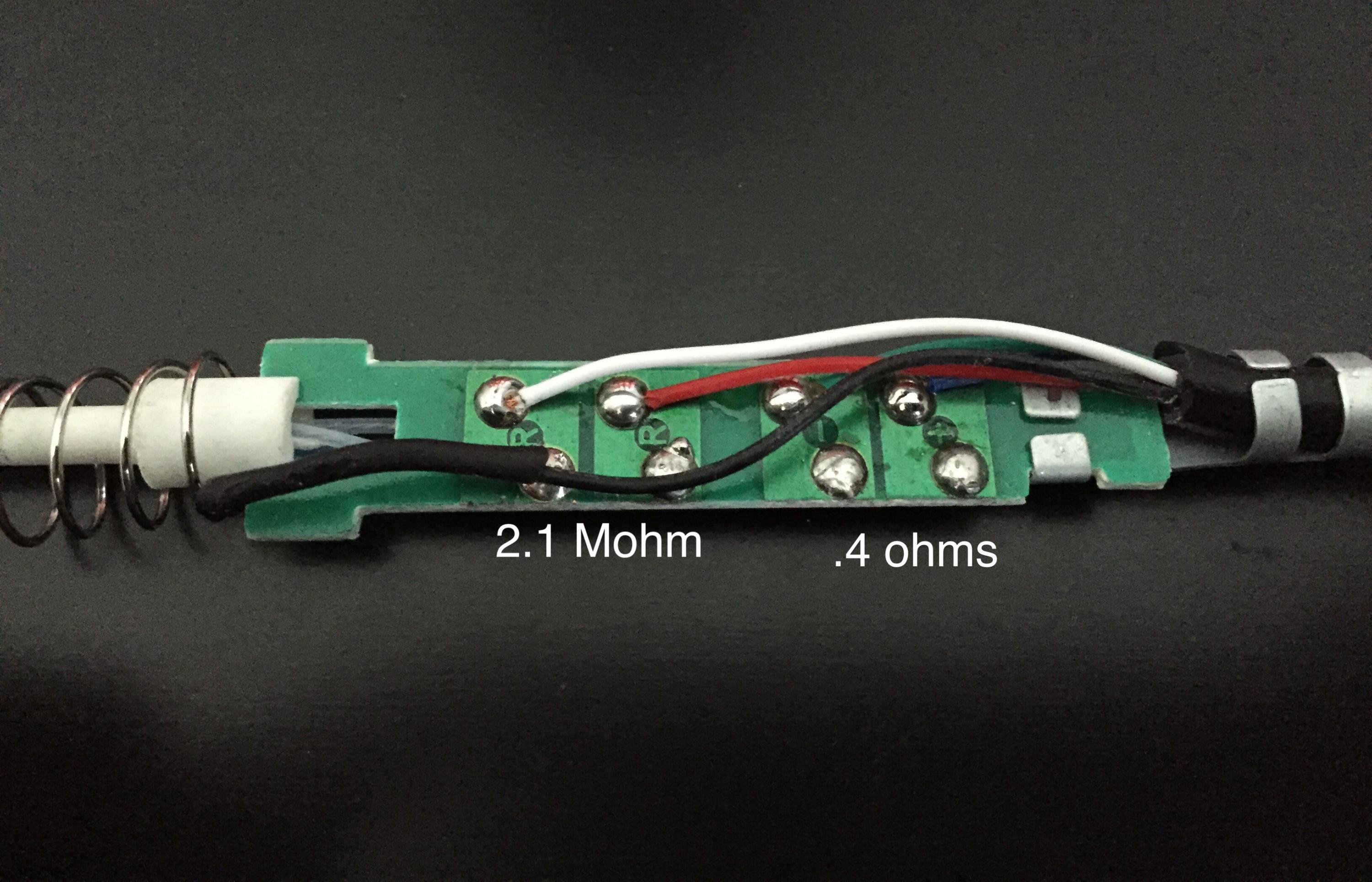

    I have a Chinese knock off soldering iron that I've been using for three years.
    Suddenly the soldering iron stopped getting hot. The digital read out increases with knob turning but it always displays 006c
    It's an 852d+ station. Couldn't find anything online for testing heating element so I did an ohm test across what I believe to be the sensor and input lines.

    heat the tip with alighter or something and see if the readout changes.
    chances are, the cable is bad - because your meter readings look like it's probably o.k.
      Re: Is my soldering iron heating element bad?
      I applied some current to the + and - terminals. The ceramic got hot and the reading on the other terminals changed.
      I hope it's the wiring and not something inside the system
        Did you really measure 2.1MEGohm across the temperature sensor? or milliohms?
        I would suspect an bad temp sensor if it's that high and display is saying 6°C for a temperature?

          It was Megohms

              It was the heating element. Installed a replacement.
