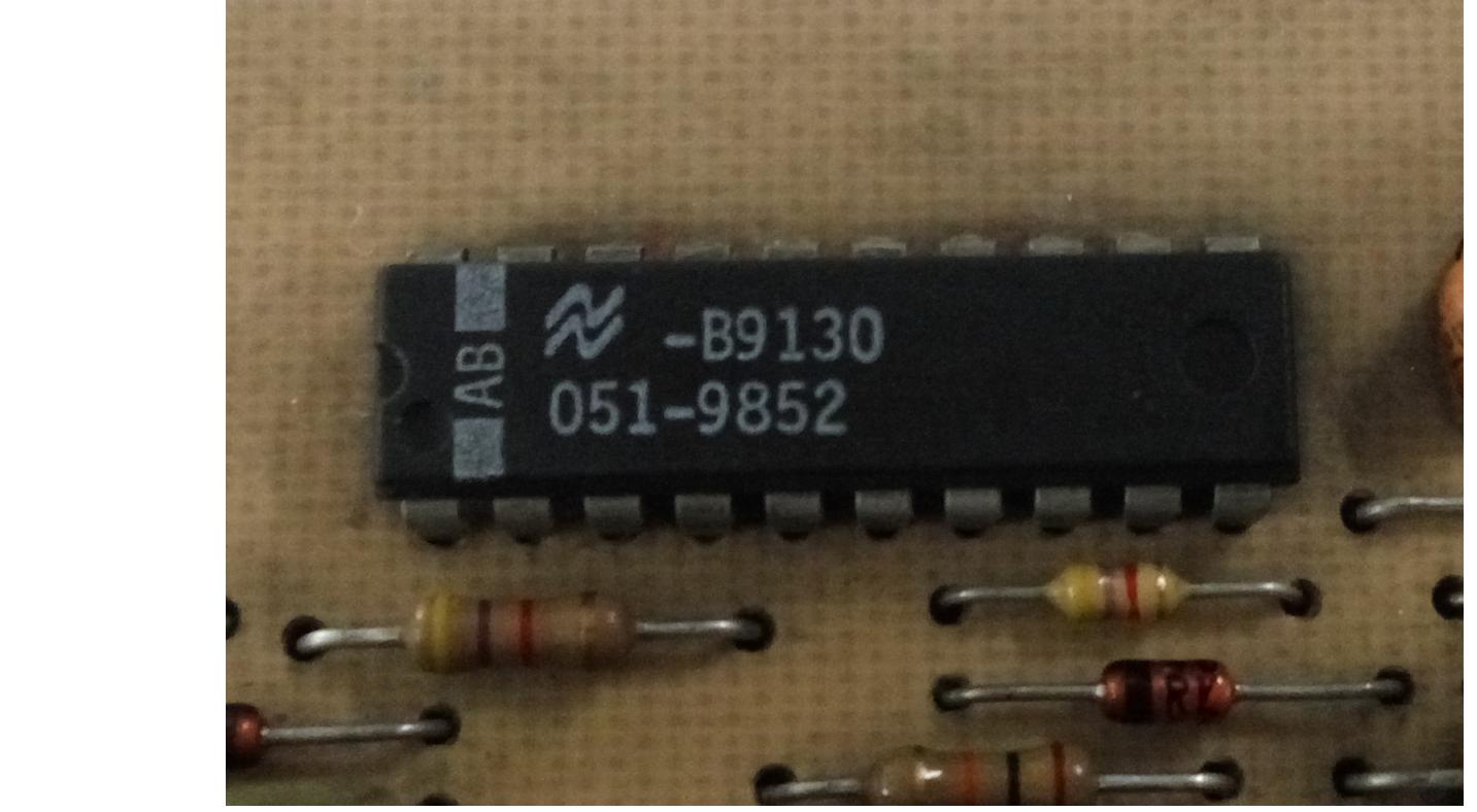

    Please help to find what is the replacment IC for this old National i have attached at photo.
    051-9852
    This is for the pcb of my stanley garage opener
    Any help will be appreciated

      Re: Old National IC ???
      You're not going to like my answer, but I think it's correct. It looks like Stanley special-ordered a batch of some standard IC from National, marked with Stanley's own part number rather than National's number. One purpose would be to hinder "reverse-engineering" by a competitor. Another might be to encourage/force users to get repairs done by an authorized Stanley service center.
      So a Stanley service center might be reluctant to tell you what the part really is (if they even know). Another potential problem is that the datecode on the part appears to be "9130", which means the part is 25 years old. It may be obsolete and difficult to find.
          it's probably a decoder possibly with a rolling code.
          or it could be a COP series microcontroller.
          seeing the rest of the circuit would help.
            It could be from the old MM53200 family, circa 1982.
            I would recommend ditching it or replacing it just for security reasons.
            I had an old Stanley garage door opener and it has no rolling code and a copycat attack works quite well.
            You can tune the TX trimmer capacitor if the remote has poor range or is flaky.
              Thanks alot all of you are helping alot
              It is a stanley coded part from national...
              Near this ic is the lm339 ic. It warmed alot and the voltage at vcc pin was 2volt.
              Replaced the lm78l82 and voltage is 8.2 V. Also replaced the lm339 IC but the pcb is not functional...
              Suppose that this 051-9852 ic is off and if replace it will do the job.

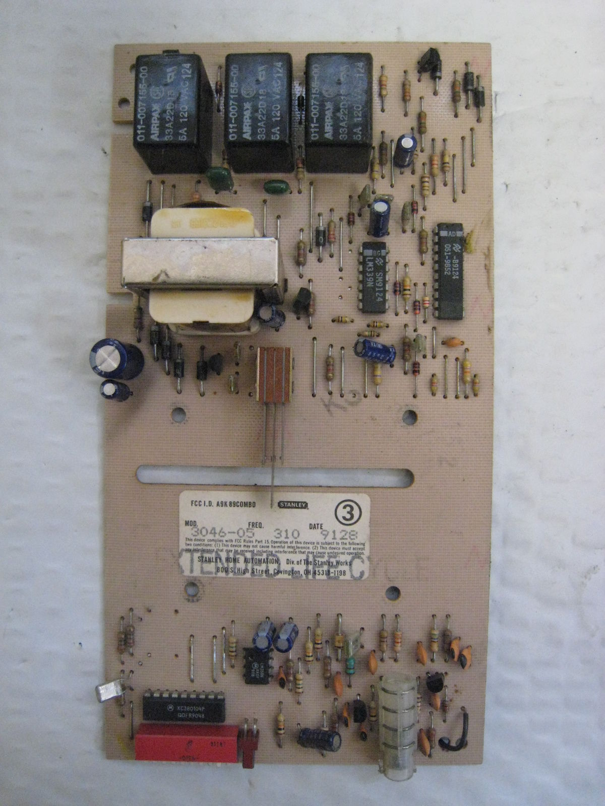

              will upload some pics

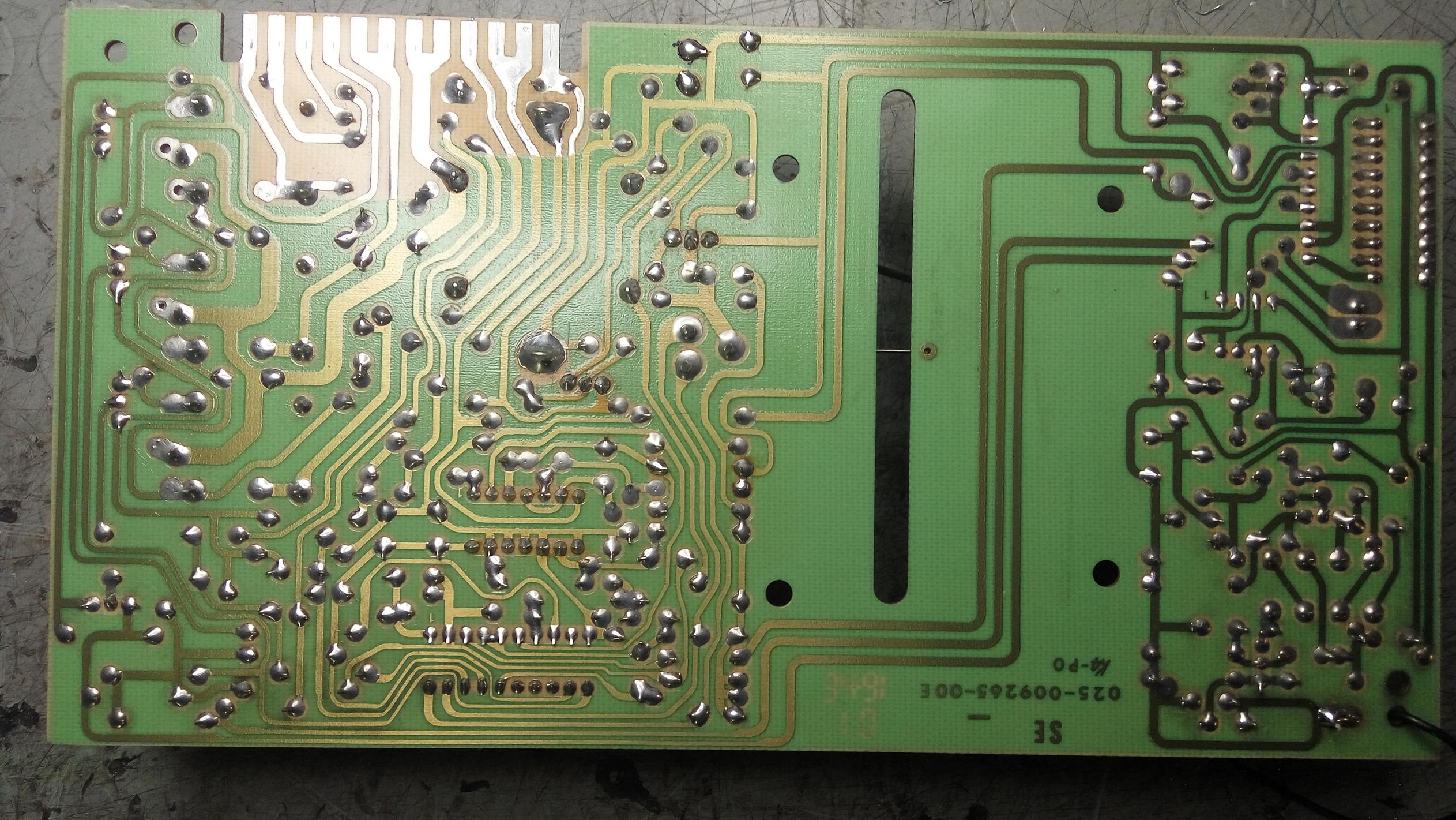

                And the pics fromthe old garage opener...

                  Here's a datasheet for a National MM53200 garage door chip, also 18 pins:
                  Notice the same chip is used for the remote and the receiver. My parents had a Stanley opener that had identical National chips in the remote and receiver, but I don't know if they were the MM53200 because 10-position DIP switches were used to set the code -- 2 positions unused? Later versions of the remotes had a slightly different circuit board, and the chip wasn't National but SEMIFAB.
                  Here's a thread by KI6KQD, who said he worked at National and designed a garage door opener encodeder/decoder chip for them in 1978: http://www.eham.net/ehamforum/smf/in...c=36855.5;wap2

                    The IC in question is 20-pin DIP with 051-9852.
                    https://www.badcaps.net/forum/attach...9&d=1478773272

                      Amazing amount of info given the date of manufacture. The board is divided into the radio section and the power/relay drive section. The National chip in question is in the power section so my first guess is that is might be a simple micro used to sequence the door operation. The LM339's are probably used to drive the relay coils. If replacing the 8.2 volt regulator brought back the proper power rail, see if nearby components are still running warm. I would also have a close look at the soldering at the relay pins.
                      BTW, are there other voltage regulators on that board? Like a 79l82? 8.2 volts is an unusual relay coil voltage.

                        replace the caps, if it's that old then the dc is probably a rectified sinewave by now!
                          Yes there is other two regulators for the other ic'w and they have also the 8,sVolt on them
                            Just for reference i have purchased a used pcb from the garage technician that installed in first place the door before 25 years an he charged it to me for 120 Euros
                            I could not wait any more. The door was unlocked.
                            At ebay someone sells it for 50$
                            Thanks everyone for posting helpful answers
