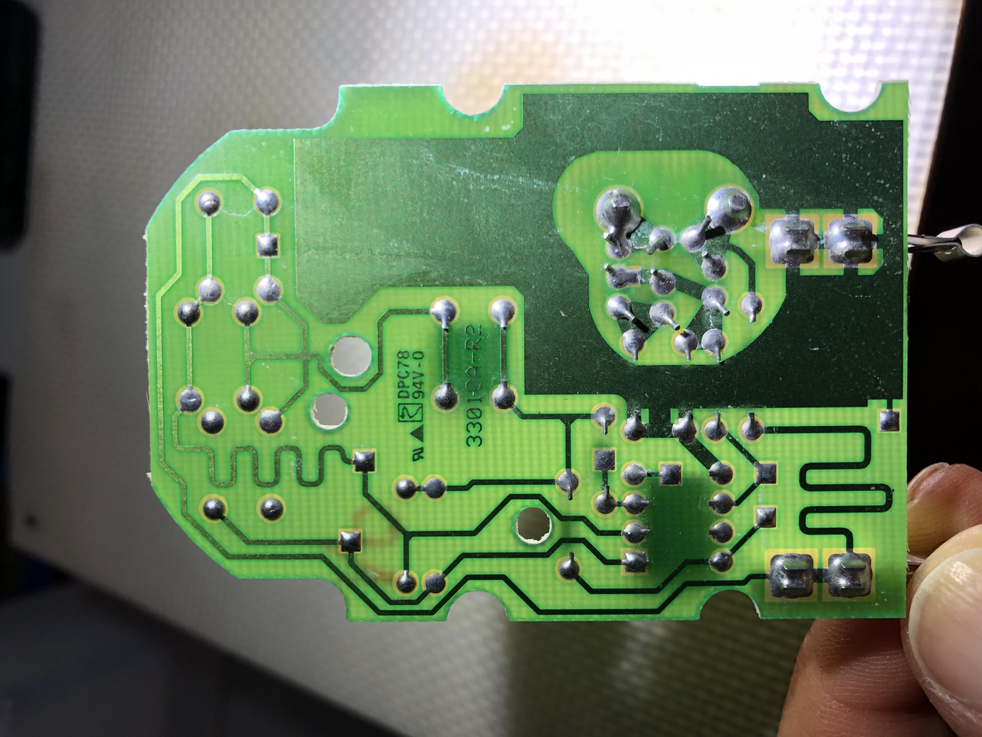

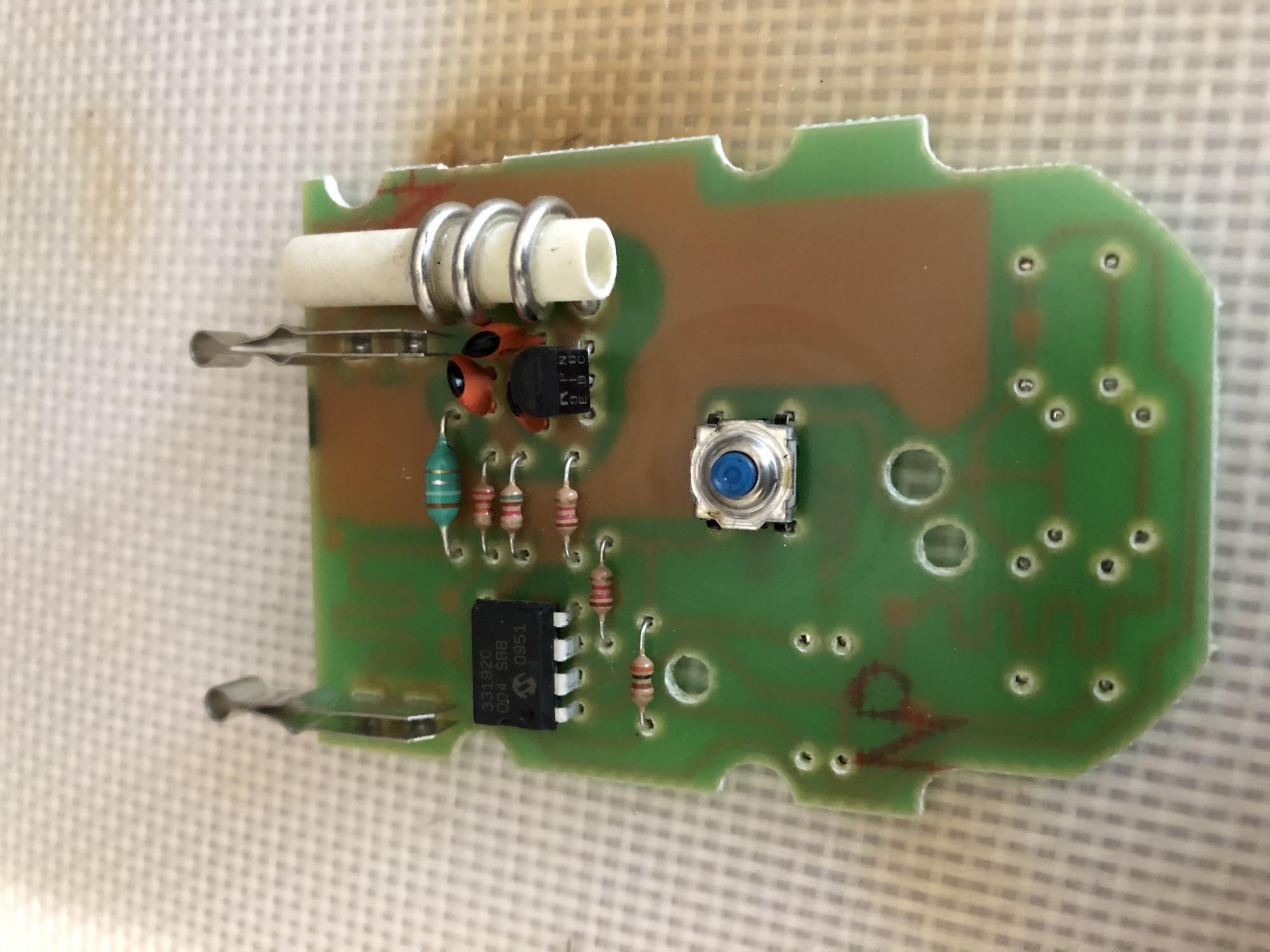

    I have two of these and used the working one to do a comparison measurement. Oddly everything seems to be identical in value when measured. I even did a diode mode measurement (+ probe on - battery terminal) of all components and the ic. The values are the same between the two.
    Only difference I’ve noticed is as follows:
    Working one:
    12v on C of NPN transistor
    Press button
    0v on both B and E
    Bad one:
    12v on C of NPN
    Press button
    1.5v on B
    1.1v on C
    But the transistor measures good and has same values of working one
    Any idea on this?

      I'm not sure you can measure the voltage on that transistor, it's part of the RF electronics. In any case the readings you gave are suspect, especially when you gave "C" twice on the bad one. Please remeasure and also note when you measure voltage, what is your reference point...
      • redwire
        • Dec 2010
        • 3912
        Re: Remote garage door opener - not working
        It's hard to tell because the TX transistor operates at VHF and a DMM and long test leads may or may not kill the oscillator at the 315MHz or 433MHz it runs at.
        You need an RF probe or SDR or something to see if it's transmitting anything.
        What I do is trim the transmitter frequency. There is an adjustment - usually a trimmer capacitor but here it's a slug inside the white tube on the inductor.
        Put most of it back together and when far away I adjust for the best range.
        This is using Microchip Keeloq like HCS30x series with rolling code. So the remote will need to be "learned" by the garage door opener before anything can happen.

                          Maybe measure the voltage drop across the 300R resistor going to MCU power on pin 8. 12V on one side and MCU power on the other. Or measure the current drain on 12V power in.
                          The MPS918 is pretty tough and not likely to fail, although I'm not sure what happens when a battery is put in backwards on one of these.
                          On the working one, the transistor reading zero on B, E is not right- it's just off then and doing nothing. The MCU makes 66 bits at 0.1 to 0.4msec/bit pulses when the button is pushed. So a slow multimeter will not catch that.
                          • caphair
                            • Nov 2011
                            • 1249
                            The way I was able to get readings was to hold the button down. If just pressed normally it was too fast to see anything.
                            I’m curious what the white tube wrapped in thick wire is. Is that was transmits the signal?
                            What component is most likely to fail on this? I’m not familiar with the operation of one of these

                                The white tube with the wire is the coil along with one of the small capacitors that sets the r.f. frequency. I use sdr spectrum analyser software and a cheap usb receiver (RTL2832) to check these now. You could swap the ic or transistor between the two units.

                                  Something still doesn't make sense, i'd expect the voltages on the "working" one to have different voltages on B and E, and neither 0V - unless you can't see it.
                                  Pin 7 appears to be an LED output on the IC that's not connected/used, you should connect an LED there and see if that at least blinks - seems simple enough, connect anode of LED to pin 8 of the IC and cathode to pin 7.
