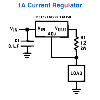

                    Have a look at this schematic and see if you can straighten me out, as I must admit it's a bit over my head. To my mind (and this is the important bit) it goes like this: all the current has to go through that series resistor. For simplicity's sake, let's say it's 1ohm. If the output voltage is 12v, that means the maximum calculated current through that resistor is going to be 12a (Ohm's law: V divided by R equals I. 12v / 1ohm = 12a). At the same time, the regulator's ADJ pin is being pulled to ground through the load itself, which means that the higher the load (its resistance is lower), the more the regulator is going to try and "close down", bringing down the voltage and thus the power along with it (since U*I = P, so if U drops, so does P). Now say I drop that circuit before the CV side of that Op-amp s**t I'm trying to build...what would happen ? :|

                      Yes that CC circuit indeed drops and burns a lot of power in the resistor as the current pass gets higher. The CC/CV PSU schematic I usedfor my bench PSU (attached above) drops the voltage in CC mode in the transistors instead. Unless you go switching, something needs to eat that excess in CC mode.
                      BTW the LED lights up when the adjustable current limit is reached.

                        I was going to ask what schematic you're talking about, but then I noticed you were kind enough to provide it further down below ) Thanks. Also, I too thought of replacing the resistor with a transistor, but wasn't too sure how to do it. I'll have a look at your schematic and come back with any questions. Cheers.

                              Re: UA741 op-amp power supply question
                              It is 1A constant current source, the output Voltage will vary to maintain the constant 1A through the load, so the maximum current flowing through that output current setting resistor will be at 1A max, the max load current will also be at 1A.
                              So basically if you put 1 Ohm load, the circuit will force 1A through 1 Ohm load so the Vdrops on 1 Ohm load will be 1V, if you put 10 Ohms load, the circuit will force 1A through the 10 Ohms load so the Vdrops on the resistor will be 10V. That is what Constant current power supply will do.
                                I kinda thought of that too. Say I put a fairly "hungry" load on it, it would theoretically bring the output to 1.25v (since that's the minimum ref. of an LM regulator). Anything to keep the current to 1A.
                                Wattevah...
                                  You can short the output of that and it will still putout 1A, but you have to make sure you have heatsink on the LM317 because the Vdrops on LM317 x 1A on the LM317.
                                  LM317 needs the diff between input and output of about 5V, need to look at the spec sheet again.
