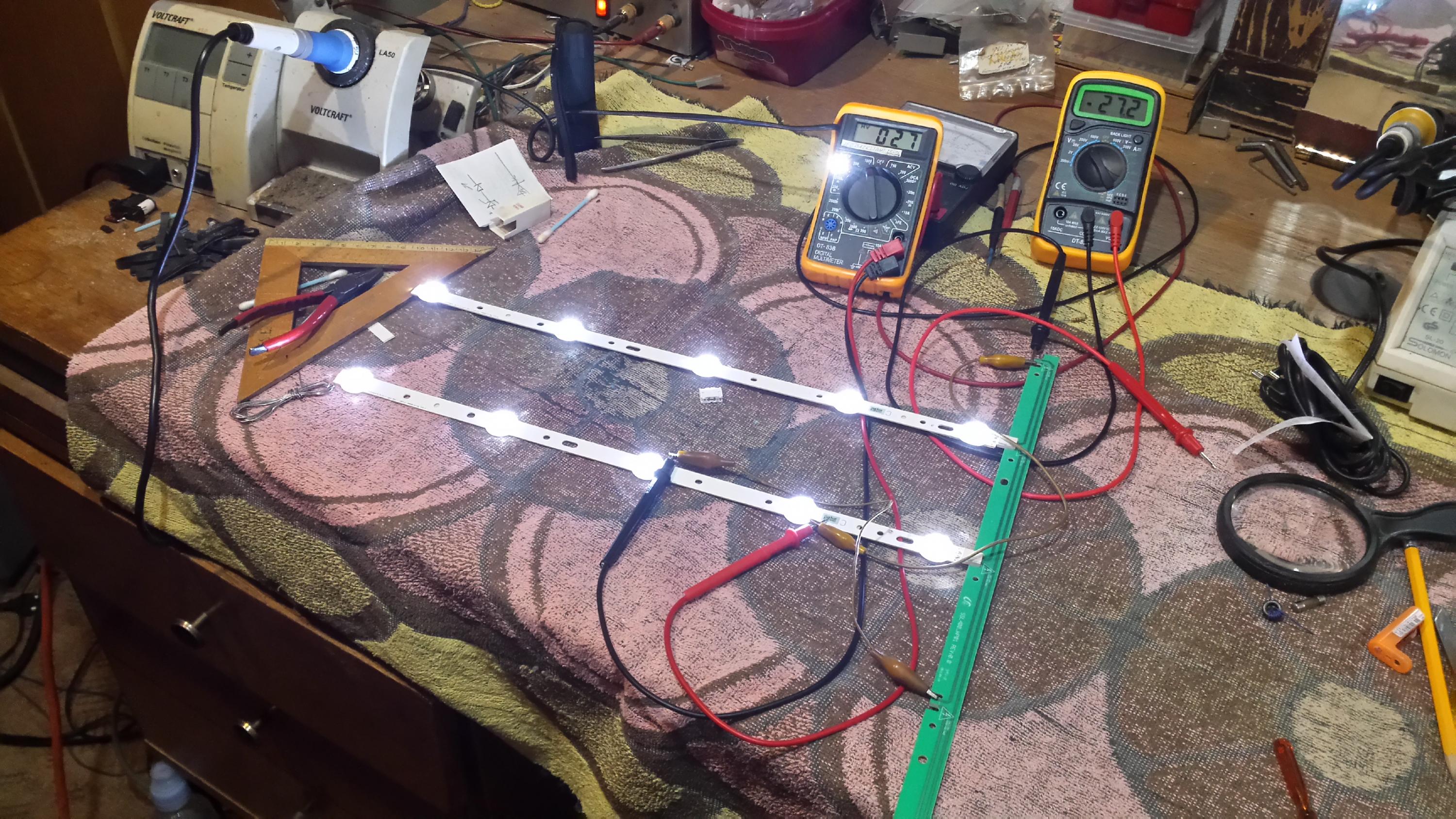

                Re: LED backlight tester circuit
                I just tried using a model train power supply to check led strips. My dc power supply has a max output of 17.6 volts. I can test up to 5 in a strip. 10 is to many for my power supply to power up. Has any one else found something like this to use?

                    You have to be real careful testing the LED strip without current limiter or constant current.
                    So have 5 LEDs on the strip and you apply 17.6V directly without any current limitter, and if one of the LED shorted out, then the current flowing through the string will be so high that can damage the good LEDs. I use power supply that I can adjust the current.
                    If you do not have one, you can use LM317 with heat sink as constant current source for driving LED.
                    You can easily do the experiment and measure DCA through your LED string with your 17.6V power supply, then short out one of the LED to see what happen to the current and then look at the spec of the LED for the current handling..
                    LED is not linear device.
                    I do not understand why people keep trying to run the LEDs without any current limiting in place.
