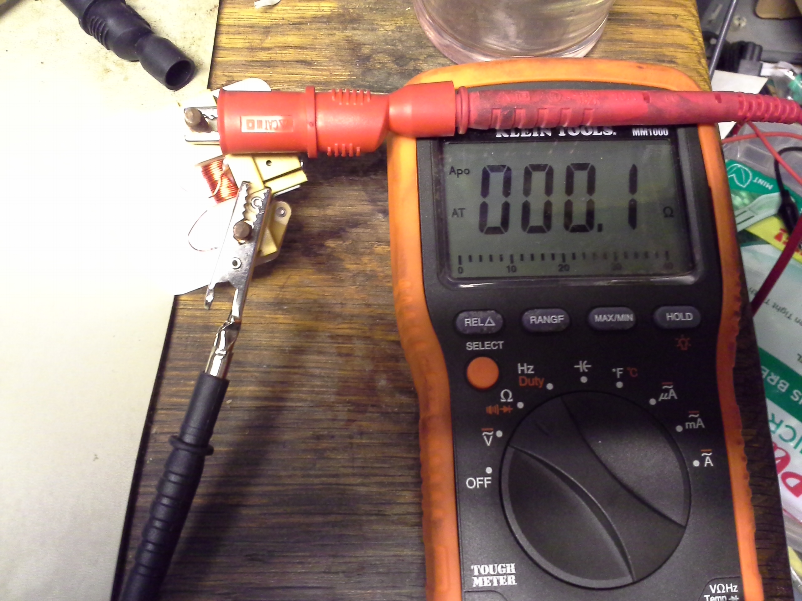

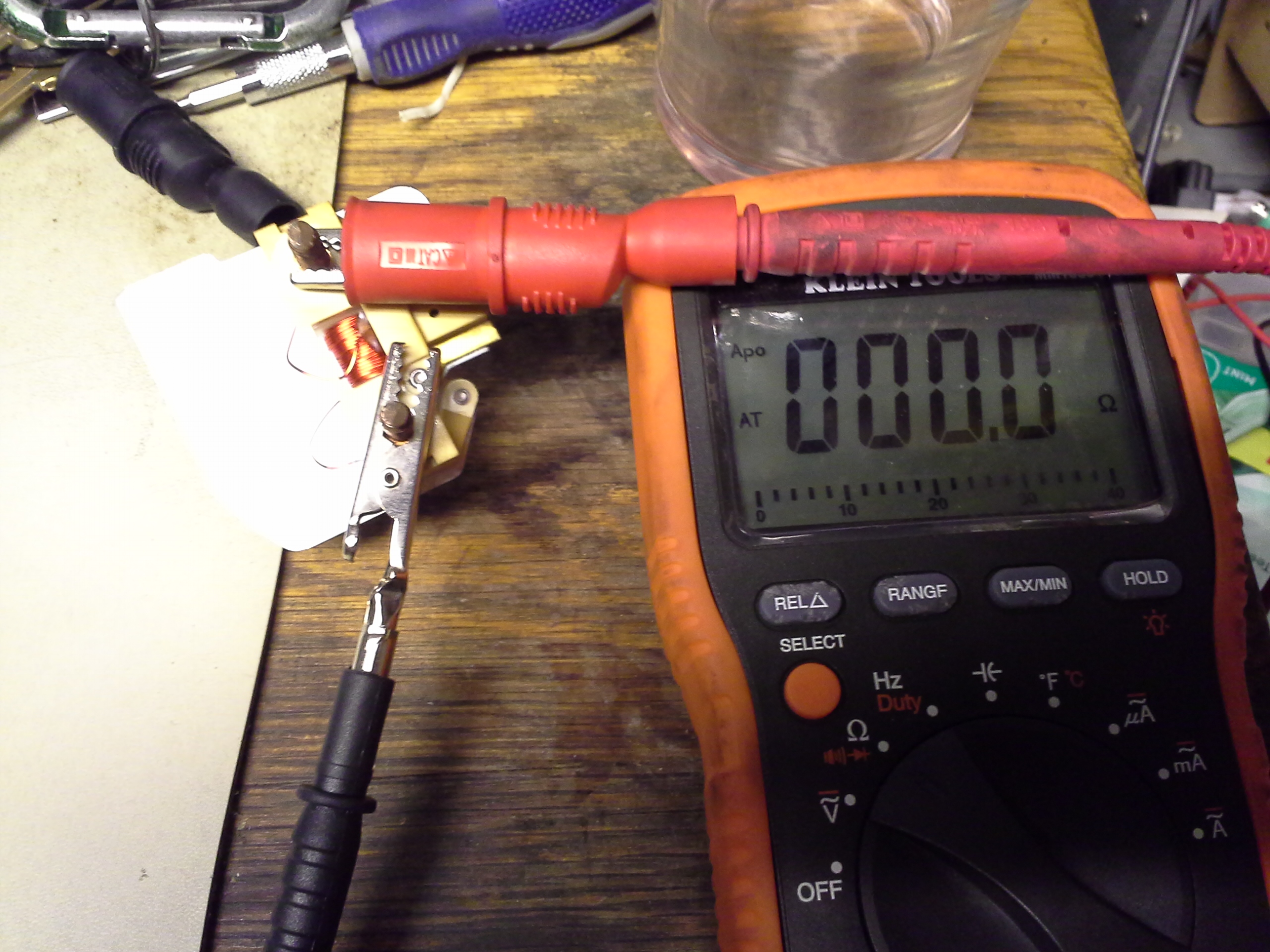

    DCR of 0.4 Ohms is normal for that electromagnet coil.
    The needle assembly is not binded up?
    Well, hold on, those alligator jumpers are kind of known to have some resistance, let me take a second read.

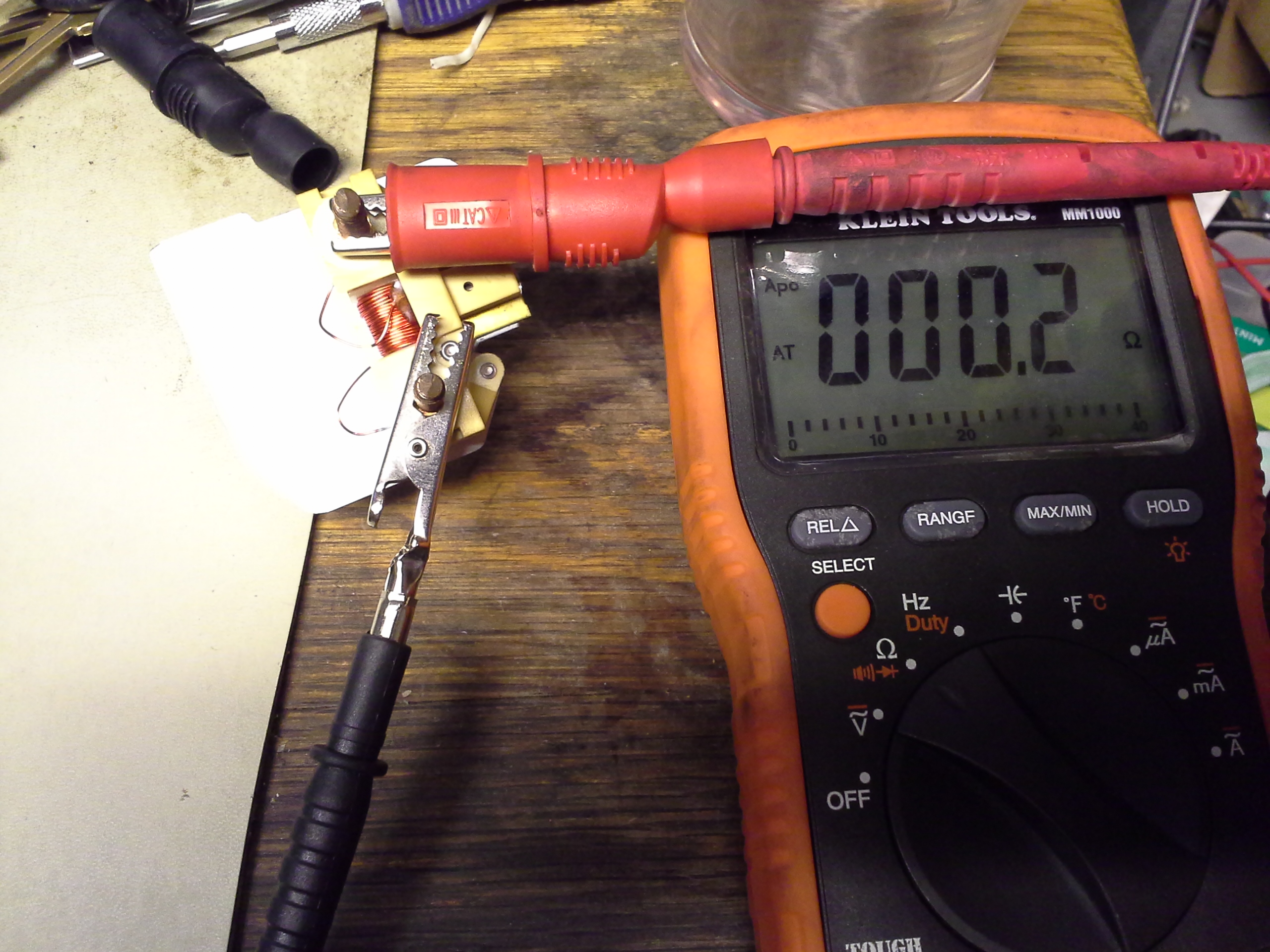

      Here are three readings.
        #43
        Re: Boost output voltage on a 7805 regulator
        The resistance has to be very very low to reduce the Voltage drops and power dissipation on the meter.
        If it is really 0.1 Ohm (did you zero out the meter probes resistance) and you have 30A flowing, the Vdrops will be (E = I x R) = to 30A x 0.1 Ohm = 3V! so with 12V system, the load will only see about 9~10Vdc, and the power dissipation (P = I x E) on the meter will be = to 30A x 3V = 90 Watts! 20A will be 40W.
        http://www.sengpielaudio.com/calculator-ohm.htm
        Did you verify that the needle is not stuck?
          Yes, the needle is not stuck and moves freely.

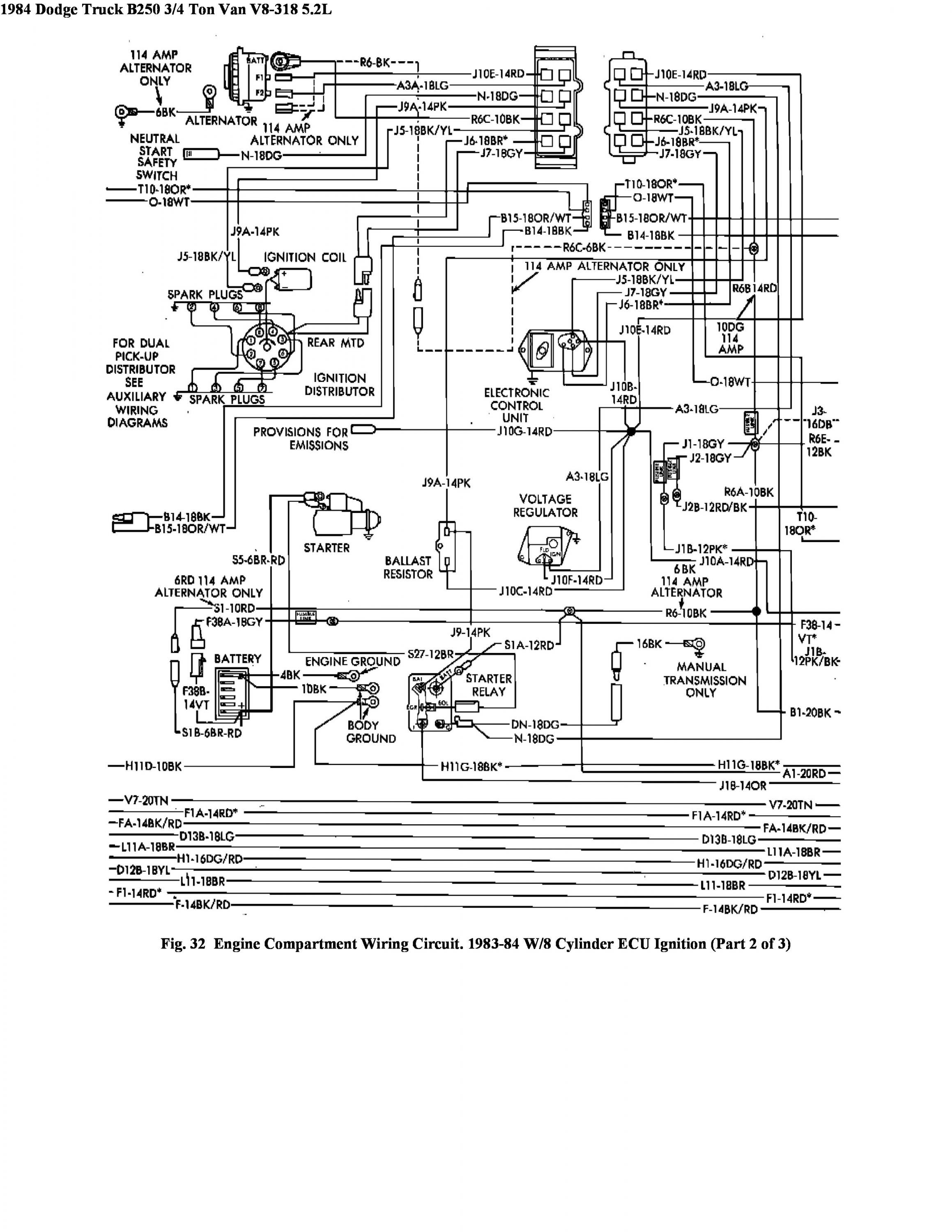

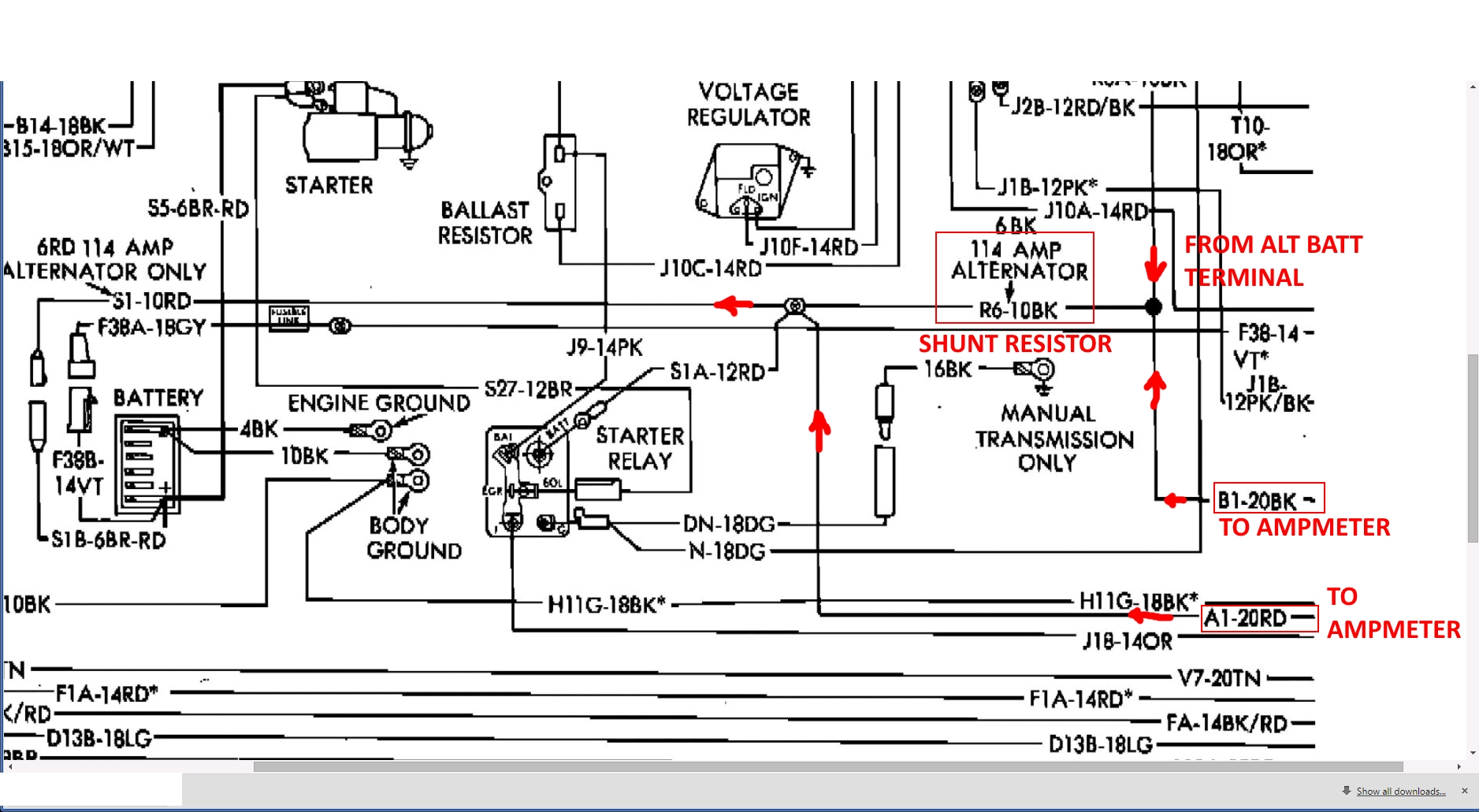

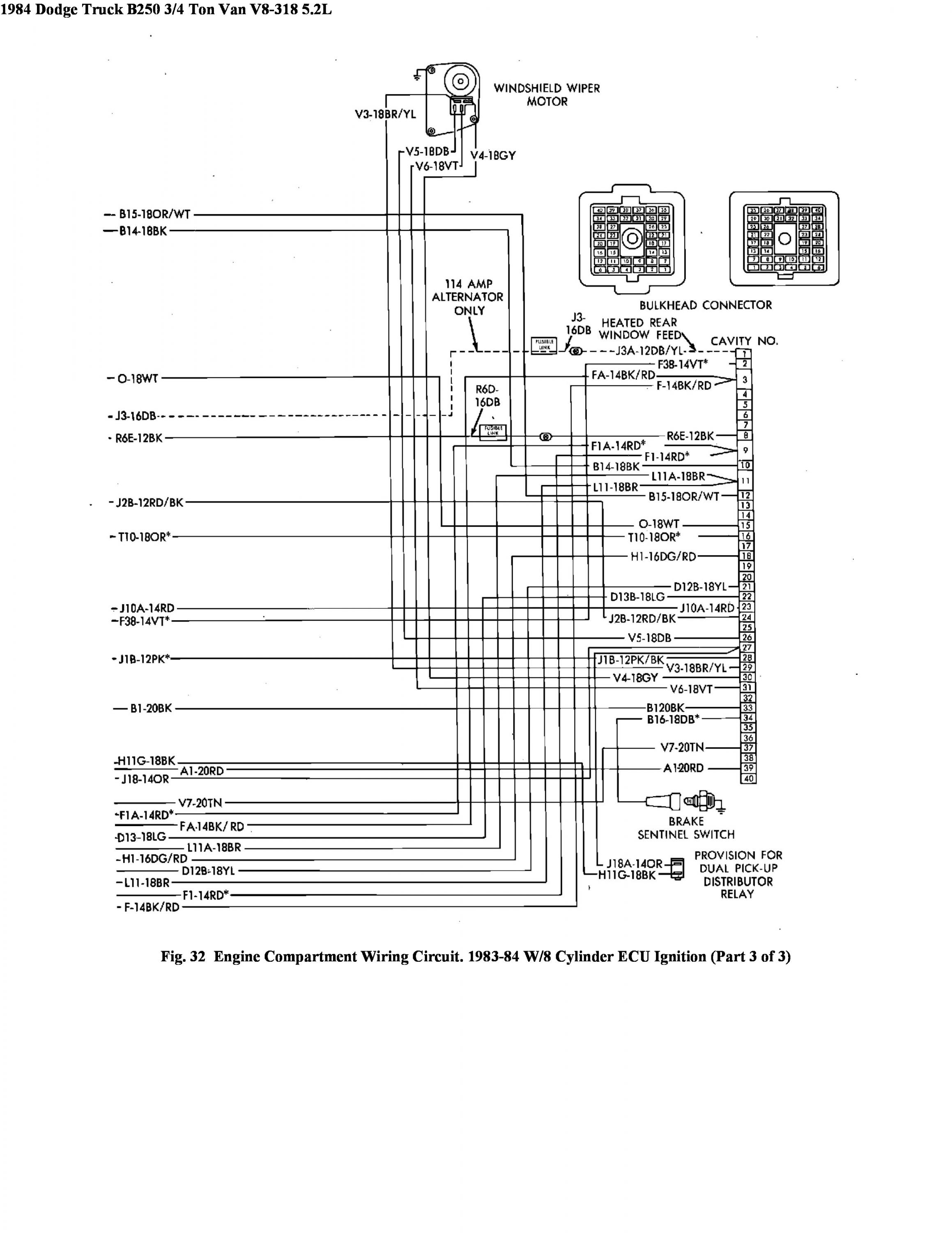

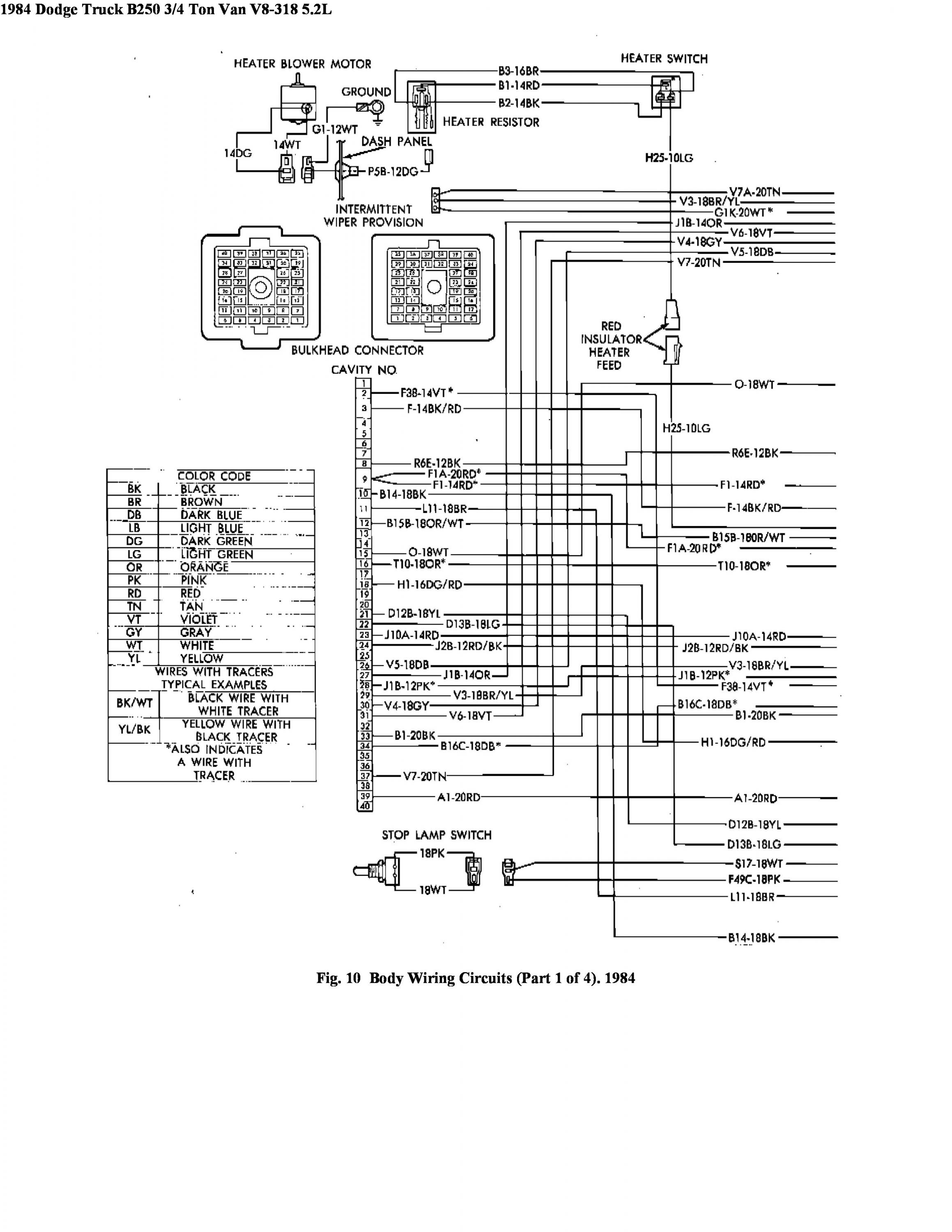

          Here's a wiring diagram from cluster to engine harness
          Circuit A1-20RD and B1-20BK are for the ammeter.

            Looks like you should be fine to use a DMM (should still used a fused one) to measure the current. That meter is not taking all of the current (looks like it's only 22? 24? gauge wire winding?), there's another shunt in the schematic that will take the brunt of the current and reduce the total voltage drop. Looks like R6 is the shunt, and it's a piece of 10 or 6 gauge wire depending on what alternator you have. The shunt is fine if you're not getting anything at the meter, likely one of the wires to the meter is bad. You could test your meter with a current limited PSU...
              #46
              Yes, it does look like it has shunt resistor (R6-10BK) in parallel withe AMP meter.

                      How about a test?
                      With the engine off and meter disconnected, turn on the headlamps.
                      Measure the battery voltage (Vbat) and the voltage between the meter terminals (Vshunt).
                      Calculate the headlamp current using Plamp x 2 = Vbat x Ilamps, where Plamp is the rated power of one headlamp.
                      Now Vshunt = Rshunt x Ilamps, so this should allow us to calculate Rshunt.
                      If the meter goes to fsd at 30A, then Vfsd = Rshunt x 30A.
                      If fsd occurs at a meter current of 0.2A, then the resistance of the meter should be ...
                      Rmeter = Rshunt x (30A / 0.2A) = 150 x Rshunt

                          So we took the wrap on the wiring harness off on the engine side of firewall, and found the welded splices and I think a diode of some sort. Not sure what it's for yet, but we hooked up the ammeter to two places where the welded splices were and we were able to see changes on ammeter, with the A/C blower and head lamps on. Our guess is there is a fault between the firewall.
                          My dad and I are thinking of modding a volt meter inplace of the ammeter.

                                    #57
                                    Originally posted by Mad_Professor
                                    So we took the wrap on the wiring harness off on the engine side of firewall, and found the welded splices and I think a diode of some sort. Not sure what it's for yet, ...
                                    IIRC, Chrysler added a diode for back-EMF protection. Does the truck have a mechanical regulator for the alternator output, and does it have an electronic ignition (with magnetic reluctor pickup)? If so, then that's probably the reason for the diode.
                                    Originally posted by kaboom
                                    Which will break the ckt- ammeters go in series and are low impedance. Put a voltmeter there and its high impedance opens the ckt.
                                    There is a shunt (R6) in the cable between the alternator and battery, so there would be no problem in removing the ammeter.
