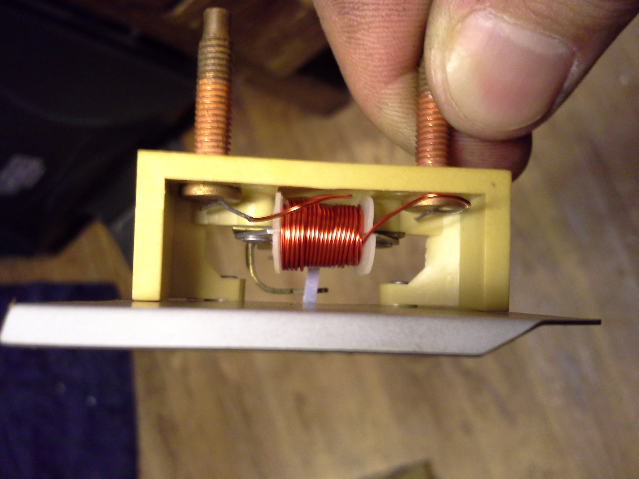

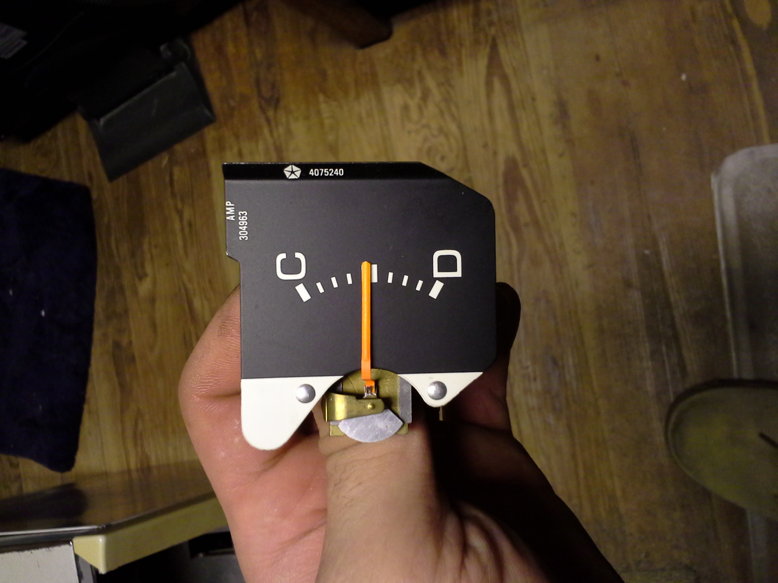

                        Right now, my dad and I are trying to fix the AMMETER gauge, it's doesn't get a reading, sits dead in the middle. I'm not sure how it's works. I tried to hook up my DMM and set it on ammeter, but it didn't get a reading as well.
                        Then it started to rain, so I called it quits for tonight.

                            Thanks for the heads up, but nothing happened. I have several fused inputs on my meter.
                            Anyways I'm not sure what's wrong, I've found the wiring diagram and I get 12v from one lead and 12v from another lead, it's a very simple design.
                            Can a bad cell in a battery that otherwise will function cause this problem?

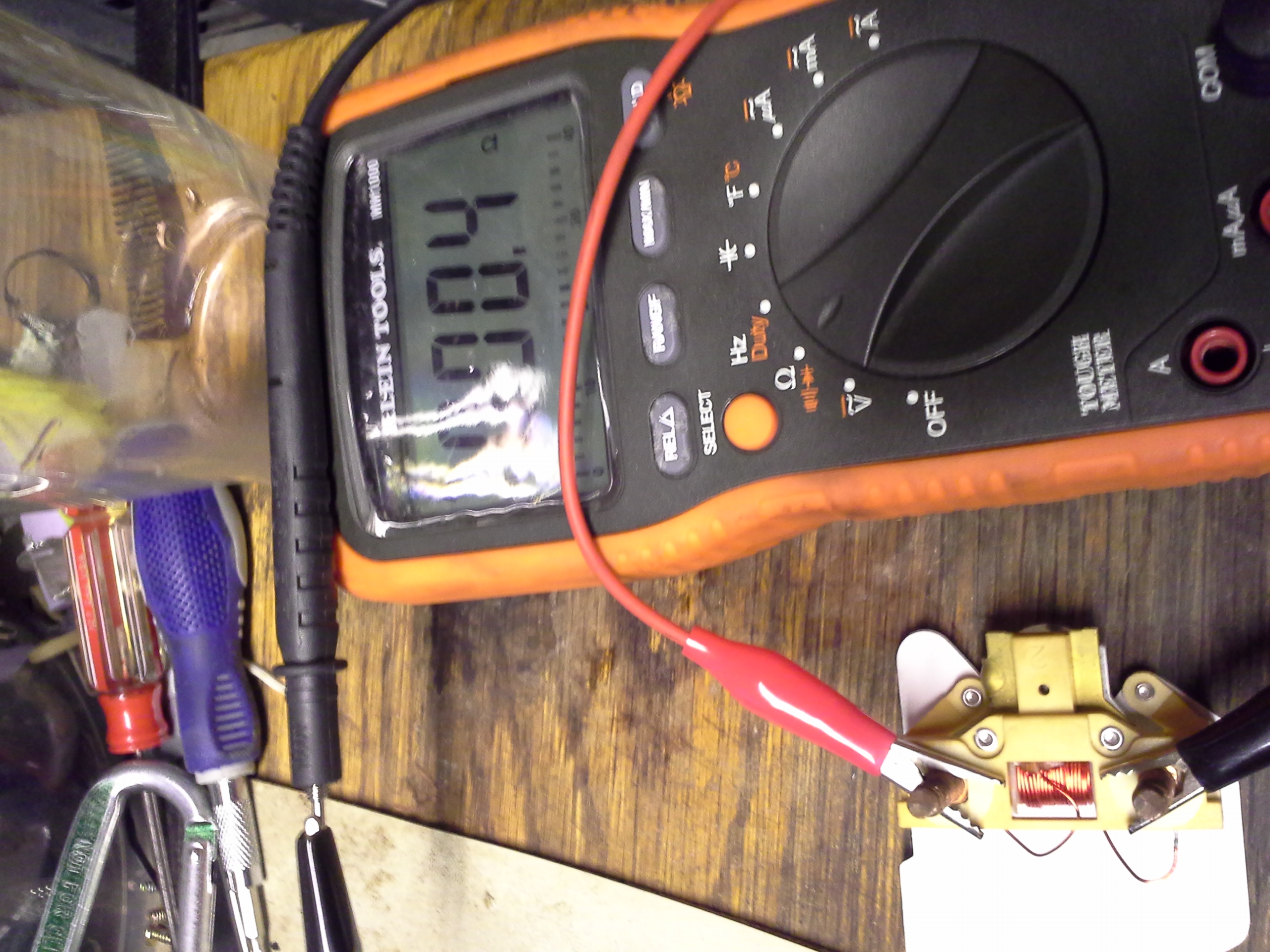

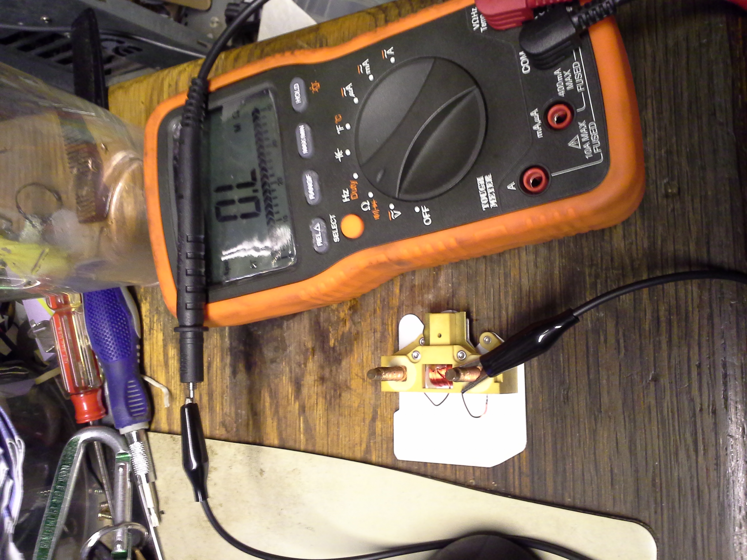

                              check the resistance between the terminals on the meter - with it disconnected.
                              • Mad_Professor
                                A Mech Warrior
                                • Feb 2011
                                • 1587
                                #35
                                Re: Boost output voltage on a 7805 regulator
                                Originally posted by stj
                                no.
                                it's current flow.
                                either it's inllne with the battery like a fuse, or it's inline with a parallel shunt resistor to save it from most of the current - more likely.
                                It's reading 0.0 ohms.
                                Shorted?

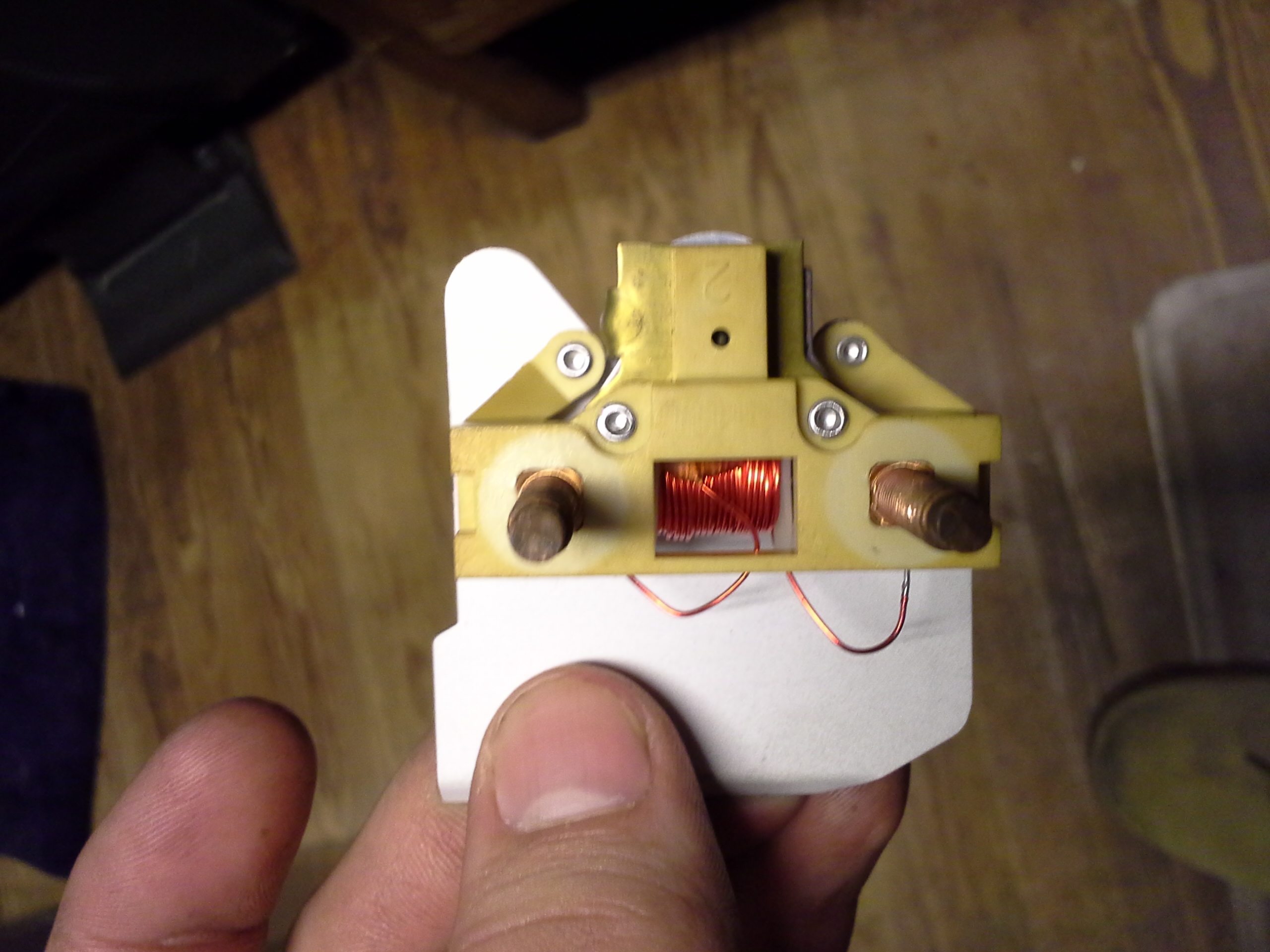

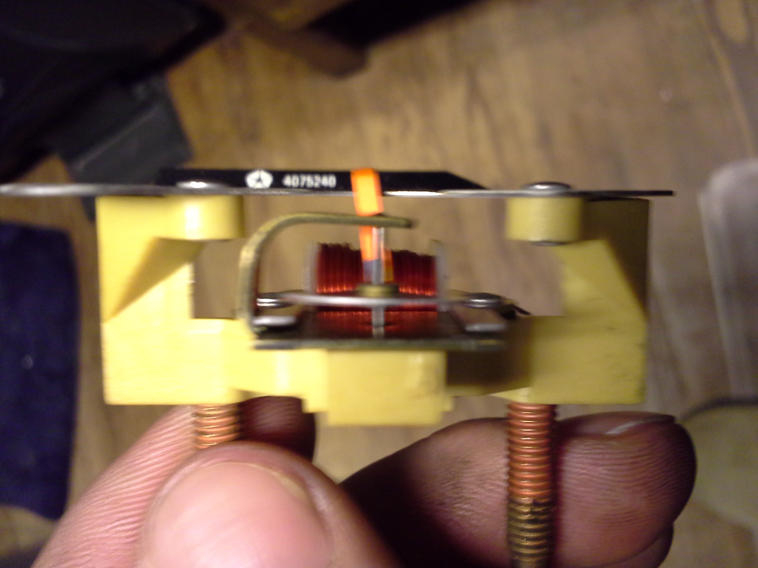

                                  could be - show a foto of it.
                                  • Mad_Professor
                                    A Mech Warrior
                                    • Feb 2011
                                    • 1587
                                    #37
                                    Well here's the photos.
                                      I believe the ammeter should connect between the alternator and the battery.
                                        #39
                                        DCR of 0.4 Ohms is normal for that electromagnet coil.
                                        The needle assembly is not binded up?
                                        http://www.madelectrical.com/electri...p-gauges.shtml
                                        Amp Meter wiring:
                                          • 31248
                                          #40
                                          what i was thinking.
                                          it's pretty shit btw, the ones i used to see actually had the scale marked in ampsx10 (10,20,30 etc)
