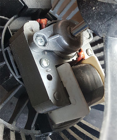

                        Hello guys. Sorry about the delay. here is a photo of the motor.
                          Re: Slowing Down A Fan
                          BTW, I have no clue what kind of motor that is, that is why I posted a photo
                            C-frame shaded pole motor- perhaps the most common "modern" small fan motor...
                              Cool, thank you for your replies.
                              Just cause I am a bit of a noob and I don't want to make the wrong purchase, what would be the best way to control the speed on one of these (and hopefully be able to turn on/off and control from about 3-4 feet from the fan itself)?
                                Just do the search for 'shaded pole motor speed control'.
                                You may also be able to find one with wireless remote control too.
