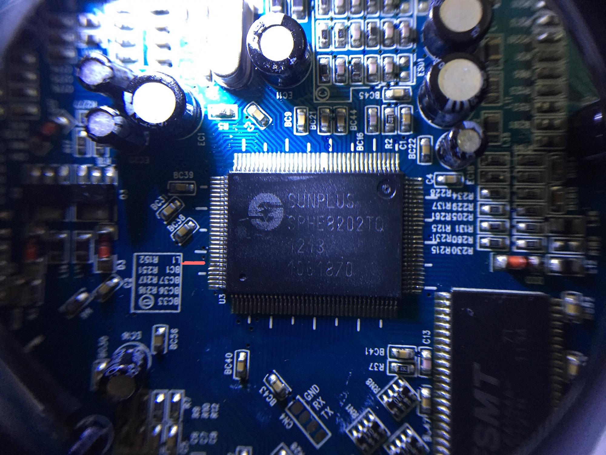

So the processor is the problem. Can't be corrected without replacing the processor?

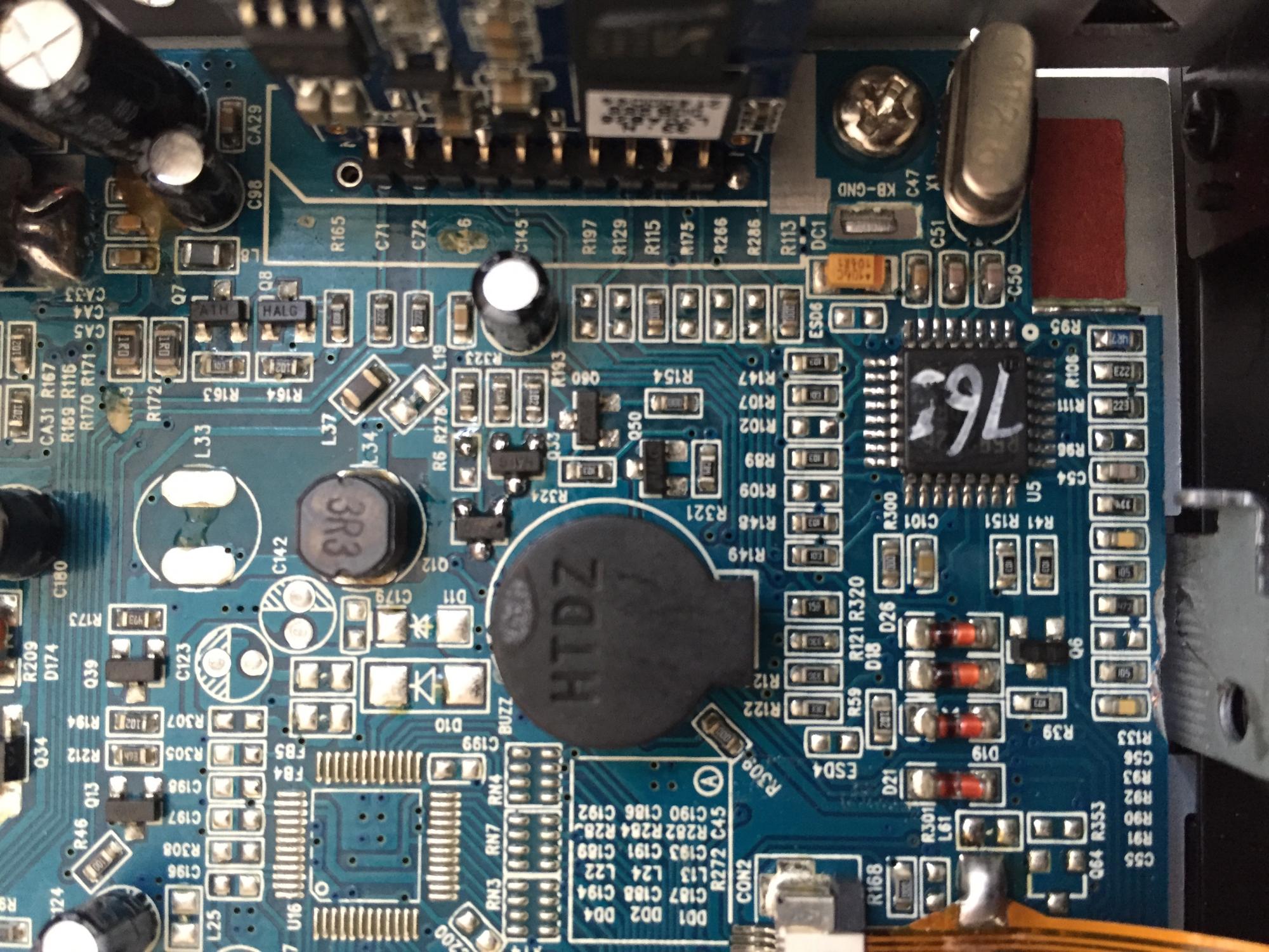

VCC 5V = power on
+ 0.22V = standby
display | |
o----+ Q12 |
5V = OFF \| |
0V = ON |----+
<| | hi = OFF
| \| ___ lo = ON
| Q33 |--|___|---o
| <| from micro
GND
