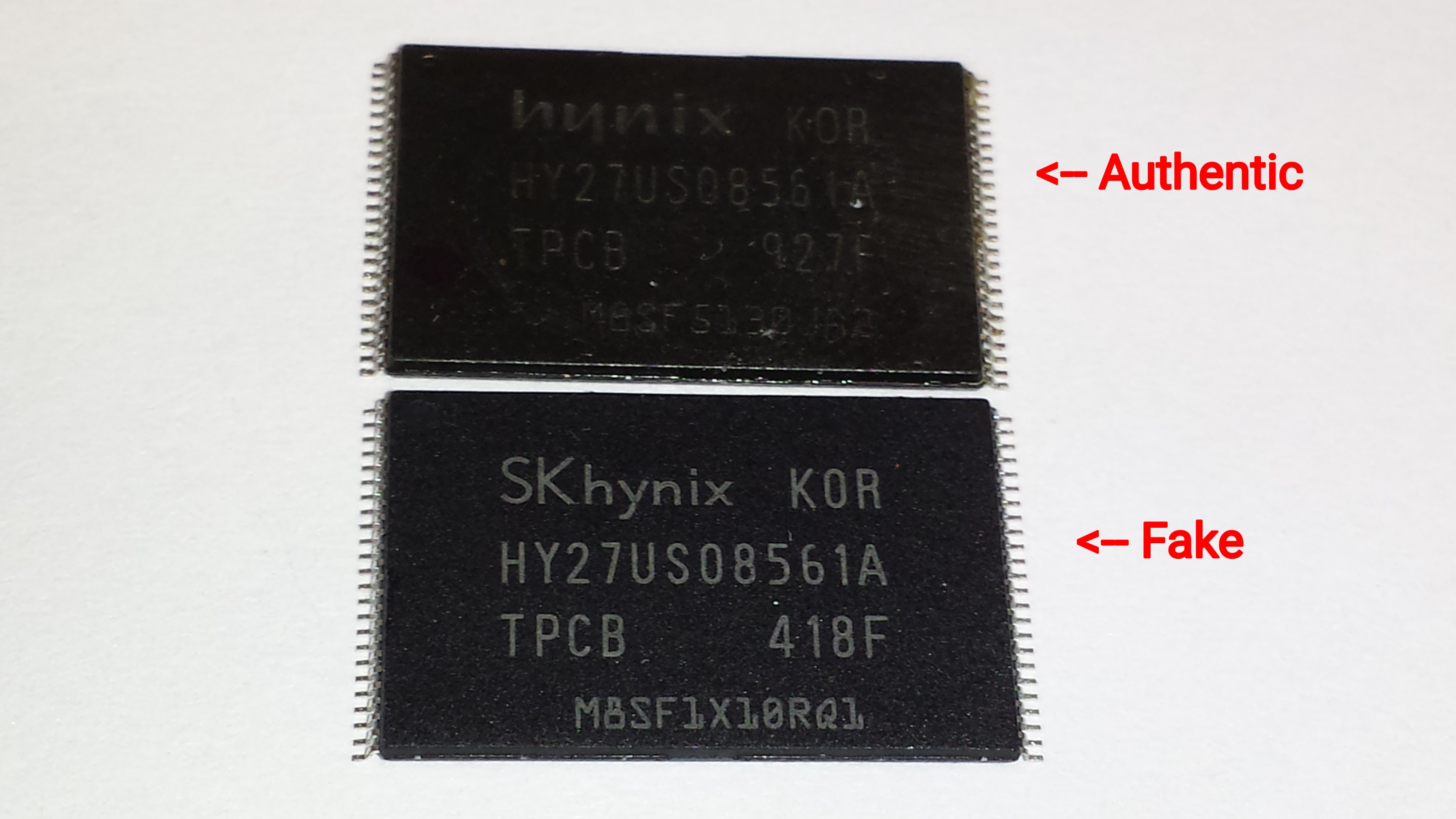

    Counterfeit NAND ICs?
    So, I bought these NAND memories a few months ago on AliExpress. They were supposed to be Hynix HY27US08561A. I finally decided today that I'd finish the Sanyo DP42849 which has been buried behind dozens of other TVs for several months. So, I got my programmer out, and after several hours of trying to get it to work (@$%#& Windows 10 update @$%#& breaking everything!) I finally got it working again and found that the memories were not recognized. My programmer (GQ-5X) was saying unknown device and showing EC 75 A5 BD as the device registers. Well, I knew EC was Samsung's JEDEC ID, so I suspected something was wrong already. I Googled the device registers and found the memory to actually be a Samsung K9F5608U0x. I created a device definition based on the data in the datasheet and the programmer recognizes it. They seem to be identical, I'm hoping I can still use them.

      Re: Counterfeit NAND ICs?
      There appears to be a difference in the PRE pin. It exists in the Hyundai part but is NC in the Samsung. Also, the Samsung has an additional GND pin (pin #6) which must be grounded. If you don't ground this pin, you won't be able to read the spare bytes. Pin #6 is NC for the Hyundai part.
      BTW, how can you be certain that the data you are reading from the original part are not corrupt? Do you have any way of testing the ECC?
        I bought a new memory a while back and got a read dump so I wouldn't have to spend $30 every time I needed one of these.
          Each page of the NAND IC consists of 512 bytes + 16 spare bytes. The spare area would normally contain ECC bytes for error detection and correction.
          If you simply read the raw data plus ECC and then write it back, you will be making copies of any errors. You need to correct the raw data for errors, recompute the ECC, and write back the error-free data to your new IC.
              I meant I bought a preprogrammed memory and copied it.
                  Sorry, now I understand. Still, it would be an interesting problem for those cases where you didn't have access to a known good image.
