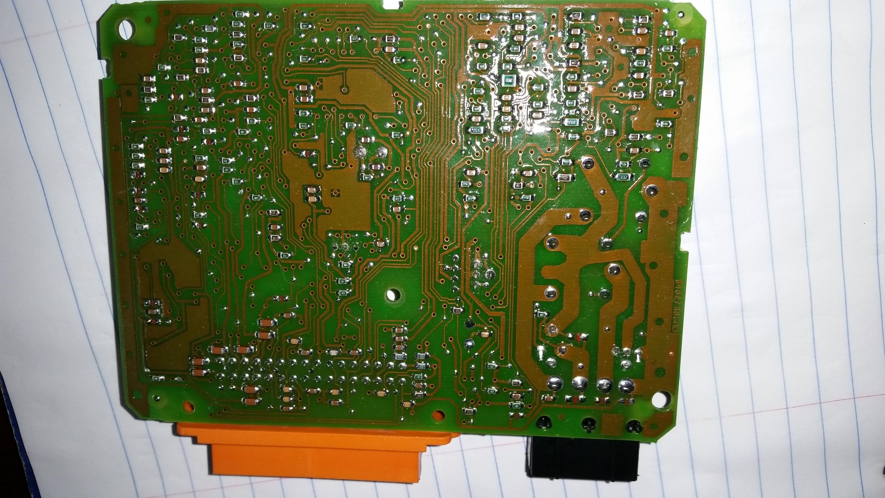

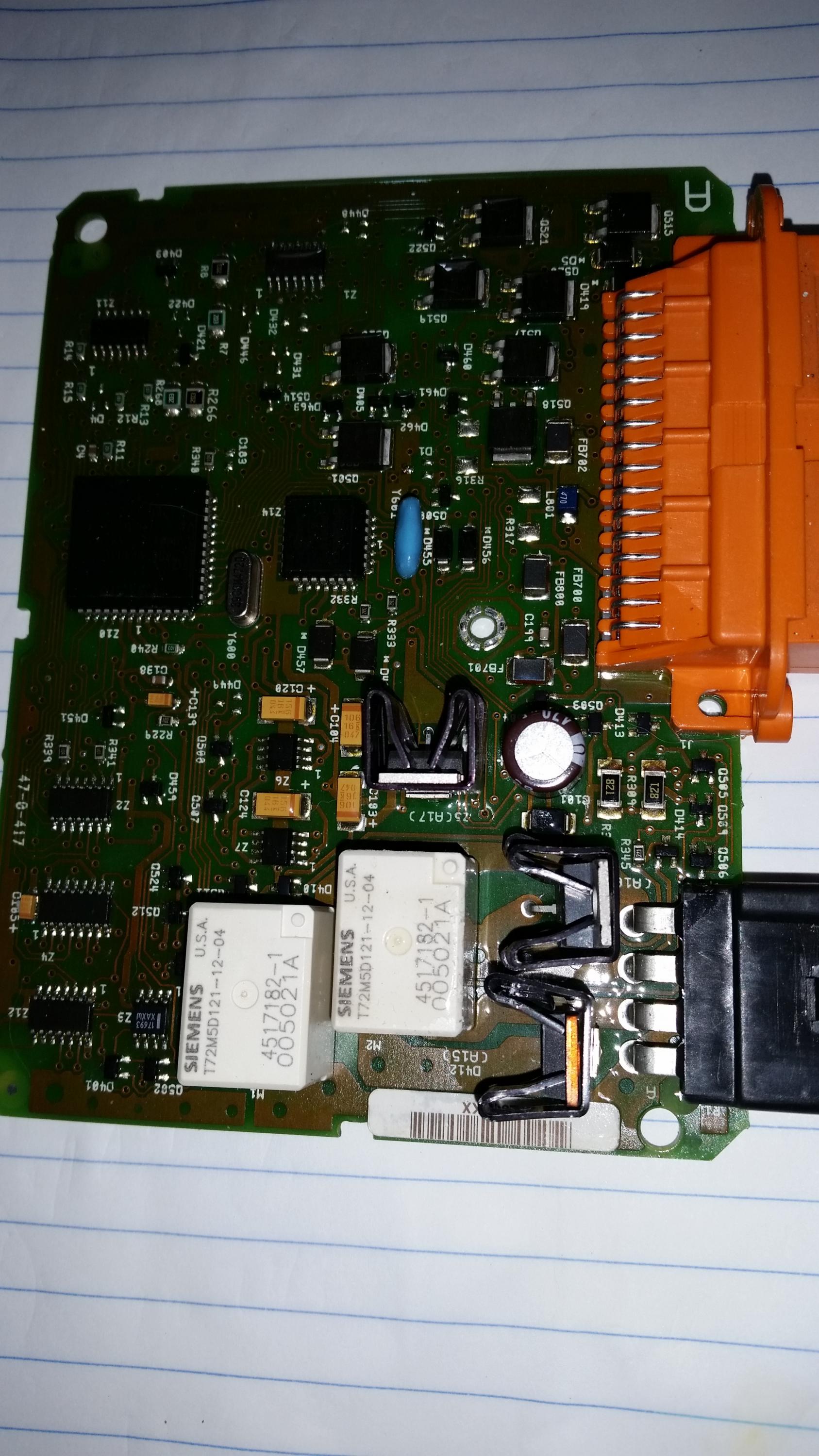

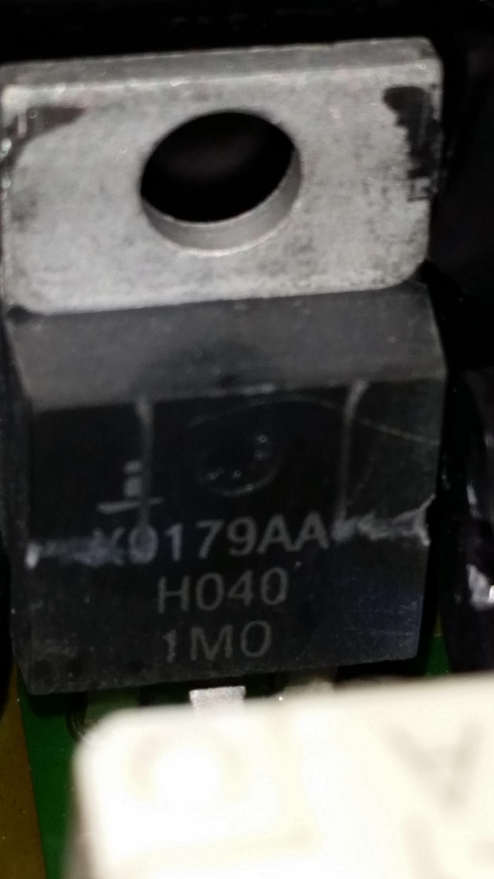

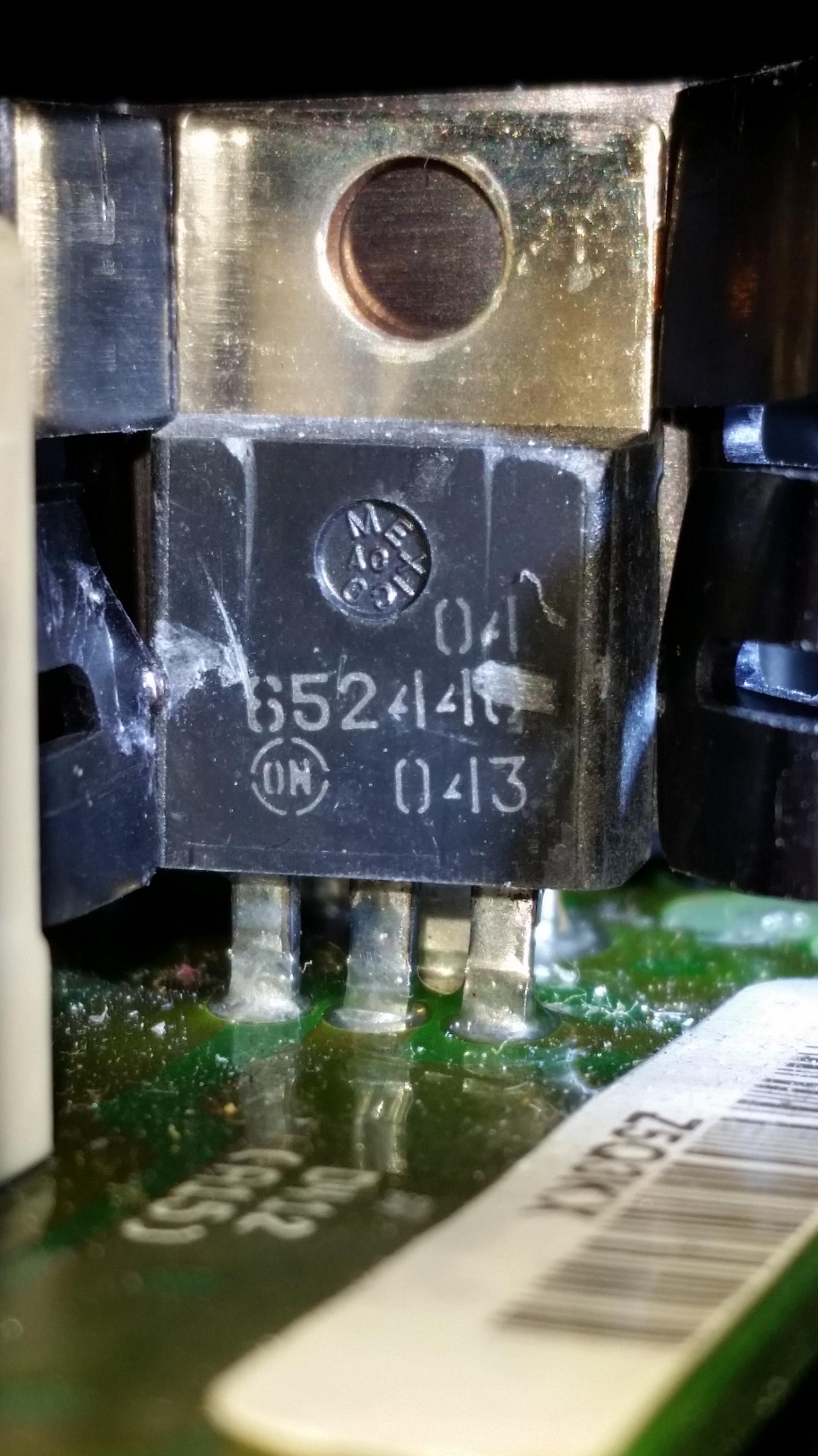

    I'm trying to find a replacement for these 2 transistors. They are in a shift control module that belongs in my wife's SUV. The one labeled badtrans seems to be shorted (tested in circuit). If I can find a replacement I'll remove from circuit and test it to be sure. Any help would be appreciated.
    thanks, pbr333

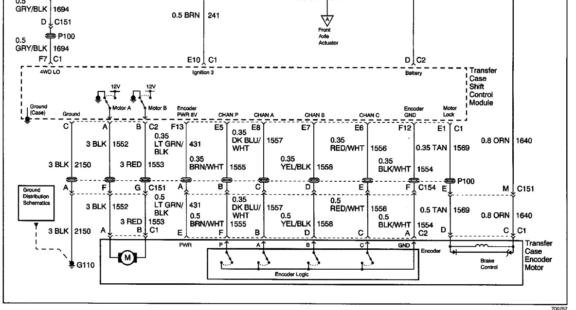

      chevy 2001 Tahoe. I believe this motor control circuit in where polarity to motor is switched to achieve transfer case gear change.

        I attached circuit diagram and pic of module.

          they are probably fets
          so pull the working one and stuff it in a component tester.

            D412 is the circuit reference for a diode. The part looks like a dual diode that connects between each motor terminal and the positive supply.
            The relays do the switching, not the semis.
            The pinout for the relays is in the following datasheet:
