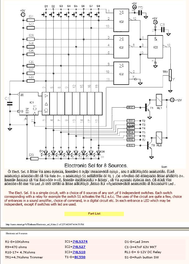

    Well, I found this:
    http://www.aaroncake.net/forum/topic.asp?TOPIC_ID=6356
    Looks like what I need... Any ideas?

                          I've got the part down on how to interface the relays with the control logic, I just don't know how to make the front end control.
                          Seems that since only one of the eight input relays can be on at once, it would be an 8 input XOR circuit, with 8 outputs.
                          The confusing stuff comes with the output side, that needs to allow for any two outputs to be on at once. I think I'll just use manual control for the outputs and forget the control logic.
                          Each input and output would have one DPST relay, which would mean one set of contacts for each left and right channel.
                          So basically forget all the complex stuff... I just need a circuit that would allow me to push a button to turn on a relay, and if a different button is pressed, would cancel the first. I'll control the output relays manually with a simple latching circuit (press on/press off).

                                mx is going the simple route
                                but now his got me thinking about it and so with reference to my rough idea this would be the input side.
                                the 4017 IC is the puppy I was trying to think of well that type of logic anyway
                                Ic families have moved on quite a bit since my days with CMOS and TTL
                                see this page here
                                the bit of text is under the 2nd schematic with the 4017 and relays
                                you would have to adapted it to work with a momentary push on switch, if memory serves a flip flop would provide de-bounce for it.
                                this would allow you to step through (which is a down side I suppose) each input relay.
                                The up side is only one (hopefully) will ever be on..so you don't have to receivers (amps) connected to each other.
                                Note the use of Leds too.

                                  • Maxxarcade
                                    • Jul 2006
                                    • 973
                                    Re: Logic latch circuits for relay drivers?
                                    This diagram I posted earlier seems to be exactly what I need, I'll have to test it on a breadboard.
                                    • starfury1
                                      • May 2006
                                      • 1256
                                      Sorry Maxxarcade this was your original question
                                      (before I went off on spiel)
                                      If it switches a bunch of relays on and off then yes it would do what you want.
                                      I think as was posted the relay and trannie are more a representation of what should be there
                                      LS is an old family
                                      It won't have any DOH! factor protection but thats up to you anyway
                                      I take it you were going to have some RLY's as I/P others as O/P
                                      I'll have to have a better look at the finer details later got to run...
                                      BTW the safety thing above I did scratch it got a better idea.
                                      chers mate and yep do a bread board and see if it does the functions you need then go the whole hog.
