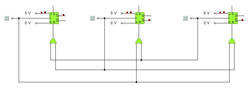

              Re: Logic latch circuits for relay drivers?
              This is the circuit that I have thought of. I know it is a little bit late now, however I could not be bothered drawing a circuit with 8 switches. It is a tedious method for 8 switches. However it is perfect if you want to switch up to about 4 switches.
              The basic logic follows like this:
              The buttons are attached to the clock signal of a Flip-Flop. Every time a button is pressed, the output will be the logic value '1' (this is because the JK flip-flop is setup to output a logic '1' on a clock edge. A D flip-flop can also be used easily). The button attached to one particular flip-flop is attached to all the other flip-flops 'reset' signal through an OR gate (the more switches you have, the more inputs the OR gate needs to have, no OR gate is required if you are switching between two switches). Therefore when a button is pressed, the output of that particular button will be a '1' and all the others will get reset to '0'. If two or more buttons are pressed at the same time, all the buttons are reset to '0'.
              From there you attach the output of the flip-flops to your relay driving circuit or connect it directly to the relay if you are using compatible Solid State Relays.
              The main limitation of the circuit is that when the flip-flops are first powered on, their output's are undefined until a button is pressed. This may potentially cause a problem. The solution is to somehow reset the switches when it first powers on. Or use a different solution.
