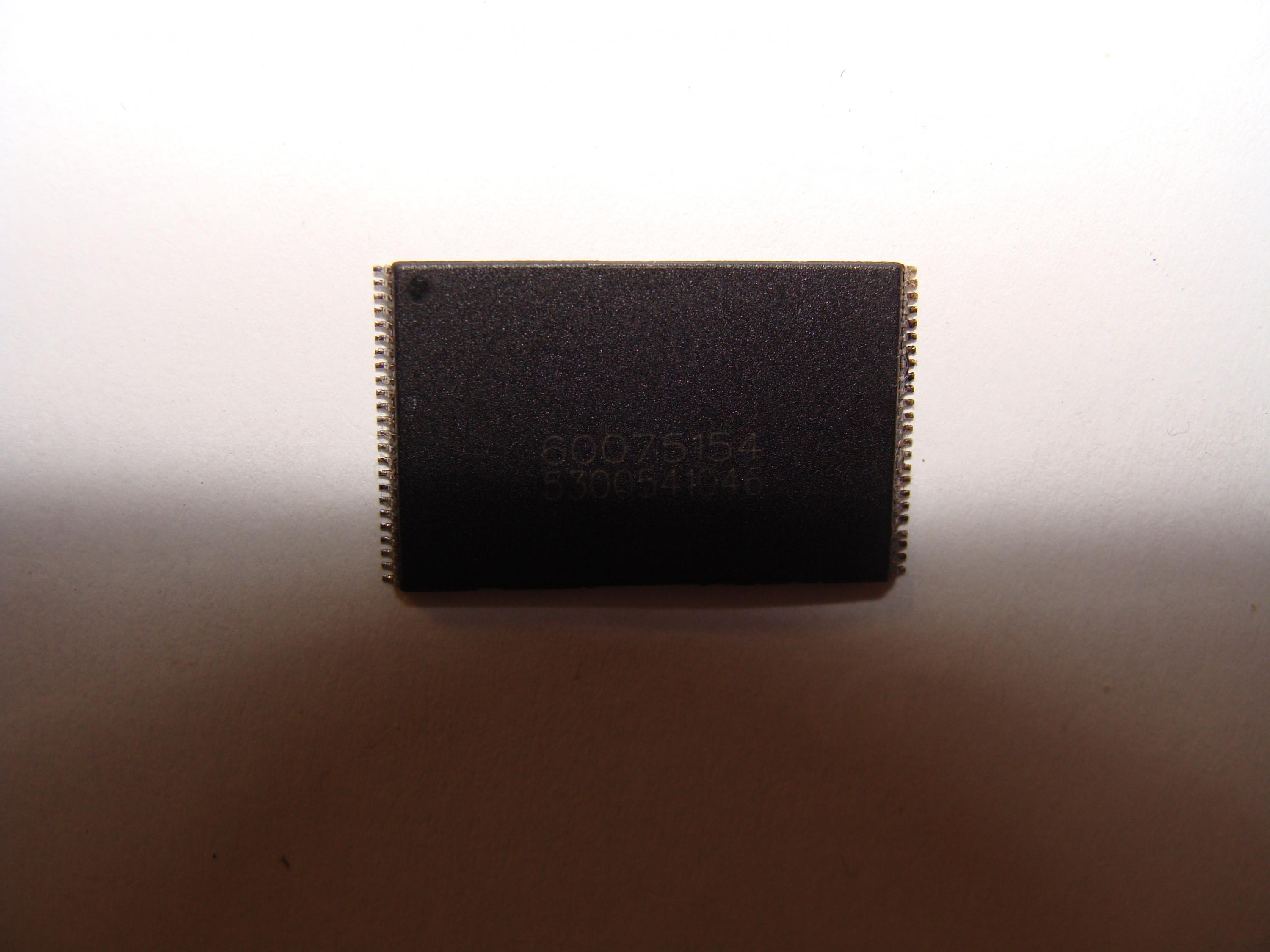

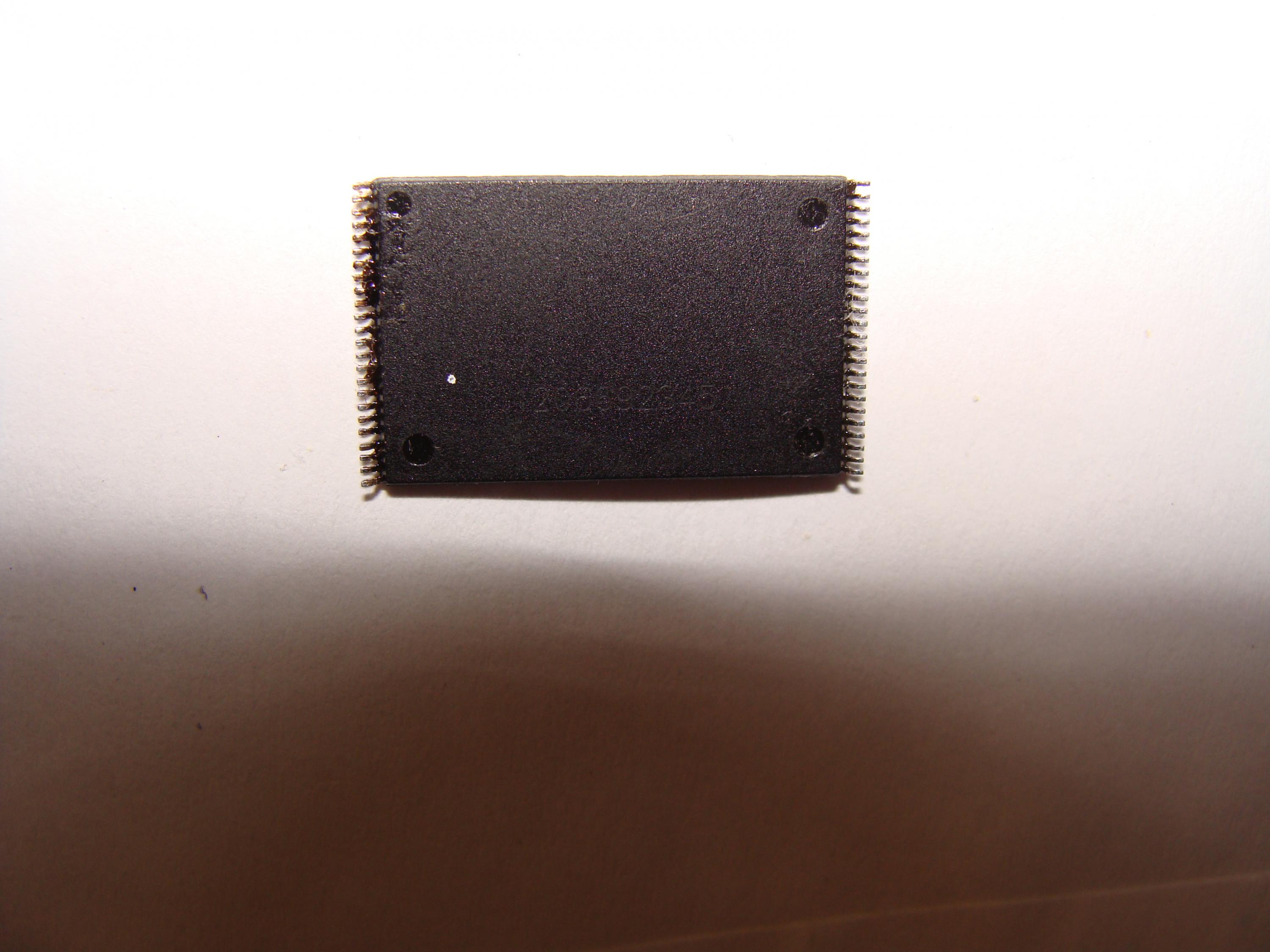

    Hi!
    I have an ADATA C-906 DashDrive 8GB white pendrive(AC906-8G-RWH).
    It's broken, but i want to identify the flash on it, to know if i can read it with an eeprom writer(Minipro TL866CS). And i also would like to know if it is possible to make files out of the raw .bin file.
    Thanks for any ideas and help!
    It doesn't have any marks...
    It is a TSOP48 package.
    The only numbers on it are the following:
    TOP:
    60075154
    5300541046
    BOT:
    1206692345

    it wont go in the minipro, it's a serial flash.

      Re: Help me identify this flash
      I have a TSOP48 adapter.
        its serial, as TSJ says. it wont work. if you can get a serial programmer and your on linux the bin file will mount as a vfat FS.
          use another usb-key or an XD-card adapter as an interface.
            First of all i would need the exact type of the flash...a serial programmer is also avaible, but the pc doesn't handle it well...this why is use the minipro with adapter.
            Other usb-key is not available...
            The type is needed to start the reading, after it is done i can move to linux.
              does the controller chip have a part number?
                Yes, it is: Silicon Motion SM3257EN
                  get a datasheet.
                  and check the usb plug soldering/contacts.

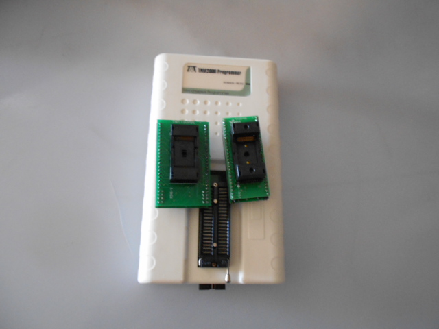

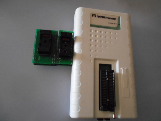

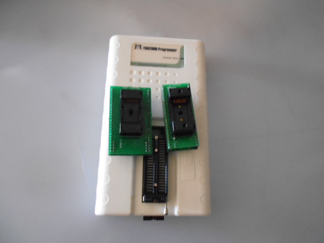

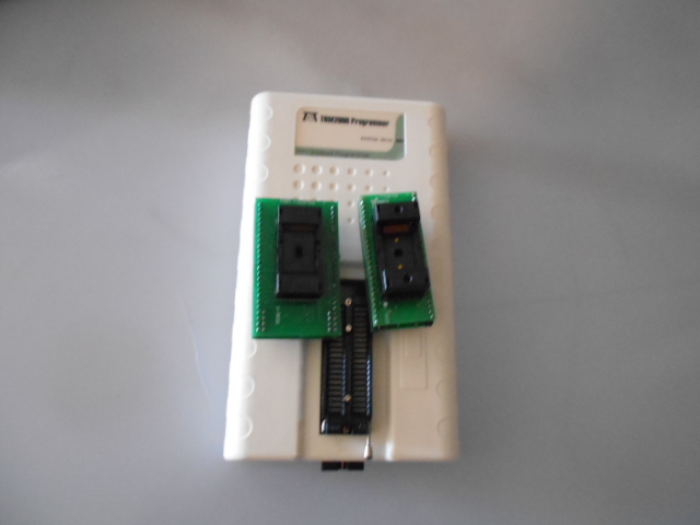

                          .........%$#%$#%$#^#%....YES i do have one(TNM2000+) very good on TSOP 48 NAND, OR gate Flash chips programmer...........^%##^%##%&.......because it's the most cheap I could found in 3 months.....%$#%$@%$.....about $180 without the adapters.......%#@%$@#@......I do have TL866A not enough chips in Nand flash they supported.......%$@%@%$@....... then go a head.....
                          http://www.ebay.com/itm/TNM-2000-USB...-/321207236799
                          http://www.aliexpress.com/store/prod...048105724.html
                          With adapter , they can do 56 & 48 pins...%$@#%$@#%......I think ...is an Indian smart person develop the tester.....%$@%$%@........ Yes, they are good at Maths
                          Tips: It's very good for..... Data recovery.....
