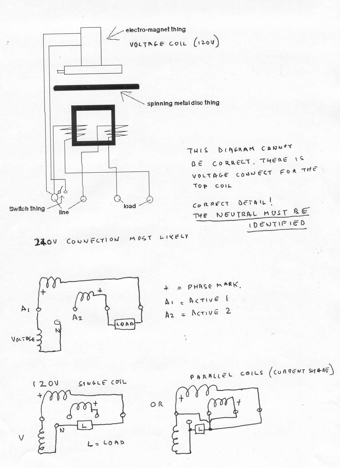

    If there is no neutral the voltage coil is not operating, no connected circuit that I can see from your diagram. Attached Jpg. Should read " There is NO voltage connect for the top coil"

          Pentium. I hope you have had enough sleep now. I would agree that some elctrical guy who actual has connection experience is your ideal source, but there seems to be no offers.
          What puzzles me about your meter.
          1. To change from 240V to 120V either the voltage coil must be tapped with three wires (this does not appear to be the case) or the current coils have to be re-arranged (the only apparent option). Current coils either in series or parallel as per my diagrams.
          2. If the voltage coil remains at 120V for a 240V supply then error can arise if one phase goes missing.
          3. Where is the neutral connection?
          I am sure that you can make it work with what has been offered. One caution is that the phasing of the current coil with the voltage coil. Try with voltage coil and one current coil and see if there is a difference when the current coil connections are reversed. If there is a better response one way use that connection as a starting point.

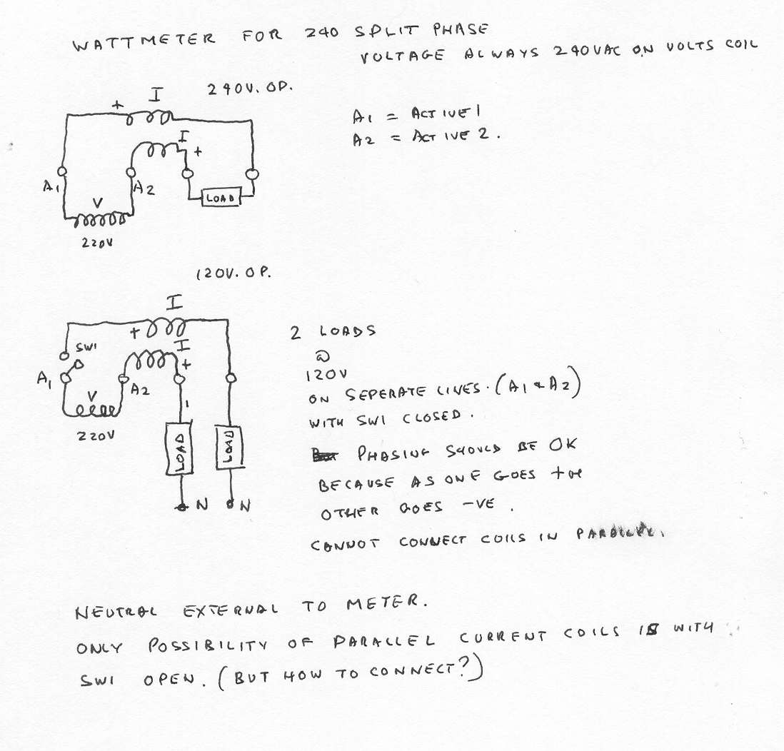

            Starfury1 sent me a PM with a 240V split system picture. The split system rather than phases is well understood. However the PM made it clear that the neutral in an external connection and that the wattmeter voltage coil may always requires 240VAC. ie the meter always has 2 splits connected. This means that when connecting 120VAC devices they will be attached to a current coil on one of two splits. Each 120V device load is returned to neutral externally. (same config as for 240 but the load is split with the centre to neutral)
            This method ensures that if one split voltage is missing there will be no meter error there will be simple zero meter operation, because the volts coil will have no current flow.
            If this is correct (it makes a lot of sense) then each current coil is rated for the heavier 120VAC load currents.

                  Thanks Starfury1. Your links confirm my second set of diagrams, last posted.I think we have it there.
                  It is now for Pentium to get connected and see how it goes.

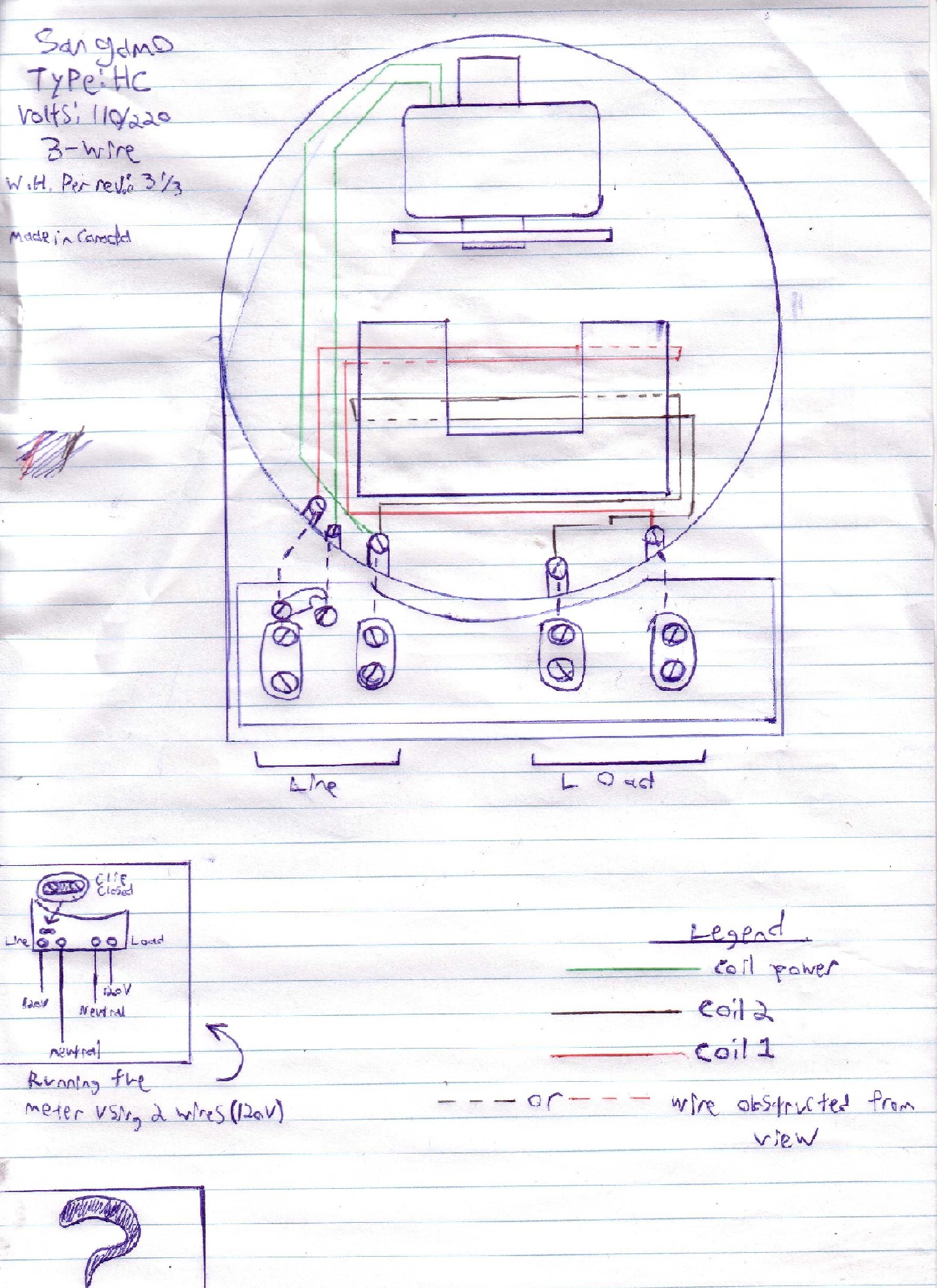

                      I completed a better and more clearly marked diagram of the meter. I wull try to scan it in tomorrow I hope.
                      I'm going to also wait until my new 20A breaker is installed. Part of the problem that I am trying to go 3-wire through a single 120V line ( )

                          If you are branching a single 120V ac line and then trying to get the meter to monitor both branches I don't think it was designed for that...you would have to put it before the the split as per 120V hook up
                          (as I was thinking was the case before)
                          It might be doable but not really sure
                          "Do not" used the above hook 3 wire 240V, it won't work!
                          rethink time

                            The problem is that the meter is designed for 240VAC on voltage coil.
                            Could try 120V on coil and use one current coil. Theoretically you would get half the wattage reading because voltage coil field is half.

                                      Here's the sketch I made. I also color-coded the wires.

                                        Thanks for the diagram, it will help me understand how it was setup
                                        what I meant was at some point they will *tie together....from what you say it seems both circuits are individually being brought out from the box. that being the common point (box wiring).
                                        (*or to the individual Actives + or - in the split phase case)
                                        Sorry pentium I think your out of luck with what you what to as far as using it on both circuits unless you put a sub board in for those two circuits
