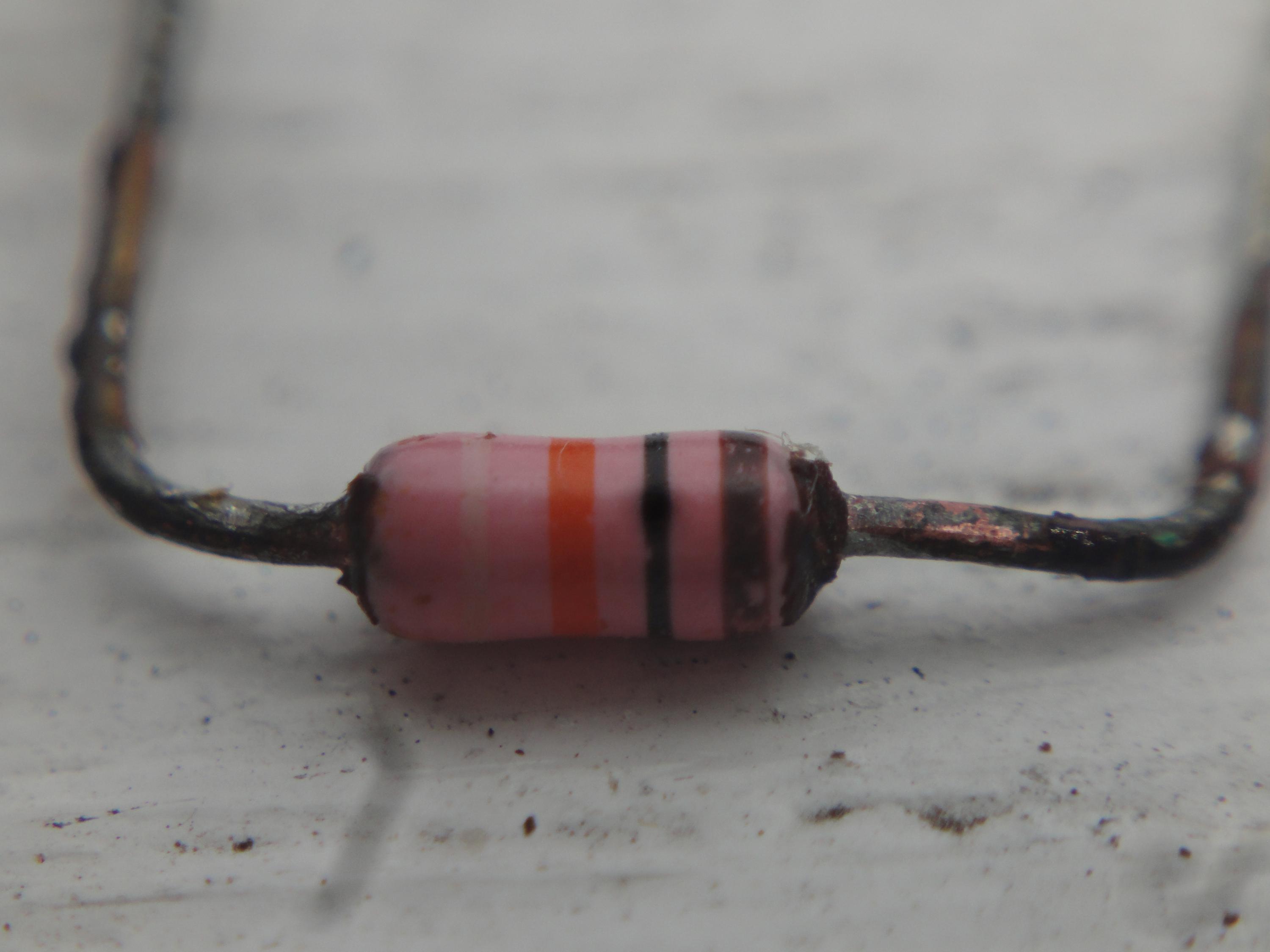

    I have a ceramic capacitor that I wish to read the value of. I can't do this because it's covered in evil glue which is obscuring the markings. Also I do not trust the glue to not interfere with measuring it on a capacitance meter.
    Is there something I can dissolve the glue with that will hopefully not remove the paint from the capacitor as well?
    I normally scrape the glue off with a blade but that is not really an option here.

          For the corrosive glue Sansui used to use I remove it with acetone. It has taken the printing off of newer capacitors though. On the old Sansui's I really don't care because I'm in there to replace them anyway.

            heat it up to 120deg c it will just peel off then

              acetone or xylene.
              if you go xylene - do it outside, that stuff will damage your brain!!
              also, know that you can melt plastics and remove paint with these - you WILL take the stripes off resistors for example.

                A lot of the times the glue is chosen such that any solvent used will also dissolve the electronics underneath. Pretty much only mechanical removal is the only option, if heating it doesn't help.
                I would at least try carburetor cleaner, if you don't have VOC regulations near you, methylene chloride in the "cheap" formulation is a good solvent too, for nonpolar materials. Else acetone in the VOC regulated formula also works. Both these can eat some types of plastics.
                Need to determine what kind of glue it is - that's the underlying problem. I haven't found anything that dissolves set epoxy...

                            I decided to try this idea first as being the least messy and least likely to remove the paint as well. I used my hot air rework tool on lowest (160°C) and pulled the glue off with tweezers. Worked very well, no damage to the capacitor.
