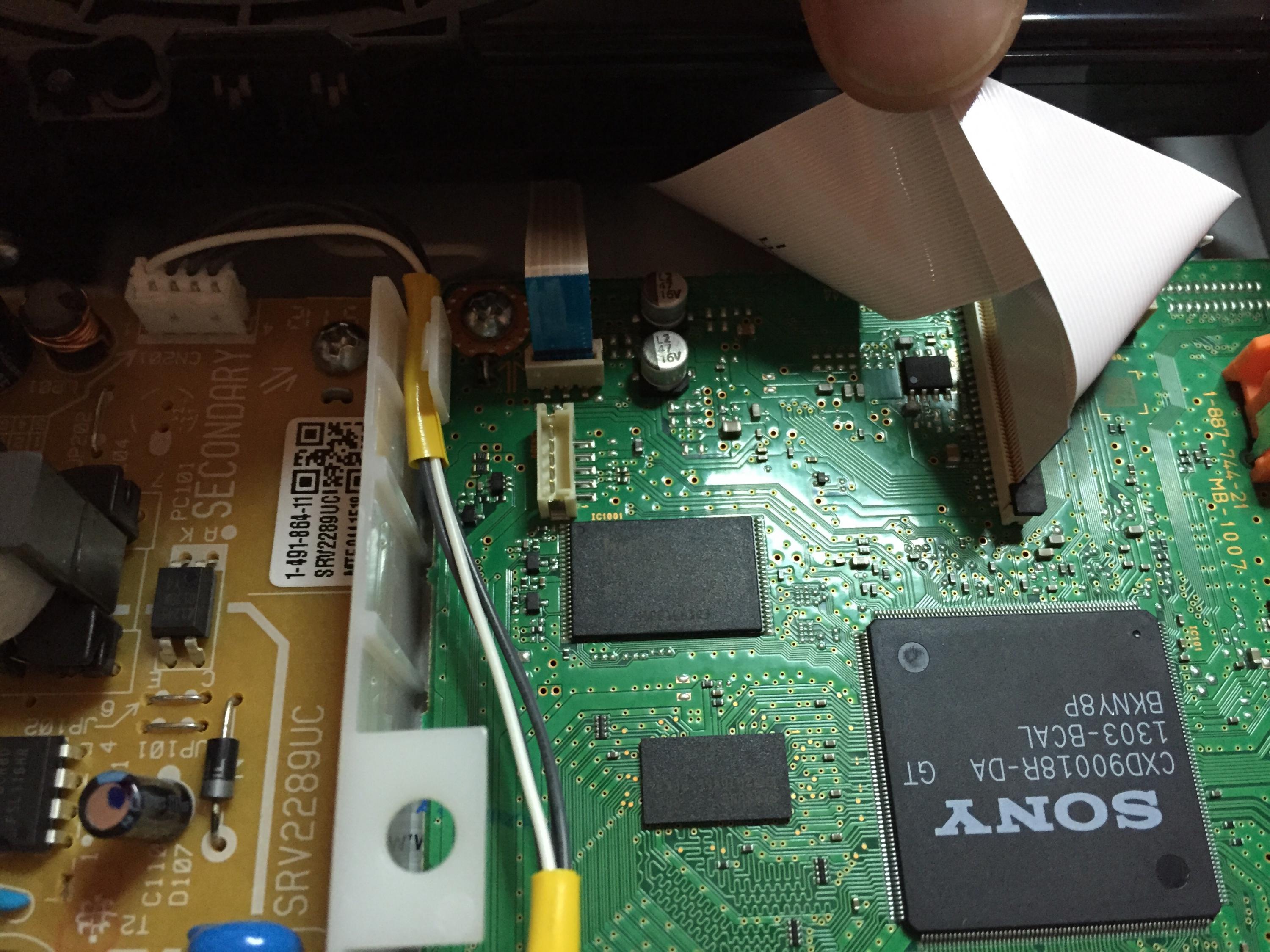

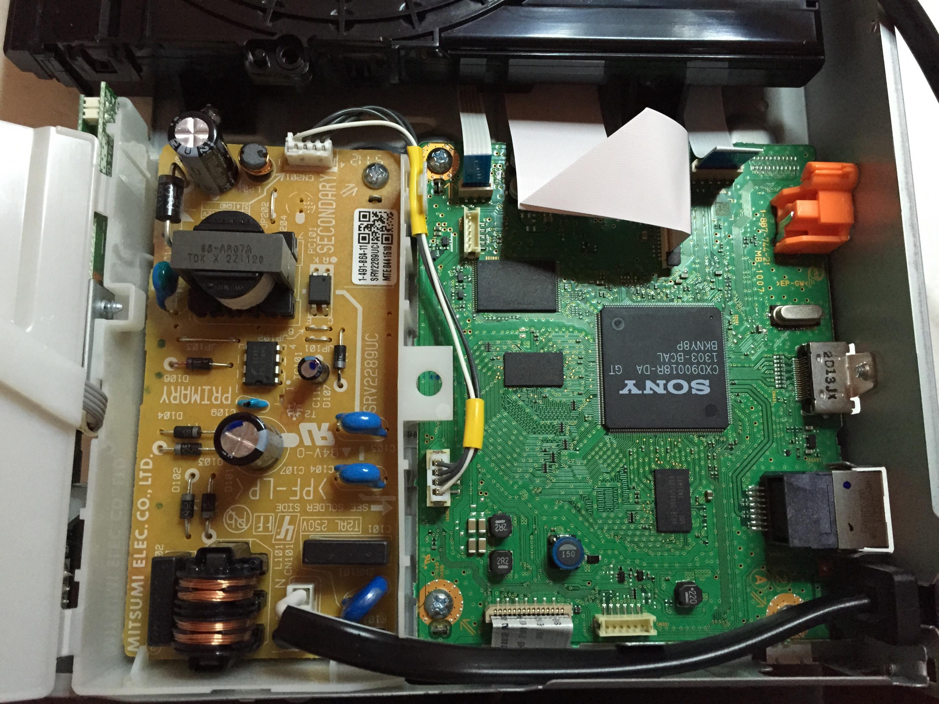

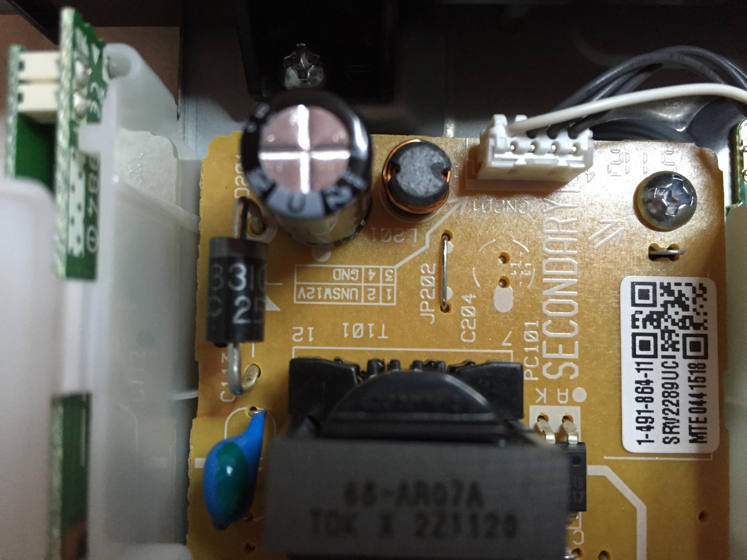

                      Re: Sony BluRay Player - Locks up
                      Here are some pics. It appears there's always two 12v present with unit on or off and they're both present and don't waver.
                      I measured voltage at the + side of the two smd aluminum caps one is 5v and the other 12v, they might be for the bluray drive though considering their location.
                      Not sure where to proceed from here.
