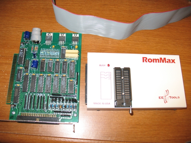

                    I've got an EETools RomMax that is designed for use with PC's up to 166Mhz (Needs an ISA slot). I used to use it for programming BIOS chips back when they were socketed, but it has been sitting around for years now
                    I'll see about posting a pic of it when I get home. I'd let it go pretty cheap if someone can use it. Only problem is you need an old DOS computer cause it won't work in Windows.

                      Re: Reusing EPROM's
                      Here's a rom programmer. This is just a little one, they get much bigger and more expensive. Up to ~$10k or so for a full featured setup that can program anything under the sun.
                      Newer ones are USB, or at least paralell port. This one uses a dedicated control card and can only program up to 8 meg 32 pin chips.

                        Re: Reusing EPROM's
                        That's just like what I want.
                        Quick connect AND isa-based interface.
                        You must of paid a pretty penny.

                          Yeah Maxx thats the type of thing I had....it was dos based.
                          Think pentium probably has an old box that could handle it

                            I tried to sell the RomMax a while back and couldn't get $25 for it It cost about $200 new I think.
