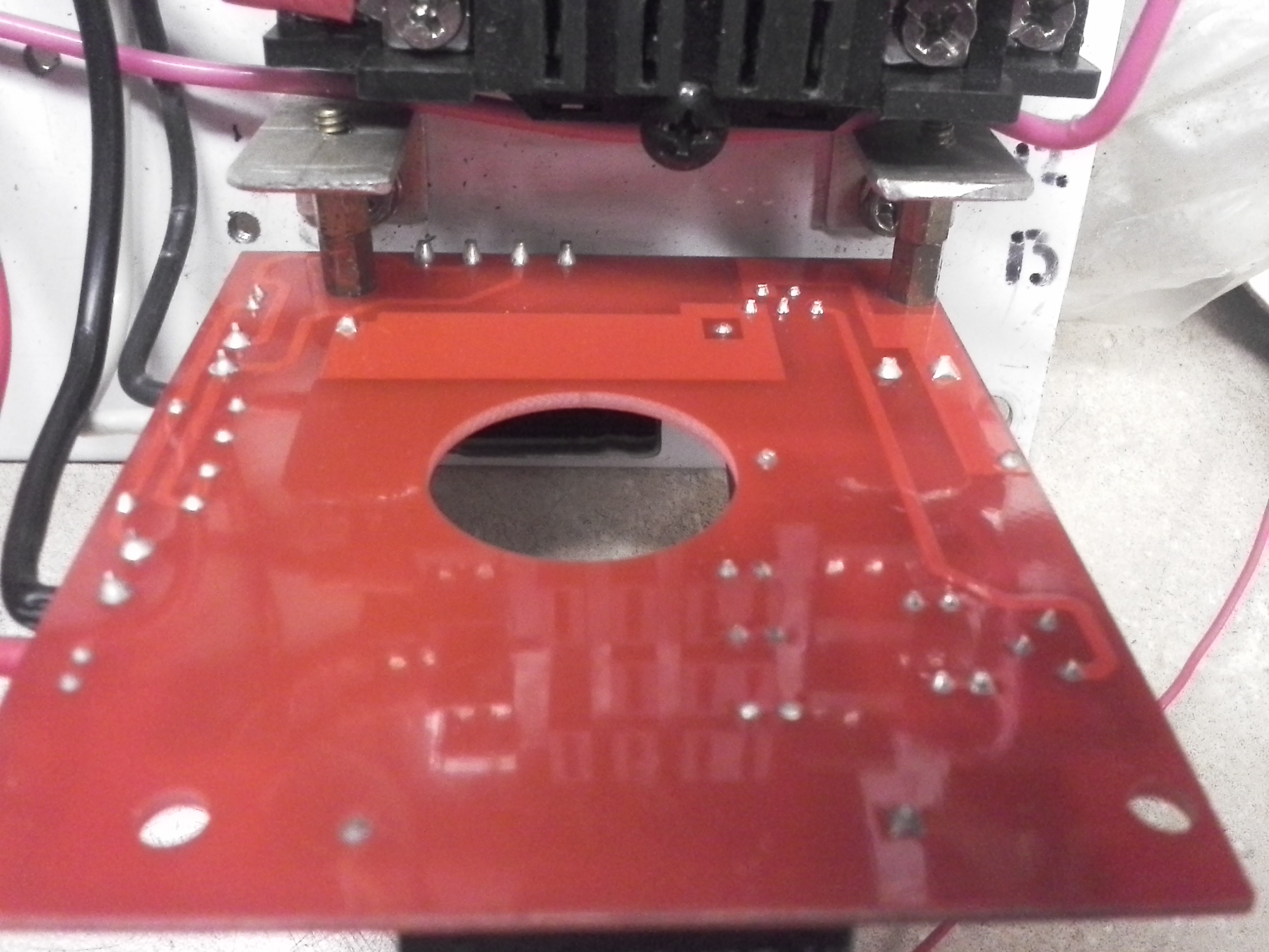

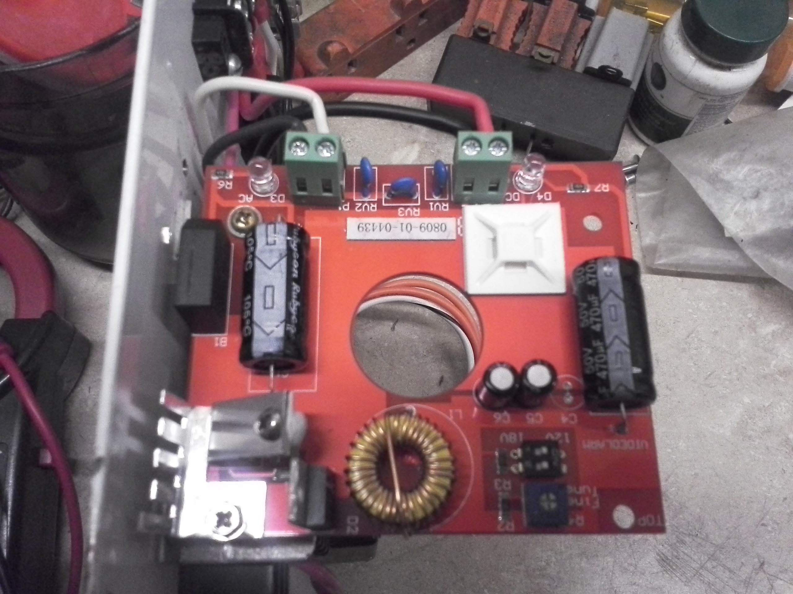

          I have photos, but I don't think you're going to find any information on it. but at least you'll see how the circuit is. I didn't want to remove it from its platform since my dad worked hard on it.

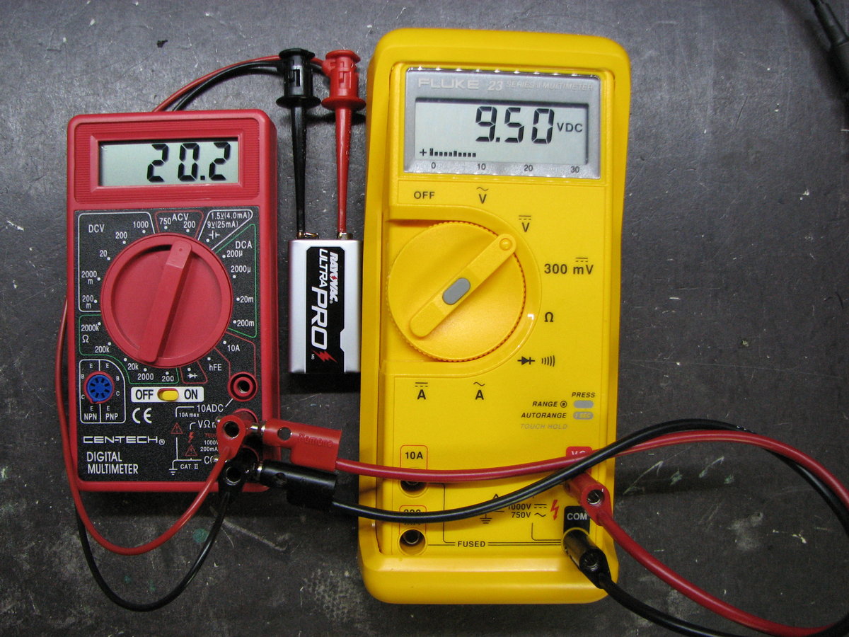

              May I ask what kind of multimeter you are using to measure this?
              The reason I ask is that many less-expensive multimeters use DC coupling for the AC voltage ranges (ie. no DC-blocking input cap.) This causes the meter to give a non-zero reading for any positive DC voltage applied while the meter is set for ACV. Due to the scaling used for AC, the reading will be about twice the DC input. Negative DC voltage will give a zero ACV reading however, because the meters use a single diode as a half-wave rectifier for AC.

                What I am getting at is that I'm getting a reading that I shouldn't and modemhead might be right it might be my DMM.

                A piece of shit cen-tech. I did have a fluke, but it got stolen along with few other tools, acouple years back.

                  I have a cheap GB Instuments meter that will read 3v from a 1.5v D cell on AC setting, however polarity doesn't matter to this meter so it must have a full-wave rectifier.
                  My better Mastech meter doesn't do that. It'll show a small voltage that quickly goes down as the DC de-coupling cap charges.

                    Measure a 9V battery with your DMM set to ACV, red to the positive battery terminal, black to the negative. If it reads 18V or so, it's the meter. If you switch the leads around, it should read zero.
                      Yep it was the meter.
                      I have another meter called Excel that was gifted to me by badcaps member mariushm, and it reads 0 on AC. I retested the board it reads 0 now. So I guess it's the crappy cen-tech.

                          Looks good. So the "Simple Switcher" 12V output feeds the delay, which then feeds the strobe for the fixed period.

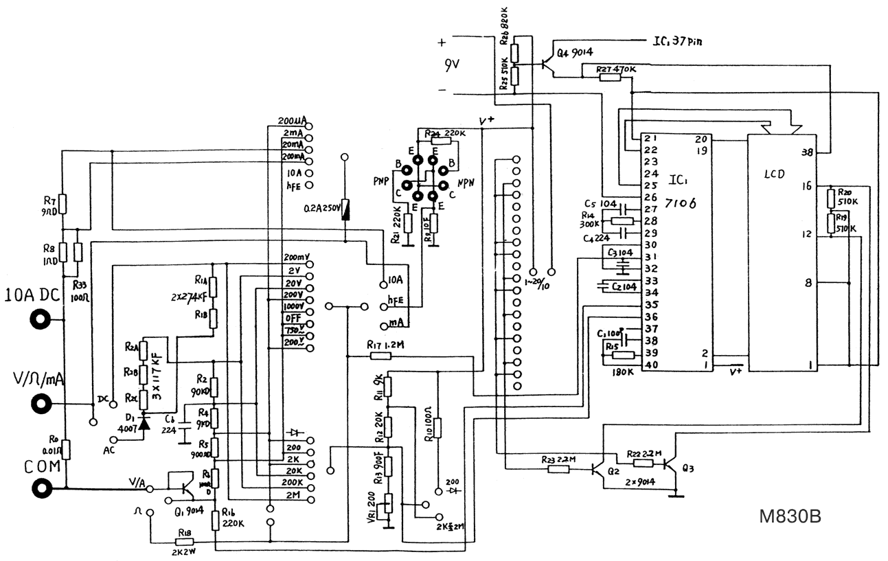

                          See the 830 schematic. It's obvious why/how those meters read DC as "AC" with the leads one way.
