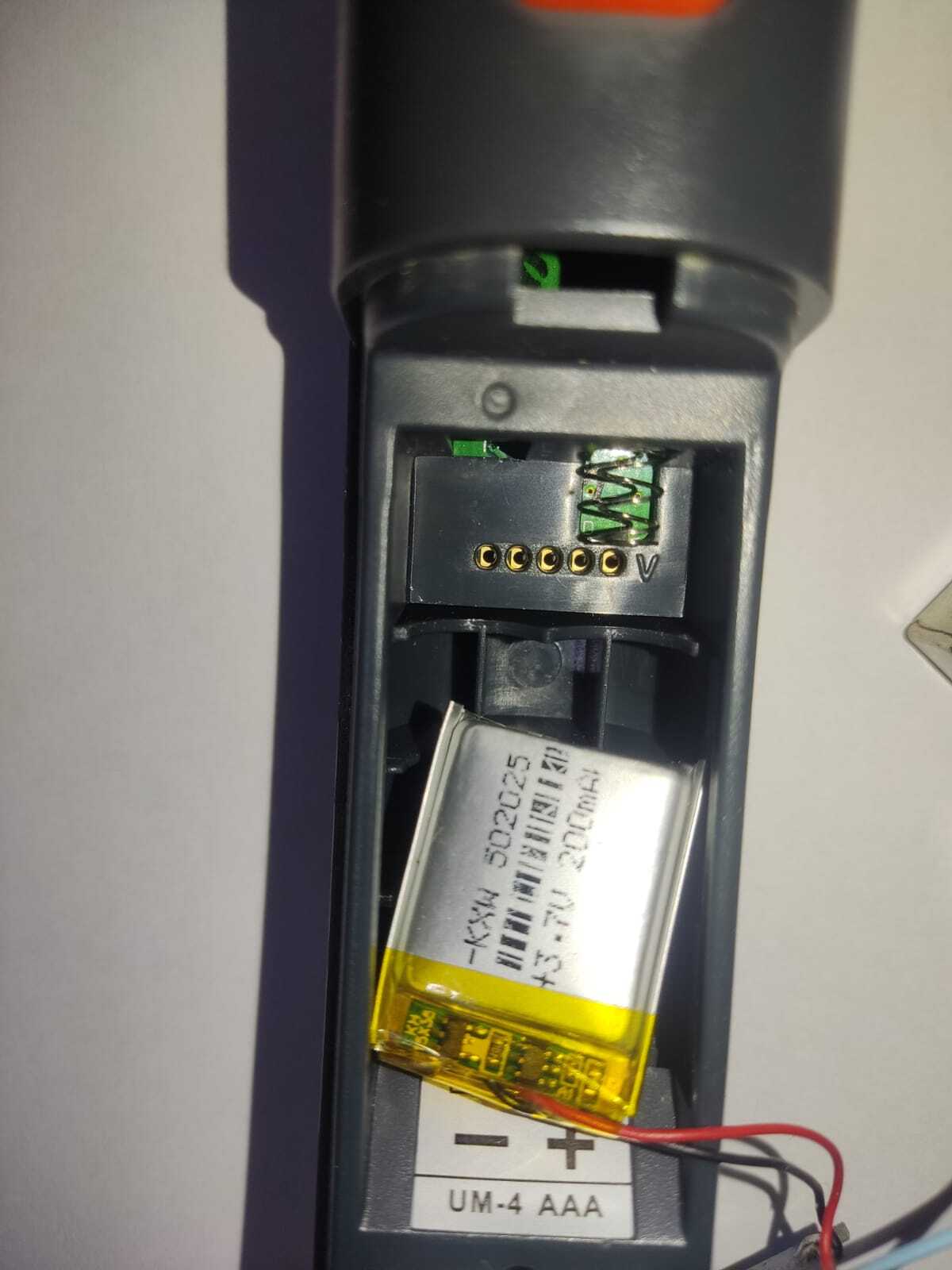

      A 18650 wouldn't fit, I'm thinking more about a small lipo cell like this, it needs to fit within the space for 2xAAA
      I could charge it with a TP4056 board, the remaining space would be for the voltage regulator
      About Lifepo4, I can't find those anywhere in the local shops, only regular 18650 li-ion and those small lipo cells of different sizes and capacities
      I think a 10440 lifepo4 would fit, but can't find those locally
      Importing those, they're classified as "dangerous goods", but a device containing lipo batteries is fine

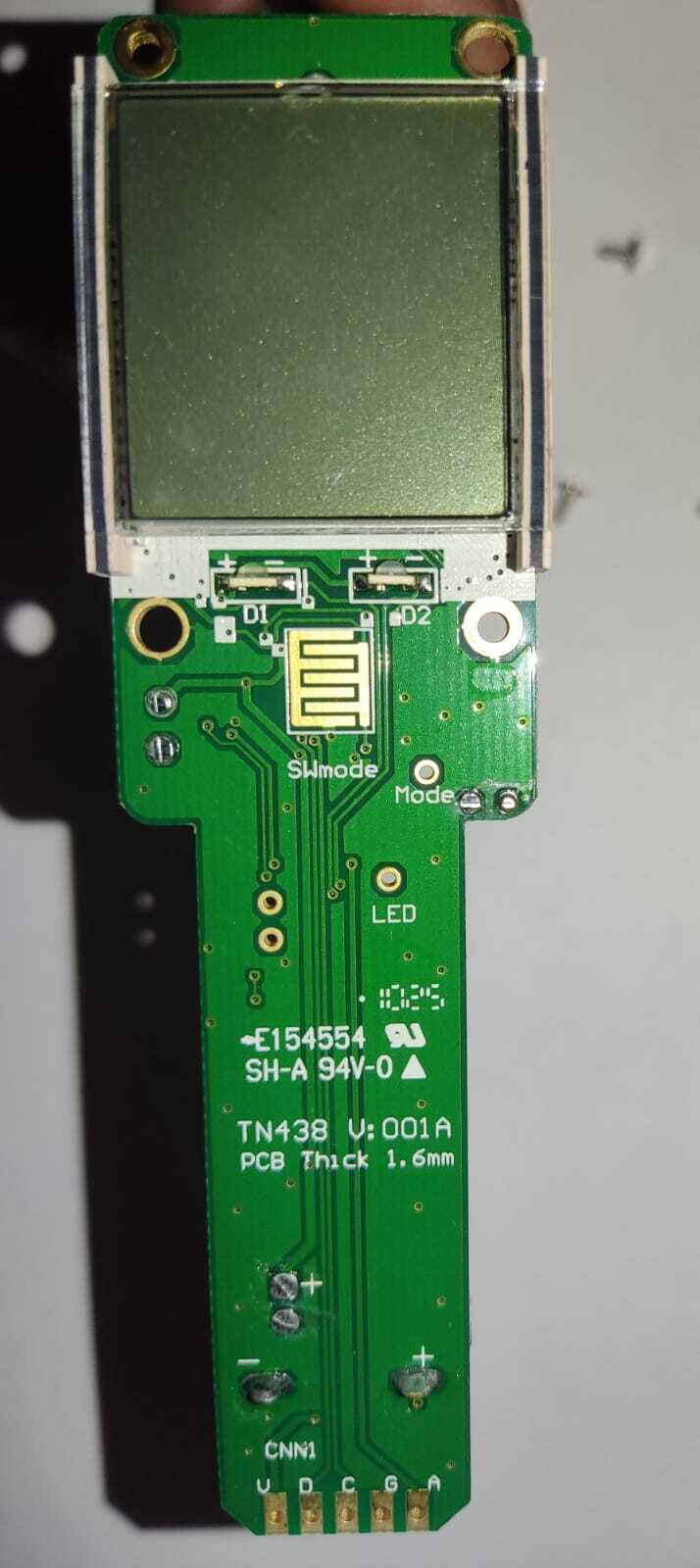

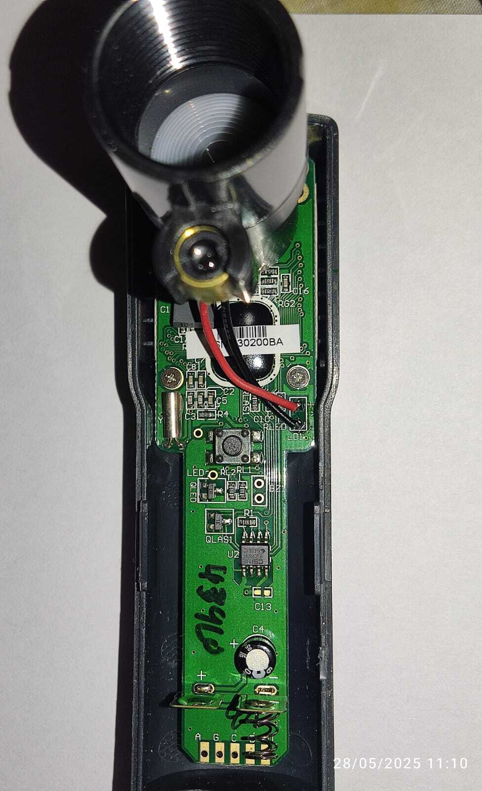

            You guys want pictures of the inside, so here they are:
            Only interesting ICs are:
            - 93c66 EEPROM
            - The main blob IC
            - There's a header for calibrating it seems
            The battery terminals go to a nearby 100uF cap, then go somewhere else on the bottom layer of PCB

              Pictures of the lipo cells I have, the bigger one fits on the battery compartment with some space left

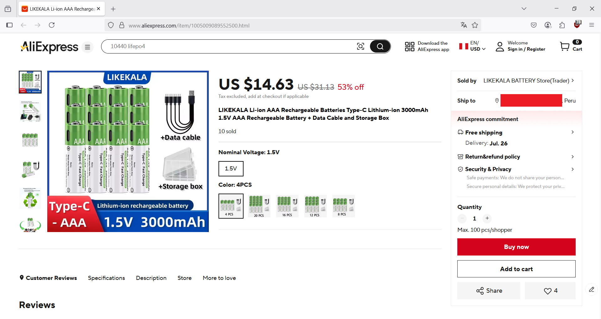

                  You mean those? https://www.aliexpress.com/item/1005009089552500.html
                  I doubt the claim of "3000" mAh, i'm guessing more like 300mAh, aliexpress claims free shipping
                    The website link is not valid unfortunately

                      sam_sam_sam Works for me
                      Click image for larger version  Name:	Captura de pantalla 2025-05-28 203642.png Views:	0 Size:	567.4 KB ID:	3647823
                      EDIT: On my phone it opens the aliexpress app
                      EDIT2: Amazon link for similar batteries, they have a type-c port on one end, unfortunately for me amazon doesnt ship those to my country
                      https://www.amazon.com/CARDIENS-Rech...dp/B0DFMQ2ZLB/

                        Look for some other ones, that's definitely not 3000mAh.
                        I'd probably take the batteries out of devices that leak a significant amount of energy and only put them in when needed...
