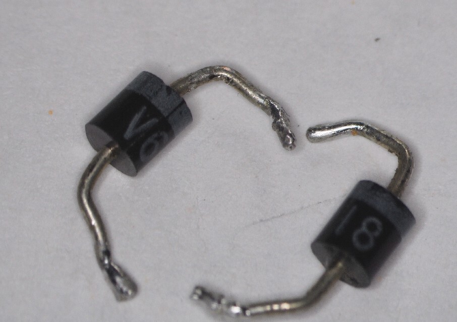

    Hi there, looking for a compatible replacement for a diode type labelled "V6 18" from a dead Panasonic plasma TV power source. Possibly a V6 600 volts diode as seen here: https://electronics.stackexchange.co...nt-diode-v6-88 ?
    Thank you

    Check this out:
    https://www.ebay.com/itm/275482477752
    They claim it is a TVS diode. Verify the circuit where these diodes came out of. You should be able to figure out if it is a 600v rectifier diode or a TVS diode. A TVS diode is just there for protection.
    If the circuit is a high voltage rectifying circuit, just find the fastest 600V 2A diode that fits.
