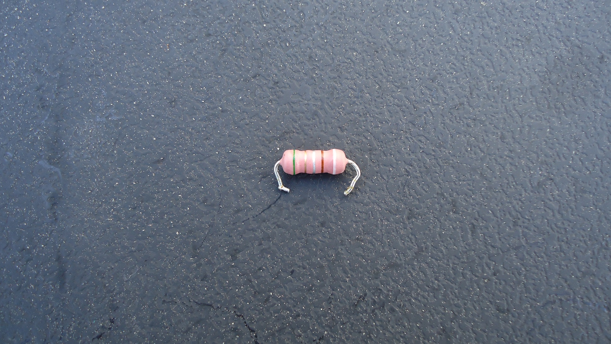

    I have this resister it calculates to be 91.8 ohms with the digi key calculator. My dmm gives me a value of 0.9 with the rel option on. My meter is a extech 470 model with a fresh battery. What is the right value ? Thanks for any help.

    I think you have the resistor placed incorrectly. It should be white,brown,silver,gold,green, which gives .91 ohms with 5% tolerance. Used the calculator below:

      first 2 stripes are 91
      dont know how silver translates to 8 unless the foto is poor.
      if it's gray it's 8
      so i also make it 91.8ohm and 0.5% tolerance.
      if it is silver,
      then 0.91ohms
      but then it doesnt explain the gold band!
      unless:
      it's 0.91ohms
      and 5% tolerance (the gold)
      and 20ppm temperature coefficient.

        Its white, brown, gray, gold and green I think is the manufacture code

          That is the calculator I used. comes out to 91.8

            That gray/sliver line is silver .. So the value is .91-5% My eyes are getting old. Thanks for the help.

              looks like white, brown, silver, gold, to me, and that makes your reading of 0.9 ohms correct,

                that maybe a yageo
                the green line means it is flameproof and Non-inductive
                (around 6.3mm long would be a NCR50S)
                (around 9mm long would be a NCR1WS)
                (around 11mm long would be a NCR2WS)
                looks white brown silver gold for .91
