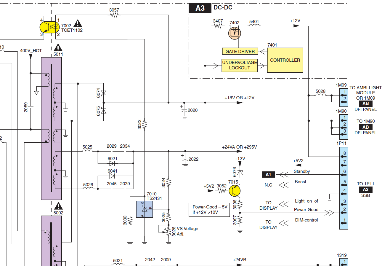

    So I got a 42" Philips, (42PFL7422D/37) doesn't turn on, throws a blink code of six follow by three fast blinks. Either it's error code 6 or error code 63, I can't tell.
    Anyways probing around the board, it appears pin 8 of connector 1P11 doesn't have 12v, now reading the photo below I want to assume 12v is coming from the DC-DC, is this correct?
    if so then I'm not getting any voltage as far back as 5011 transformer for either 12 or 24v.
    I also hear the relay click and have +5V2 at pin 7 of 1P11 and 3.7v at pin 6 which engages the relay.
    no voltage at pin 2 (Power-Good)
    Also how can I test for 400v_HOT at the transformers to make sure they are getting power?
    datasheet for the TV.

    what a train-wreck of a psu - it looks like the crap samsung comes up with!
    scope the primary transformer pins - with 600v+ probes!
    or check the high and low side fet's for shorts (page 59)
    if they arent shorted try replacing the opto isolator & current source lm431.
    they dont call it an lm431 - but that's it's generic part number.

      I'm a noob but where are you seeing current source lm431? I know it's not named like that but where are you seeing it? is it on p59 or another page? I'm looking for the symbols but I don't see it.
      Also which opto isolator there's 7002 on p59 and 7307 on p58. I think you meant 7307, I'll look into it.

        follow the optoisolator led pins - it's halfway down on the right and looks like a zener diode in a box with 3 legs.

          ah, you're talking about 7010 (TS2431.) I thought that as a box with a diode in it, I'm really tired.
          Thank you, I'll take closer look at these and check the transformers tomorrow.
