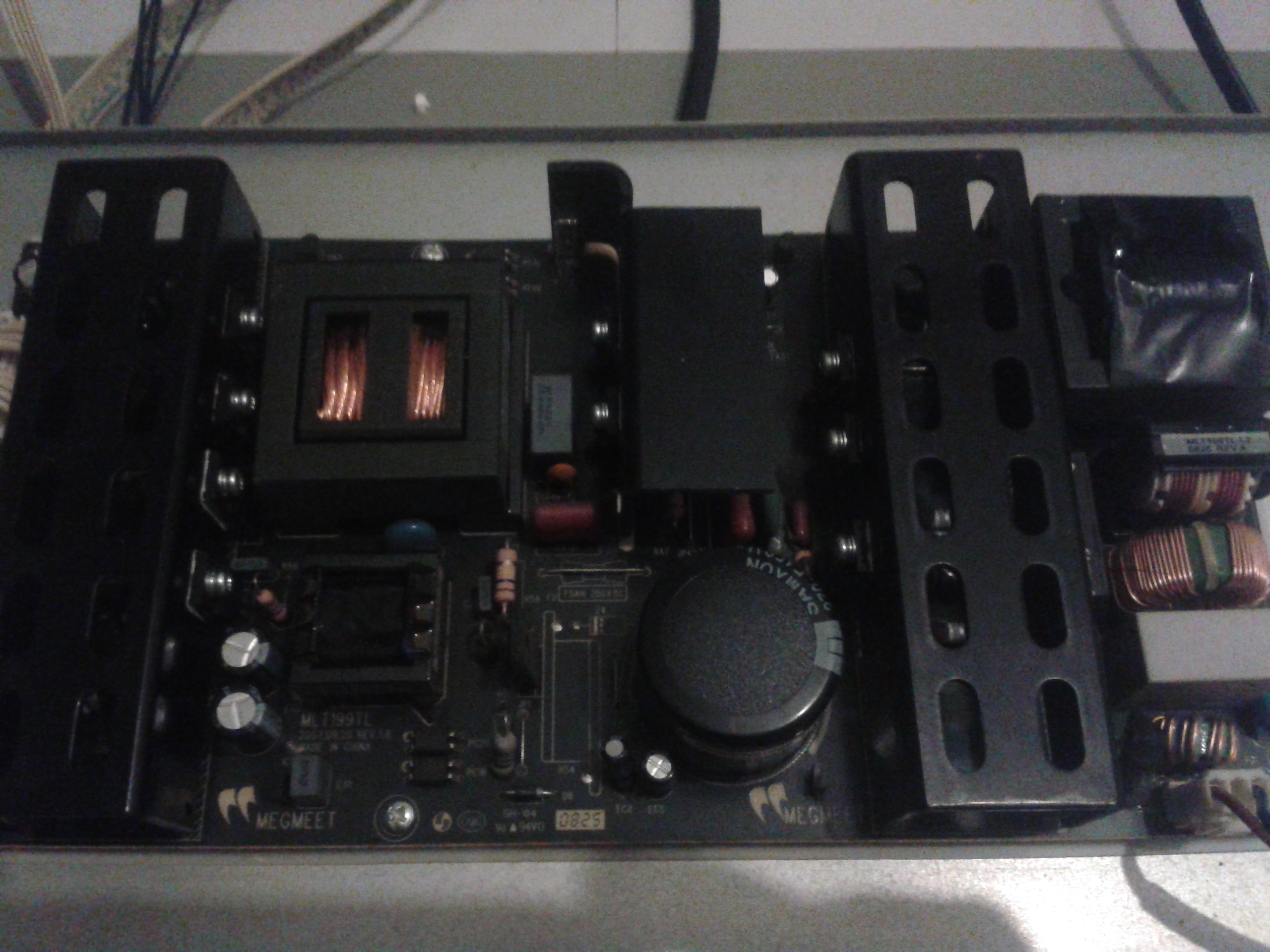

    hi guys tryin to repair a Megmeet MLT199TL Rev1.8 PSU for a 47 inch tv. i have replaced all caps and still no power. i typed model number into ebay and apparently this cap is the one that needs replaced:

    Pic of your board and the coupling capacitor (the 68nF one) can be highlighted, it is usually near SMPS transformer.

        not sure what it is im looking for ??

          Probably wouldn't fix no power fault at all, the coupling cap is usually only used for main outputs. Check Vcc for standby IC, all fuses, output diodes for shorts & try listening for ticking sound.

            The capacitor is probably that little grey box wedged between the heatsink and topmost transformer.

                @clown, im sure with this i ended up replacing the power supply.
