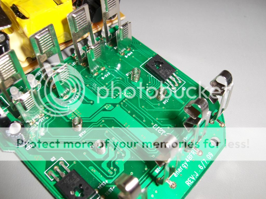

    My Ansmann energy 4 started arching and smelling strange last weekend while charging 4 AA batteries, having a look inside made me think Ansmann bought it from a very cheap Chinese factory.
    Nerver heard of Samcon, Natcon or Chang capacitors before, Ansmann for sure saved a few bucks buying low quality parts.
    The to220 heatsink looks like a mess.
    One of the springs has come loose, springs are used instead of soldered wires to connect the powersupply to the wall contact.
    Even though these springs sit stationary it has somehow come loose,they do not move even when changing wall contact type.
    Also, look hook how dirty the board is.
    Lots of flux left, buying Ansmann you don't get cleaned boards.
    This is the spring that caused arcing.
    This picture show better how dirty the board is, it looks like 'fine sand' that is stuck in the flux residue.

        It really doesn't look that bad. yes, the capacitors are so-so, especially that 85c capacitor, but otherwise the layout looks good, they use nice components, current sensors for each battery, good microcontroller.
        The spring can be replaced with a wire.. just scrape the insulation over that copper trace and solder a wire.
        The "dirty" on the boards is just flux that wasn't cleaned properly.
        I'm puzzled about that lead that goes into the heatshrink of the fuse... what's the lead for, what component, where does it go?

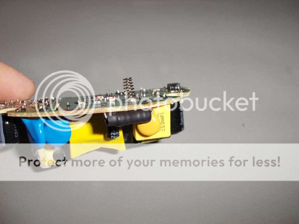

          Re: Ansmann battery chargers - cheap Chinese junk or German quality ?
          It is the lead of the spring, the two springs are used for making contact to the AC PLUG L and N. He should check and see if that fuse is still good.

            Yes I don't like the springs.
            Also, in a short circuit or overload, the springs could heat up and cause a fire hazard, along with the fuse's cover being poked by the spring lead.

              A few more pictures
              Spring lead is almost touching metal end of fuse on the right side in this picture.
              Fuse still ok.

              budm is spot on, the lead is the spring end - took a few more pictures for you to see.

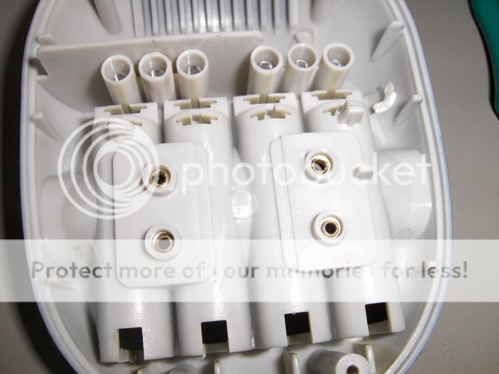

                      For charging 9V batteries Ansmann uses these 4 springs that connect to ..
                      ..these
                      ..so you can fit batteries here.
