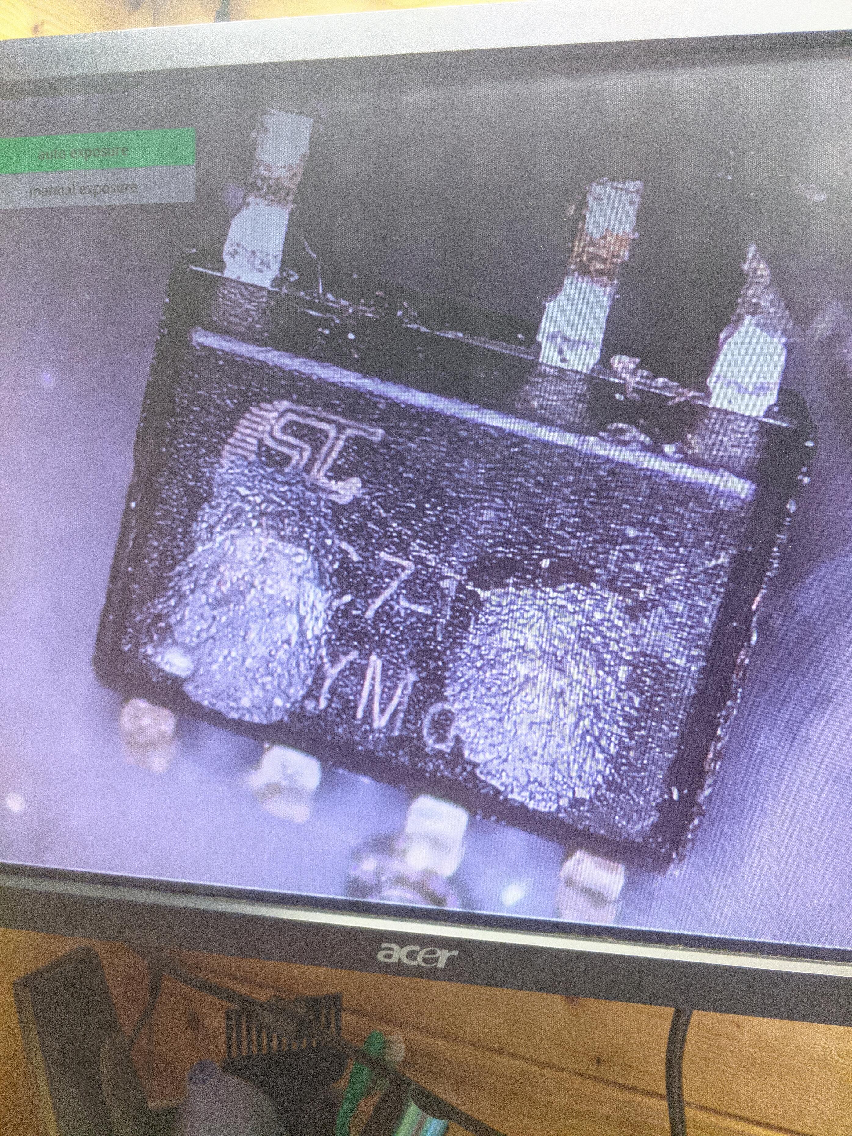

    Can I ask you guys help me identify this godforsaken component?
    I'm tearing my hair out finding this component.
    The board is from an egg incubator.
    i got it with a "popped cap" while there are many damaged components on it, which got succesfully identified with one exception:

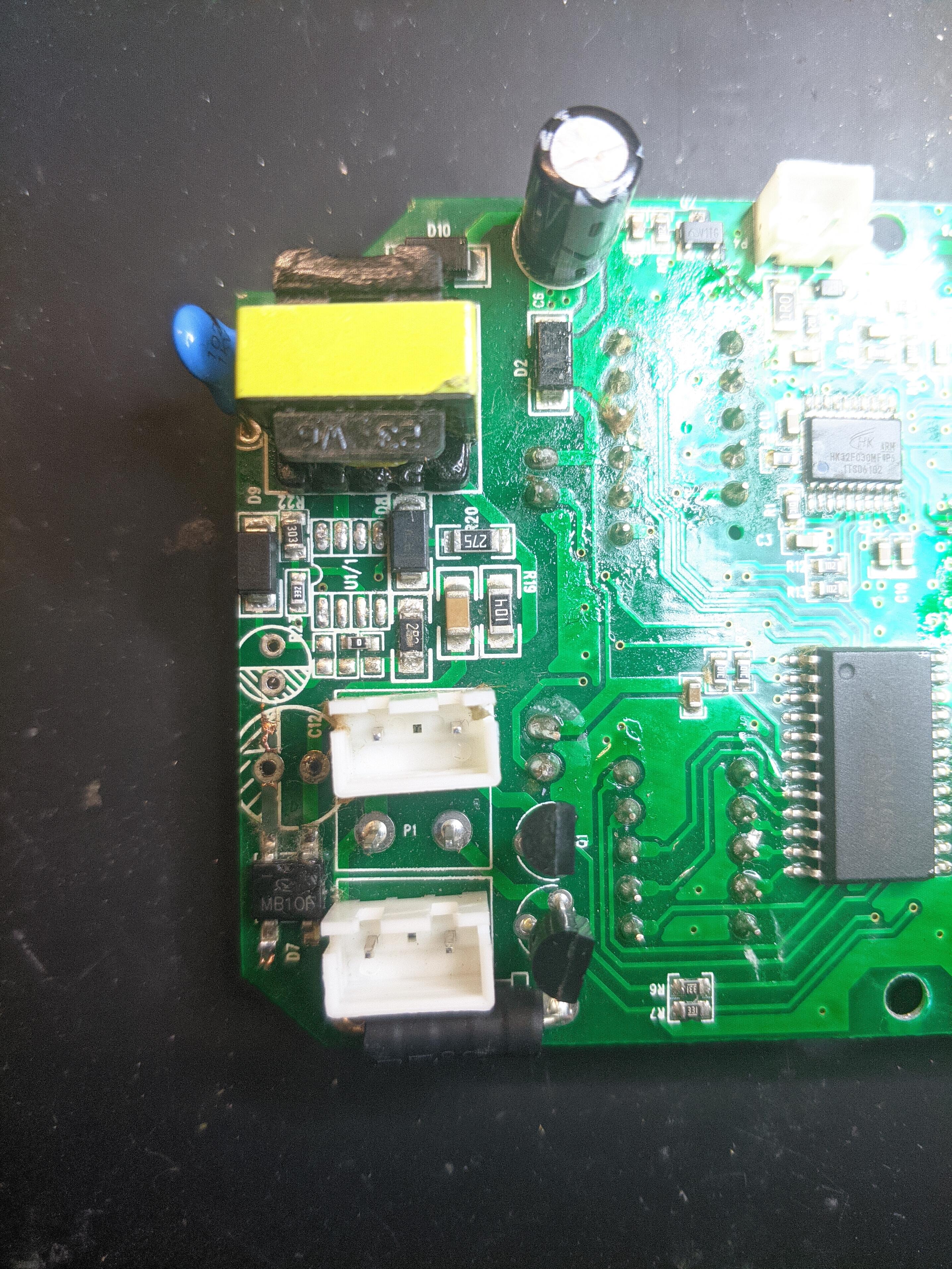

    And here is the board where it came from (U1/1):

    As you can see, the IC is badly damaged. Only a few characters are visible and a unknown by me manufacturer logo. Also it has 3 pin on the top side.
    Can you please help me find out what is it?

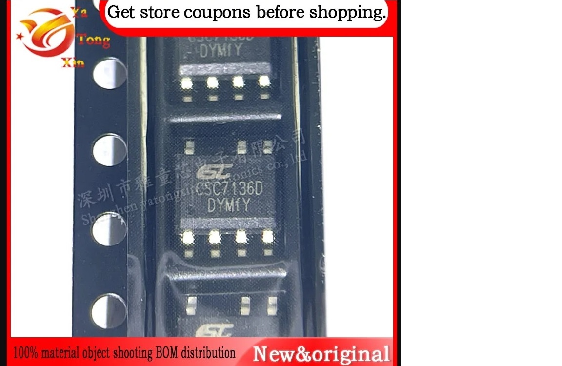

    The manufacturer is Crystal Source Microelectronics.
    Datasheet for CSC7136D:
    https://dfsimg2.hqewimg.com/group1/M...vXAKmCs236.pdf

        st micro

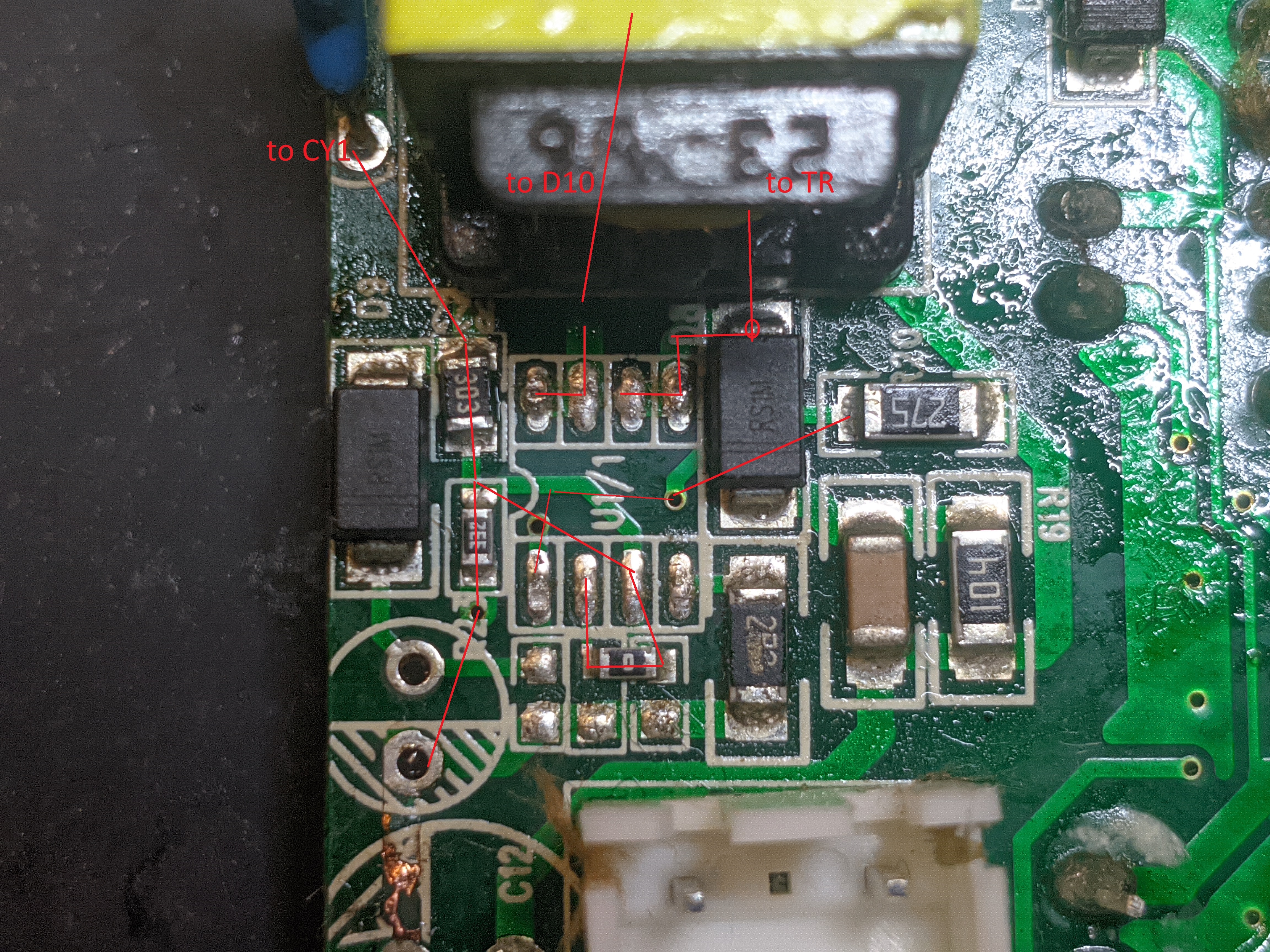

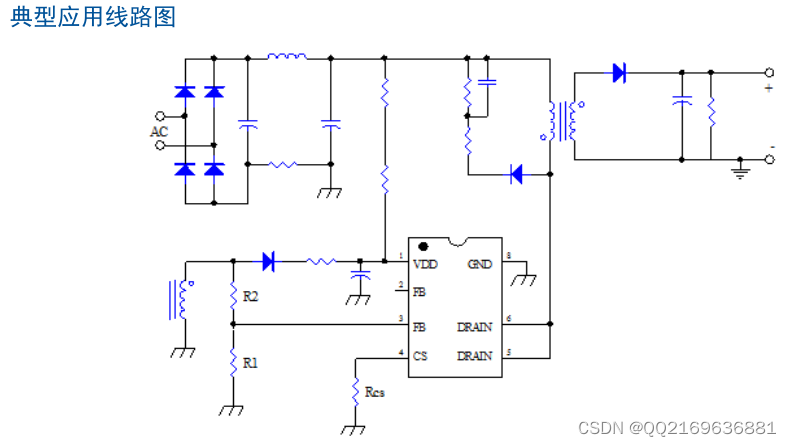

          These IC's are in-country copies of real parts. It's not ST, it could be "SC" or "STC" the S is for Shenzhen. Most SOP-7's have pin 3 missing but here it is pin 7 which narrows it down.
          Looking at the circuit, closest IC PN8370SSC matches pinout and primary-side voltage sensing but it's too much at 18W.
          OP's board the sense-resistor on pin 4 is also blown.

            PN8366 is rated for 6W loads:

                It could be this, CSC7136D seems to be the same pinout as the pn8360

                      What about the blown sense-resistor at pin 4? Maybe "2R2" marking? gives 227mApk I think.
                      • unimatrix93
                        • Oct 2021
                        • 343
                        • Magyarország
                        Yes, its a 2K2.

                              The fuse is next to the plug in the heatshrink
                              • redwire
                                • Dec 2010
                                • 3910
                                What pic is that in? I can't see any heatshrink in the posted pics.
                                • CapLeaker
                                  Leaking Member
                                  • Dec 2014
                                  • 8150
                                  redwire I think RJ means the first post second picture, very last plug on the bottom. Below it there is black something.

                                        So after the IC arrived from China I repaired the damaged traces and proceeded to install the IC.
                                        The test resulted in a glorious explosion and the 2R2 resistor blew up also burning off the metal side of the ceramic capactor. The bridgerectifier (B1000S05) and the fuse (250V/10A) also died.
                                        The explosion happened after holding down the power button for a few seconds.
                                        What could cause this issue? I did not connect the other parts to the PCB like the motor and fan, only the main AC.
