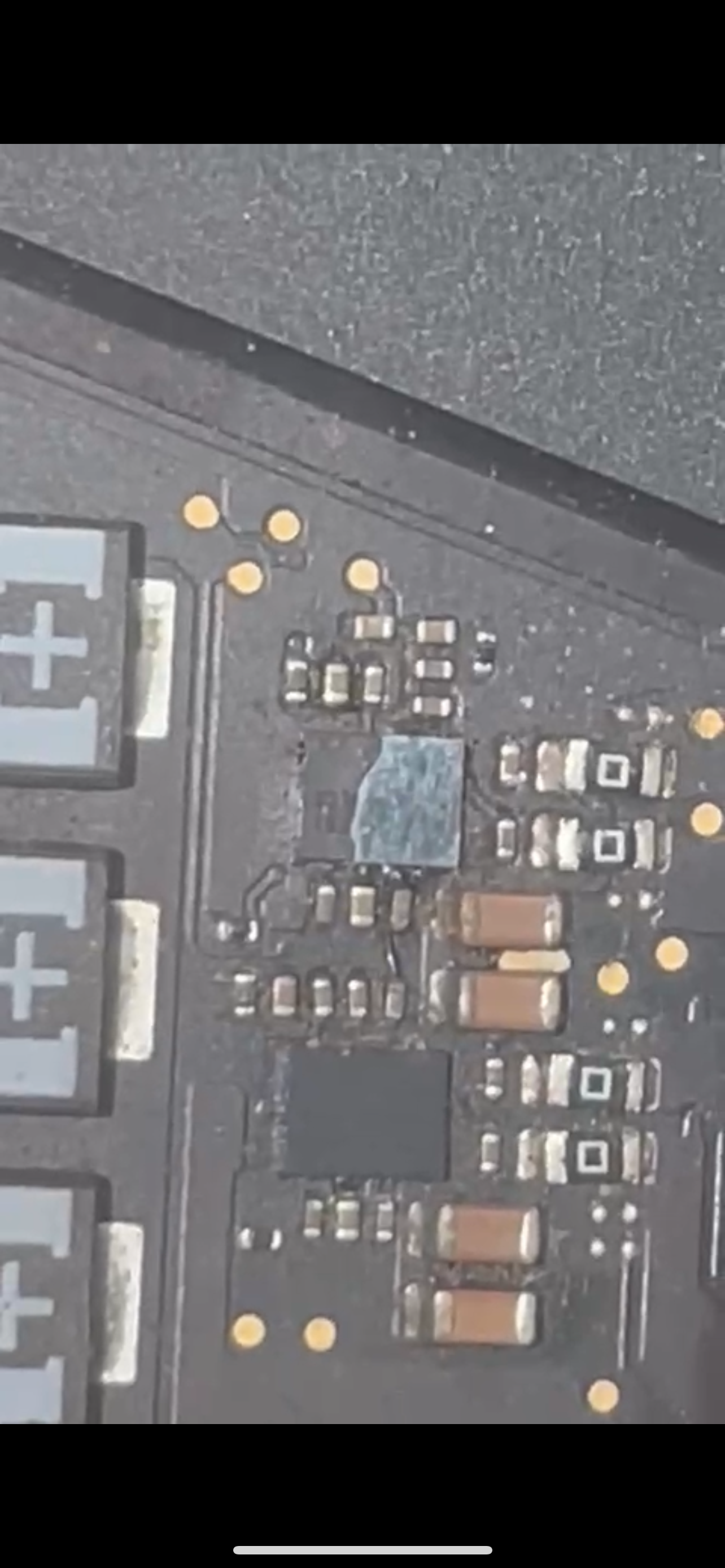

    Subject: Help Identifying IC on 820-02020 (MacBook Pro A2338 M1, 2020) — C02045500 / EKQ8LL1A
    I'm working on a MacBook Pro A2338 M1 (2020) with logic board 820-02020.
    The machine has a power issue — not powering on, and I'm trying to trace the fault.
    While inspecting the board, I found a cluster of components
    This area looks damaged or burned — there are about 4–5 components that seem affected
    I've attached a close-up photo of the chip and its surrounding area (see below). I'd like to know:
    • What is the function of this chip?
    • What is the reference designator on the board (e.g., U0500)?
    • Is it a known power rail/PMIC/USB-C controller?
    • Any known common failure points or related measurements I should check?
    There's obvious visible damage or corrosion,
    Any insight from those familiar with M1 boards would be hugely appreciated.
    Thanks in advance for your help!
    Photos/Videos:

      UR600. I think it's speaker amplifier

        Thank you so much martyjelen for the info! Really appreciate you taking the time to help.
        Just one quick question, do you think only UR600 is likely defective, or could the other surrounding components (some of which look slightly discolored) also be affected?
        I want to be sure before ordering or replacing parts.

          One cap near amp looks burned to me. But maybe I'm wrong. Better test it.

                Why? The main part of your questions was already answered with the screenshot of the schematics containing the TAS5770AC0 in Post #5
