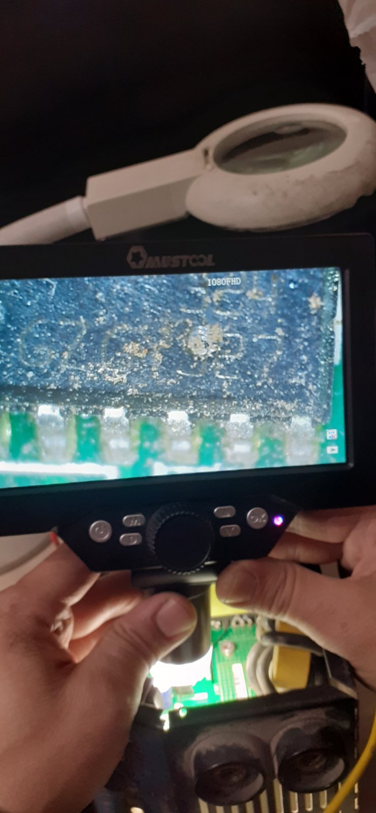

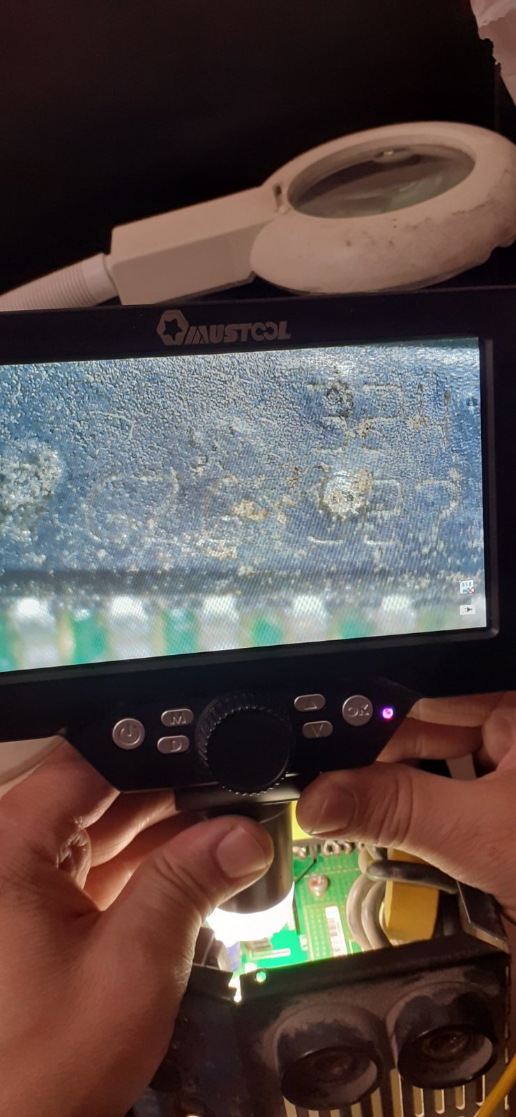

    in a bit7000 awelco weld machine it has damaged an ic 16 pin that you can see on the bottom fotos
    i have take this foto with my mobile on the display of digital microscope
    can anybody to understand what component is ?
    • 31254
    very clever - magnifying the dirt.

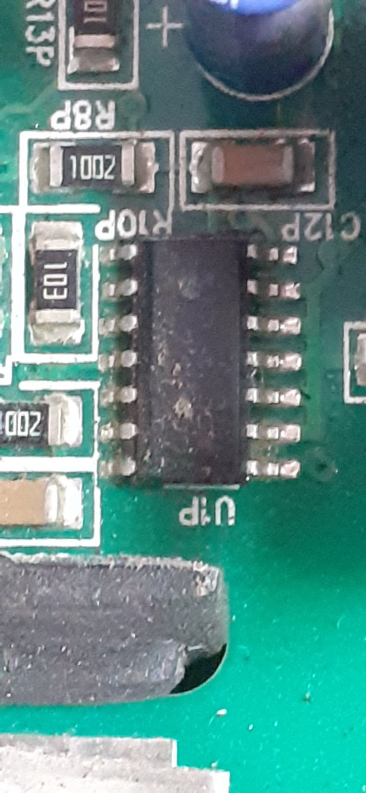

    clean it with alcahol and take a fresh picture

        sir after the useful advice
        writes
        above and in the right corner 324
        and on the bottom GZGY924
        i think must be lm 324 because the bottom number i cannot find anywhere
        do you agree ?

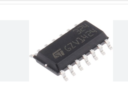

          LM324DT
          And there are not 16 contacts, but 14

            yes sir you have right and thanks
