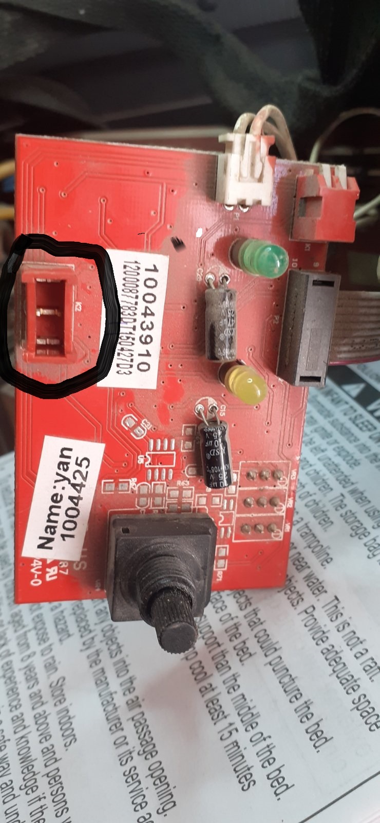

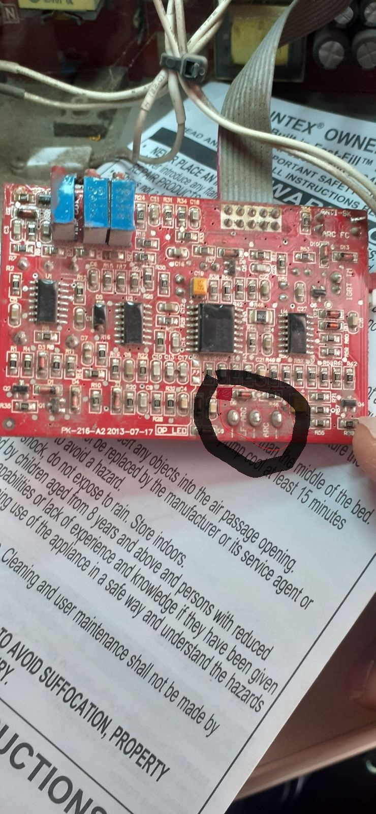

I'm looking for a selective TIG-MMA switch on welding machine
  • wolf1976
    • Oct 2023
    • 113
    • Ελλάδα
    hi
    on the bellow pictures i have include the upper and the bottom area of this switch
    the machine had fallen and this switch is break can you suggest me a suitable switch to change it ?
    i dont know if this switch is the only problem because the welding is open normal the green led is light but it welds with interruptions
    and when i turn it on i measure the voltage and its only 6 volt i dont know if this is right
    thanks on advance
    • 31260
    shouldnt be hard to find another,
    you need more info though.
    spacing between the pins,
    type of action - left/right or does it also stop in the middle,
    where is the top section? did it have a screw thread - questions like that.
    • wolf1976
      • Oct 2023
      • 113
      • Ελλάδα
      thanks for the answer
      it has only left right without stop on middle
      it has screw thread
      i havent meter for measure the distance unfortunately
      i want to choose the right switch as about the contacts because i am afraid if the switch is not suitable maby i will cause a furthermore damage to the device
        • 31260
        well it's called an SPDT toggle switch when your searching.
        the letters stand for "Single Pole Dual Touch" as in single contact going 2 ways
        • wolf1976
          • Oct 2023
          • 113
          • Ελλάδα
          thanks a lot sir
