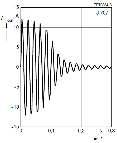

              Senz, you have two problems? One, the CRT is magnetized and two the degausser is not working? A picture of the screen would help.
              The 3-lead boxes have PTC and a heater inside to lower residual current, they're called Posistors. I would say 90% of problems are a bad posistor. But I have seen a CRT strongly magnetized by super magnets and the degausser worked fine but was not strong enough to undo it. I have also used old AC solenoids from appliances (dishwasher, washing machine etc.) to make a wand demagnetizer.
              Look how much current a TV degaussing coil gets in the graph.

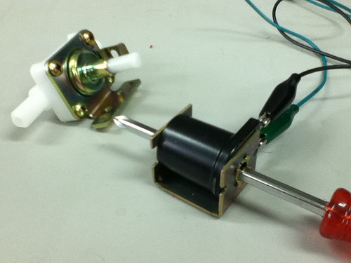

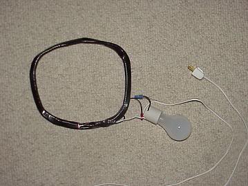

                  You could make one using a TV degaussing coil and 100W light bulb. These are weak because they must degauss the whole CRT at once- that is a large area.
                  I use something like this, a washing machine solenoid and screwdriver, and move it around the entire screen. It takes longer.
                    Are you add some resistor on first picture with bulb (I see it looks like a resistor)?
                    So the second picture AC mains plug is black and green crocodile clips right?
                    Tom66, what is the thing that he attached to drill? common magnet?

                      Done !! thank you for all of you helping me. I try to make it with 100 watt bulb and trying to my tv. it has effect but i have to makes this as close as possible to see demagnetizes effect on my tube.
                      I haven't try it to rainbow picture tube but i think it has effect and maybe needs a longer time to degauss due to effect that i see must close to the tube, maybe not strong enough as redwire said.
