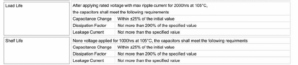

            Re: What happens when you seriously increase capacitance?
            2000hrs @105C
            Is an endurance rating.
            It has nothing to do with the operating lifetime.

                PCBonez.
                The rating 2000hrs@ 105C is what all temperature lifetime calcs are based. An example was given for life @ 50C. Check temp lifetime calc methodology, tables and the formula. Your statement that this has nothing to do with operating lifetime is totally incorrect, temp lifetime calculation is well understood and has been thoroughly covered in this forum.
                See lifetime calculator: https://www.badcaps.net/forum/showth...citor+lifetime

                                I see here and other places where people look at that data sheet and they see the xxxx hrs @ 105C and think it's the estimated lifetime of the cap.
                                If you can take that number and determine the lifetime of a cap with your equation that's cool (very!) but I'll have to look at that later.
                                For those other folks that don't realize what that number is:
                                They take a cap and abuse it...
                                - put it at 105C
                                - apply max rated voltage
                                - apply max rated ripple
                                - (think there's a specific frequency, don't remember.)
                                - hold it there for xxxx hours
                                Then:
                                They return it to 20C for 24 hours and test it.
                                - The capacitance has to be within 25% of the rating.
                                - The dissipation factor has to be not more than 200% of the rating.
                                - The leakage current can be no more than the rating.
                                The xxxx hours it is abused and still passes the last test at becomes the "xxxx hrs @ 105C" you see in the data tables.
                                It's not lifetime as such.
                                It's more how long you can abuse it without breaking it.
                                Mann-Made Global Warming.

                                  #36
                                  I am very sorry to inform you but your statements do not relate to what most of us and the manufacturers state about lifetime. Where the major determinant of life is operating core temperature (case is within 2C of core).
                                  Your input regarding the life impact due to lowered operating voltage is interesting, however the evidence is contradictory and manufacturers do not included data or reference to this parameter in their published data. In general the evidence both practically and in terms of data presented, makes this a doubtful academic area of argument to follow.
                                  Gigabyte EP45-DS3L Ultra Reliable (Power saver)
                                  Intel E8400 (3000Mhz) Bios temps. 4096Mb 800Mhz DDR2 Corsair XMS2 4-4-4-12
                                  160Gb WD SATAII Server grade
                                  Nvidia 8500GT 256Mb
                                  160Gb WD eSATAII Server grade for backup.
                                  Samsung 18x DVD writer
                                  Pioneer 16x DVD writer + 6x Dual layer
                                  33 way card reader
                                  Windows XP Pro SP3
                                  Thermaltake Matrix case with 430W Silent Power
                                  17" Benq FP737s LCD monitor
                                  HP Officejet Pro K5300 with refillable tanks
                                  • PCBONEZ
                                    Grumpy Old Fart
                                    • Aug 2005
                                    • 10661
                                    #37
                                    That number in the data sheets is not Lifetime.
                                    It's Endurance.
                                    - Dr Seuss
                                    • davmax
                                      • Dec 2005
                                      • 899
                                      #38
                                      Your explanation of the 105C rating as simply endurance and abuse is a fanciful and an unfortunate misunderstanding of manufacturers data which is placed there to allow engineers and others to calculate lifetime.
                                      Read and research more carefully and for your sake be very careful what statements you make. Endurance and load life are interchangable terms.
                                      An example from a data sheet is attached.
