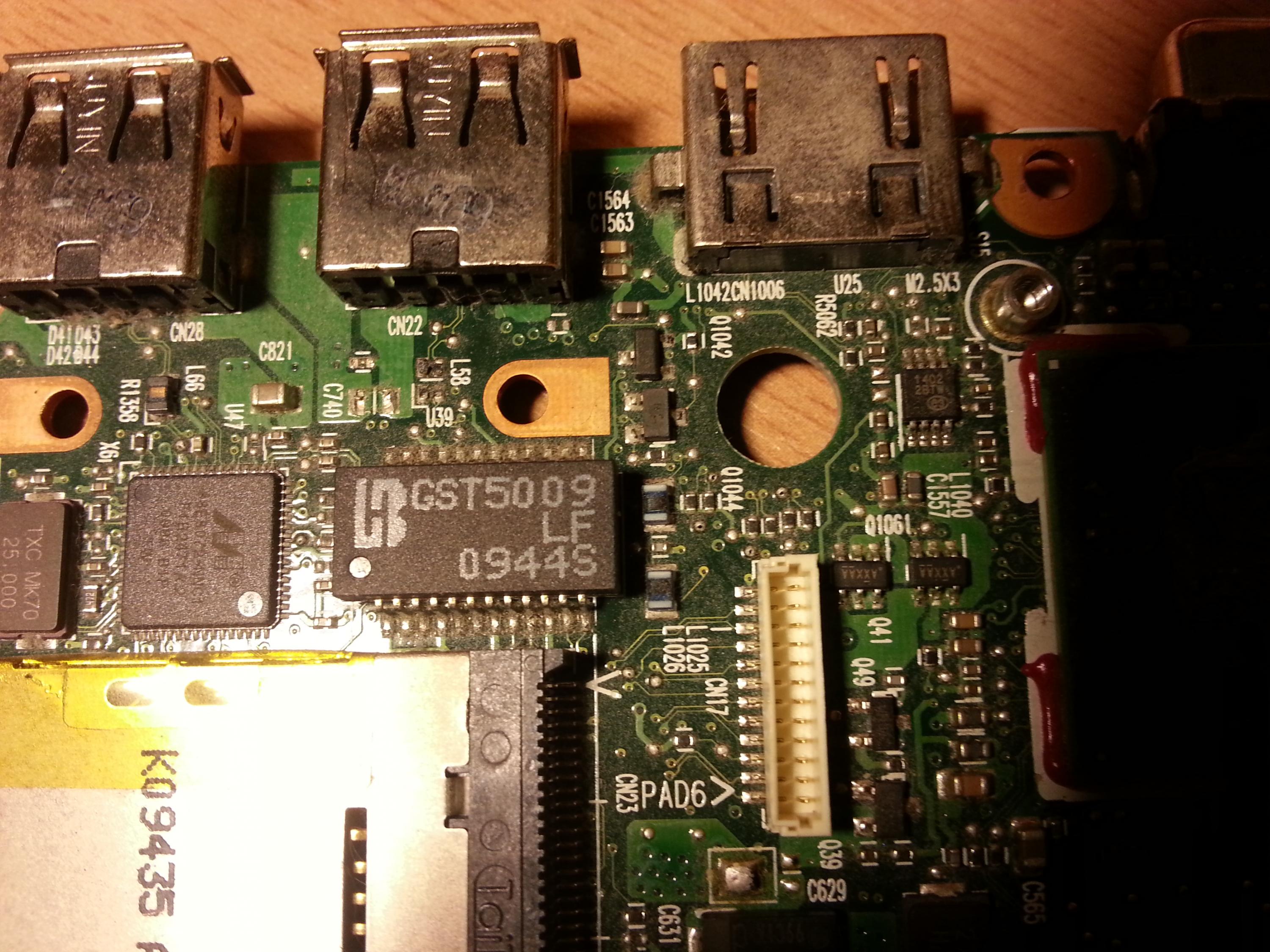

    As the title says, got SMD components marked as, say, U12, U23 and so. What is that?

    Parts marked with a U are usually ICs... Sometimes it can include transistors too (but they usually are marked with a Q). Beyond that, you'd have to look at the chip itself or a service manual schematic.

      If on the silkscreen, it usually means it's some sort of IC (anything up from a simple voltage regulator, so anything that's not a discrete part.).
      If on the parts, that is much trickier. What's the footprint and silkscreen marking?

          Here it is. Supposedly the lady owner somehow managed to push the plastic crap inside the USB onto the board and tear off couple SMD components. But it seems the U, whatever it is, was not even present before?

            Are you talking about IC U25 the 8-pin IC?

              Nope, U39, there is SMD cap and inductor teared off. Eh, do you think it's the big GST5009 chip? Don't I see a forest because of the trees?

                Re: Acronym U: what for?
                l58=l66
                c740=c821
                just look off the port to the left.

                  Yeah for sure, I haven't been initially sure about what's the U39, but now I see it clearly that the positions I though were for two components are actually for the single inductor, and U39 is most likely the big chip.
                    C740/C821 are more likely the filter caps for the +5V for pin 1 of the USB.
                    The two small traces (connected to the Diff-mode inductor) are more likely to be for the + and - pins of the USB.
                    You can test out the connections of the USB pins to those missing components. You can also put the jumper on the missing Inductor (for noise filter?) to test out if the USB port will function.

                      Since there's two USB ports, I see that L66 is the same as L58 (which is busted off) a common-mode (dual, 4-pads) choke. C740 is also busted off but the same as C821 for EMI on the USB connector shield.
                      In a pinch, I would just jumper the two USB data traces on L58 and that should get the port working at least. C740 is usually 10nF and not that important because it's EMI related.
                      U39 on the silkscreen refers to the part below it, the GST5009 Ethernet transformer.

                        Second look and C740 as Budm says, might be for 5V power (like 10-100uF) but it's weird the cap is mirror-image position to C821.

                          It looks like there is a tiny cap above C740 that has also been removed.
                            That is more likely to be .01UF cap in parallel with the larger value missing cap (10uf or more as redwire suggested).
                            By the way, typo on my part, it is common mode choke for common mode noise rejection as redwire had indicated. Just bypass it for now.

                              I may actually have few of the missing componens.as for the inductor, I guess two in parallel may do the trick? If I won't find any, than I'll just use some wire
                                The inductor windings are not connected in parallel, the windings are on the same core. just look up commomn mode choke to see how it's done, I would just bypass it for now to test, if the USB cable is short and not close to electrical noise then you mat get by without it.

                                  Ah yeah, common mode, I see. Two differential will have to do
