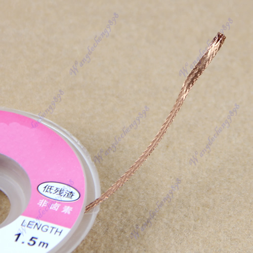

                Avoid this wick from China:
                Bought a roll for next to nothing... It is fluxed, but the copper strands are packed too tightly and flattened. The stuff won't absorb anything.
