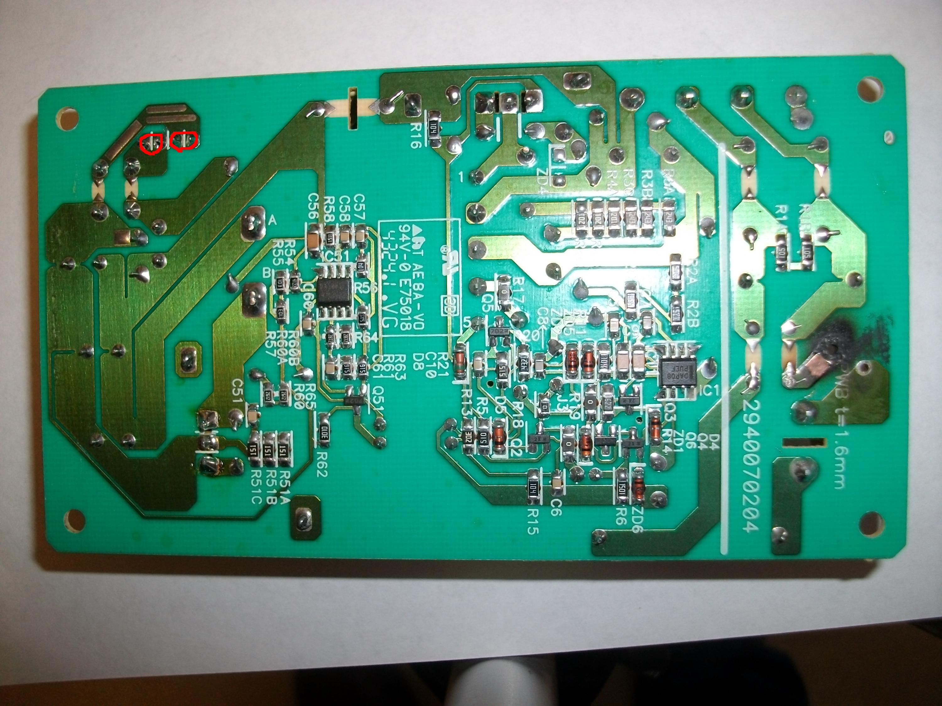

what is this burnt part
    Re: what is this burnt part
    That is fine, it means the bridge or the MOSFET are not shorted out.
    The voltage is a little bit on the low side, if your AC is at 120v then the voltage on the cap should be 120 x 1.414 = 170vdc.
    So at this point, the power supply has no DC outputs at all?
    This power supply should be putting out 16vdc as shown on the label?
      budm,
      What does this voltage tell?
        It is telling me that the bridge rectifier and the filter cap are functioning but I do not know if you are getting the 16VDC out put or not. If not, then the switching circuits are not working and will need more troubleshooting.
          it will not power on the set is dead. Where should i check for the 16vDC out put?
            In your picture bottom left corner there is a socket Two pins appear to be labelled 16v
            Are the other pins labelled. It is these 4? pins you need to test
              The white connector with 4 pins is the 16vdc OUTPUT connector. Check the reading between the two red circles with your DC voltmeter, do not worry about the red/black probe of the meter, just get the two probes to the red circle.
                Have 16.24 volts
                  Can you reconnect to the main board and test again.
                    Connected to main board tested had 16.30 volts
                      Your power supply is fine, problem is some where else.
                      You need to provide good clear pictures of other the boards, there is link some where here in thsi forum on how the pictures should be.

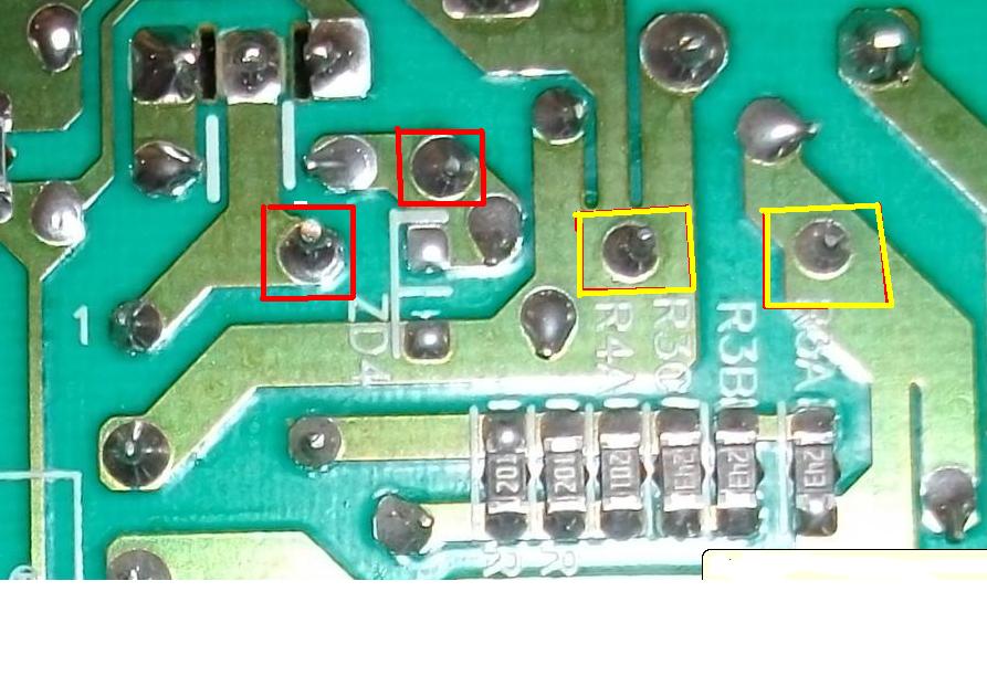

                        I have been looking at some of the joints on the base of the boards.
                        Can you check the ones I have marked and if they look at all bad resolder them. Are the yellow ones the main cap? ( My top to bottom geography is not good)
                          Isn't the thermistor just overloaded, heating it too much? It can heat to much over 150 °C and operate normally. Yet the surroundings won't with this temperature
                              budm,
                              I turned the TV over to move to take more pictures of boards and the TV is working again. I guess the re solder of the burnt part did the job. Thank you for all your help !!
                                You did scrape off the green stuff and solder the current limiter back in place using flux as suggested, right? Glad to see that all it was, I have seen many colder joints for the current limiter, it will get worst and worst as joint resistance go up and more heat built up until the trace burnt or the solder crystallized.
                                  Yes, I used fine steel wool to clean up the board,down to copper and re solder as you said. Thanks you were a great help !!
