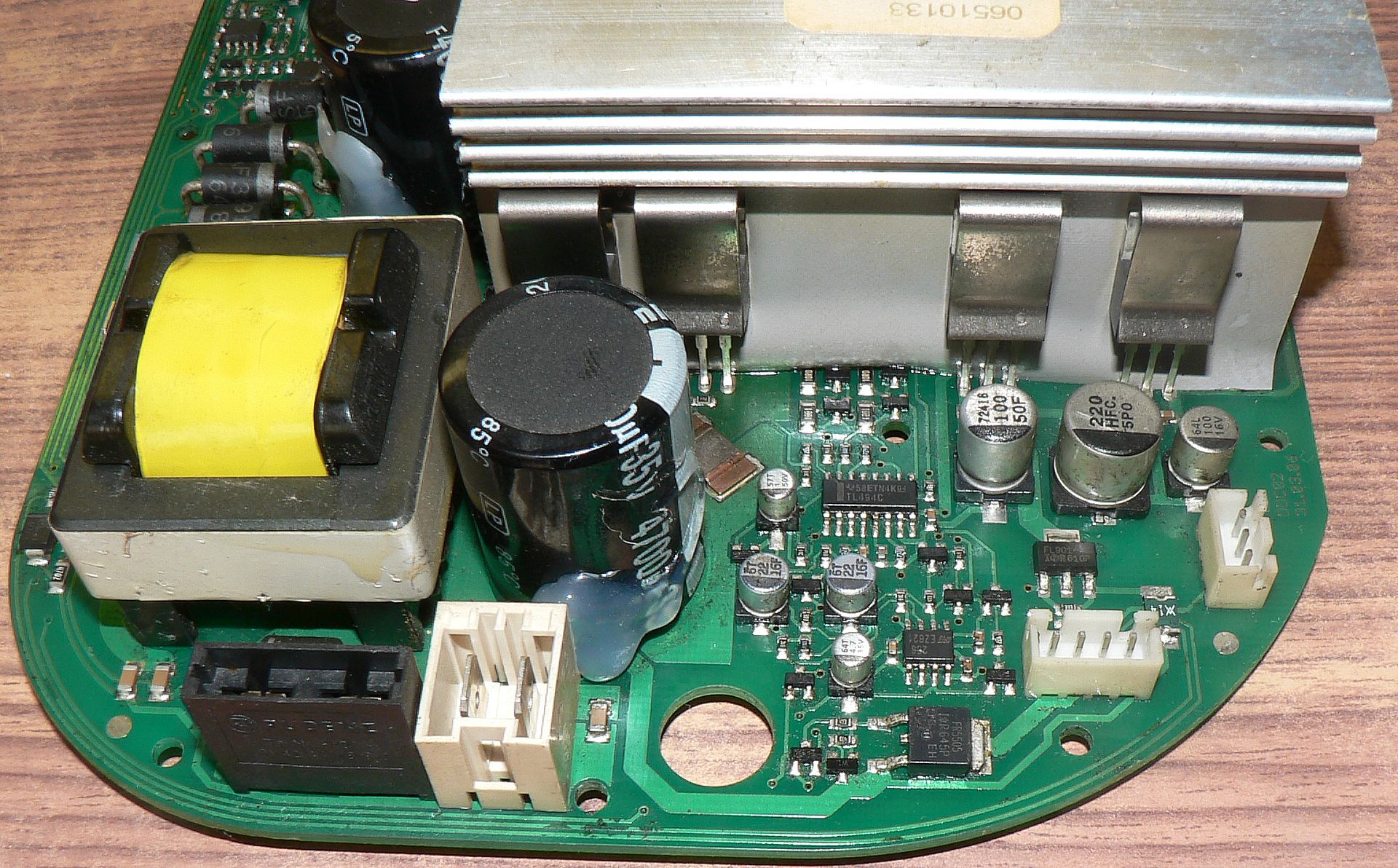

    Got PCB from brothers truck air conditioner unit. It seems to be Waeco CA-800. So far I have discovered it is 24V powered unit, obviously with step-up transformer - transforming most likely to 230 V for compressor and maybe also the fans (at least two fans in there).
    From what I know, board is defective for most people with this unit and it is supposedly worth of at least 400 USD/300 Eur, so you can see there is some point in repairing this thing
    In this case it is supposedly dead, connecting it directly to 24 V resulted in burning two fuses. I have nothing but camera with me here (at home now) so I will clean it and take some pictures for you guys, than I will check all the diodes/rectifiers and transistors when I will be back to my "lab"
    Stay tuned!

    Man its covered with some stuff, it seems like dust with some pitch-like thing most likely from other cars and trucks exhalations. I cleaned some after half an hour of fun with technical gas, but still…
      Re: Interesting stuff - truck air conditioner unit board

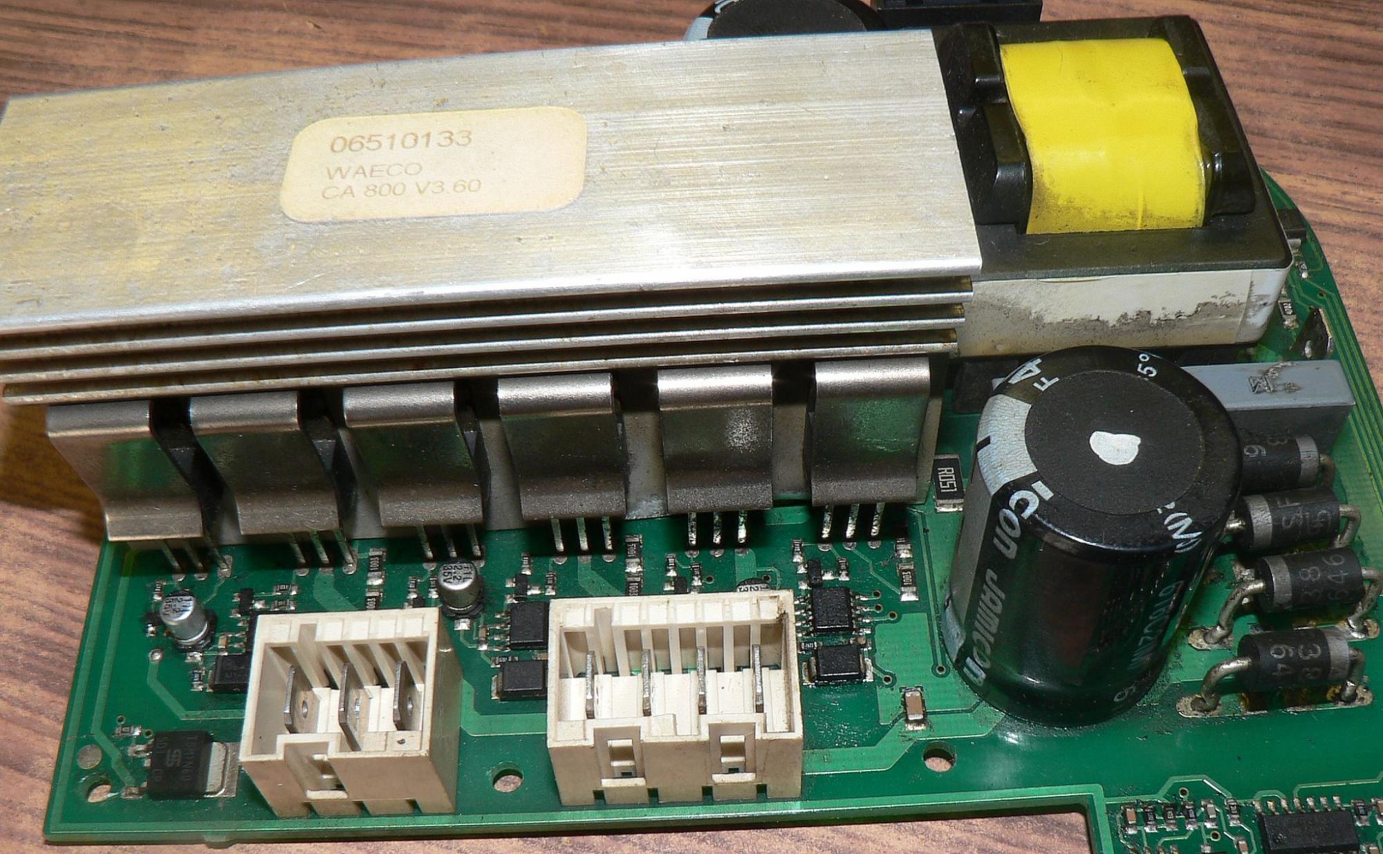

      It looks like it uses permanent magnet 3-phase motor drive system (you can see 3 pair of MOSFETs on one side of the heat sink) for the compressor, transformer is too small to be stepped up to 230V, this unit consumes 800 Watts of power. So far cannot find diagram yet.

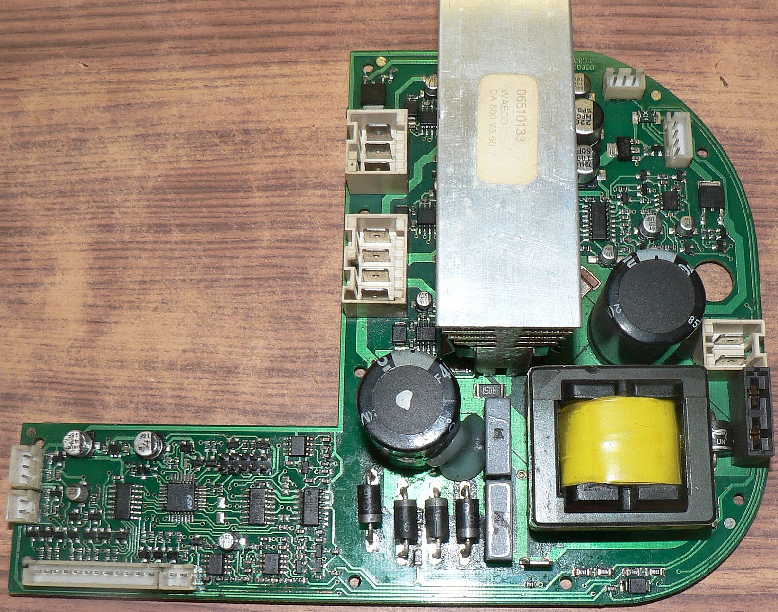

                  Looks like a 2-sided board with nice big traces, so it shouldn't be hard at all to trace it and derive a schematic, then figure out how it's supposed to work.
                  Post clear directly-overhead pictures of the front and back if you'd like some help
                    Sure, in my lab, I have also some photo stuff there, including good light and white surface

                        OK, finally got to it. What I found so far is one shorted transistor - IRF1010N - on the input side. That would explain the blown fuse.
                        IRF3205 seems to be more than good substitue. Only thing I do not know is the fuse I should use. I can simulate 24 V with two lead UPS batteries, hopefully if it would work without the panel I will see what voltages come from it. I think I can be safe with regular 6,3A fuse for the time being, since there is no output really it should not consume much power.
                        ADD// as for the topology side, output is definitelly high-voltage, than it goes to the collector (most likely, but central pin :-)) of single transistor in every of the three couples. Every couple is driven by IR2104 half-bridge driver. My guess is it is there to simulate sine-wave, whaddaya think?

                              OK, got some nice sparks and one dead 30A fuse Not sure what to do next, nothing seems to be wrong in there from my point of view. The problem should be on the primary side as being on secondary, it would just blow things there. But all the IRG4BC20KDs (IGBT) are fine.
                              Well, there is also one slightly burned component which seems to be SMD resistor. It actually looked good before I touched it, than the top layer with printings just dropped of I remember there was something like 162, maybe 1R2 or 1k2? It reads some 1130 ohms…it is between the two primary transistor gates like: gate-SMD cap-resistor-gate
                                  There are two, TL494 and "258 EZ621" from ST Micro. Actually, there are some paths going all the way arround the rim to the part with more SMD components. There are two more EZ261 and lots of other stuff.
                                  The thing is, if something from this would be shorted, do you think it can blow of 30A fuse without melting the paths? :P I think it is something more major, but can't find it though…

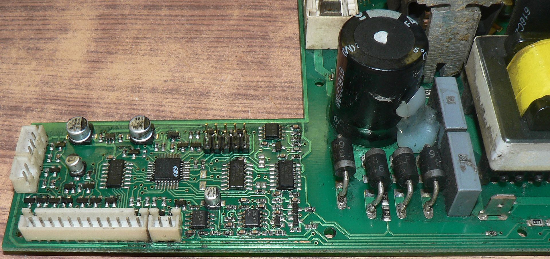

                                        OK, it is still blowing fuse after unsoldering primary transistors.
                                        But here is the deal. I have been thin king about the diode (the huge one) which is on input side, just after fuse. Can it really work with diode being in conducting state between voltage and ground? Shouldn't the diode be, like a, in opposite state to block half of the AC when it would accidentally be applied?
                                        It should, right? So, how big idiot am I to solder it in like that? Tell me please…
