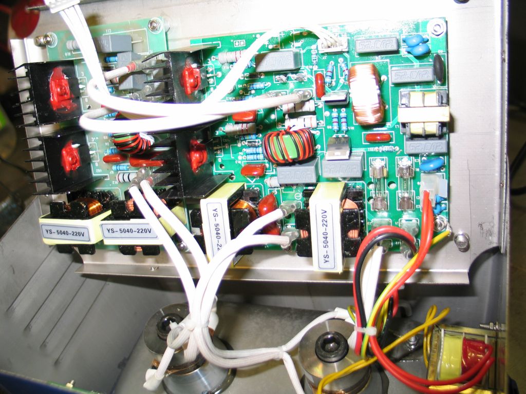

    Bought an ultrasonic cleaner, had to see what was inside.
    So, I bought this on ebay - seems to be working properly, had to see what was inside as I was curious. Going to use it to clean engine parts ,carbs and electronics. Just ordered Elma Tec Clean A2,A4 and will have to buy the A2 too for electronics.

    G,
    Had to fix my share of ultrasound gizmos over the years.
    With a little bit of care they last a good long time.
    Try not to abuse the XTALS, the items under the bolts on the bottom of the cleaning tank.
    Spares may not always be available.
    Depends on the OEM.
    Some of the attach points are 'drive' and some set the feed back.
    With xtals, expect very high levels of voltage.
    Torque is critical on them, so don't adjust or remove those bolts unless you truly have to.
    Lastly do not stick your fingers in the fluid when the unit is on.
    You won't like it. Humans are mostly liquid and will vibrate at the same rate as the fluid in the tank. Want to run 1000 watts of ultrasound through your digits, expect a lot of pain.
    As for fluids, water works good. Lemon juice. I have used gun solvent in the past to clean firearms parts. Watch out for things that burn, because under agitation there is a lot of vapor that comes off the fluid, and sparks will trigger it. Acetone great on solder flux but it will eat some plastics. Once saw all the polystyrene caps eroded a way on a circuit board sent for cleaning.
    Try stuff on things that you don't mind dissolving.
    Junk electronics is great for this.

        Thanks for the tips guys - won't mess with the xtals torque unless I have to due to defective parts. I did see on youtube a guy cleaning parts without a basket - reading what you posted 'budm' I won't do that, some of my carb jets are however so small they fall thorugh the basket on the bottom of the tank - maybe I should avoid cleaning parts so small.
        I did try cleaning with plain water and with powder for a kitchen wash machine - seem to do the trick but can't wait to see the effect of Elma tec's solution.

          I fixed a lot of Branson due to damaged xtal, the workers were putting a lot of parts right into the tank without using the basket, we had so many failures, the Branson field engnineer told us never let the parts sitting at the bottom of the tank without using the basket.

                        Well, the cleaner itself is a cheap China item with a rated ultrasonic power of 100W - I did hook up a meter and if I remember correctly it drew about 75-80W without the water heater on.
                        It is working but I would think it is a weak item.
                        I did try the A2 fluid on alu just too see what would happen - the alu got a dark colour.On brass it did not help alot, maybe I need to let it work for several hours. You can see the jets has a stange surface colour after using A2 fluid and they do not get brightener. Tried ammo shells too, they did not get brightened either.
                        The A4 fluid works better I think, does not darken alu and items gets cleaner but not as clean as I hoped for. But then again it might be the underpowered
                        ultrasonic cleaner itself.
