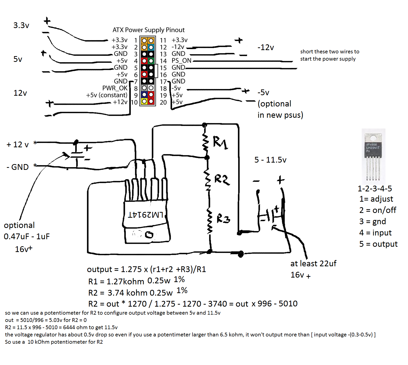

    If you're still interested I can suggest a simpler circuit... let me draw it up in paint

      Here's an example
      You can just cut most of the cables from the power supply and take directly the voltages the power supply offers you: 3.3v, 5v, 12v and -12v
      Most power supplies, when they don't power a lot of things, deliver voltages that are a bit above the standard values above. For example, instead of 5v, it may output 5.3v and get close to 5v as the load increases (when you have several hard drives connected for example)
      For most things, these voltages are "close enough" to work directly with them but when doing breadboard stuff, it's not safe for the electronics on the board.
      For example, some Microchip PIC microprocessors support a maximum of 5.6v, so you don't want to power the breadboard directly from the 5v the power supply gives you.
      So you use a linear voltage regulator, which takes 12v and generates what you tell it to do.
      In the instructables page, they use a chip called LM317 because it's a classic ... but the problem is the specifications are not that great.
      All linear regulators have a voltage drop, they can only output a value few volts below the input voltage - in the case of LM317, the value is between 1 and 2 volts depending on the load.
      So if you were to use LM317 and feed it 12v from the power supply, you'd get a maximum of about 10v.
      The LM2914 I put on the picture has a much lower voltage drop of around 0.5v, but at low loads it's even smaller. So it's safe to say you can get up to around 11.5v regulated output with this chip.

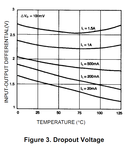

                      That data sheet that you posted is from the LM117, I was talking about the LM317. Here is the data sheet that I was looking at:

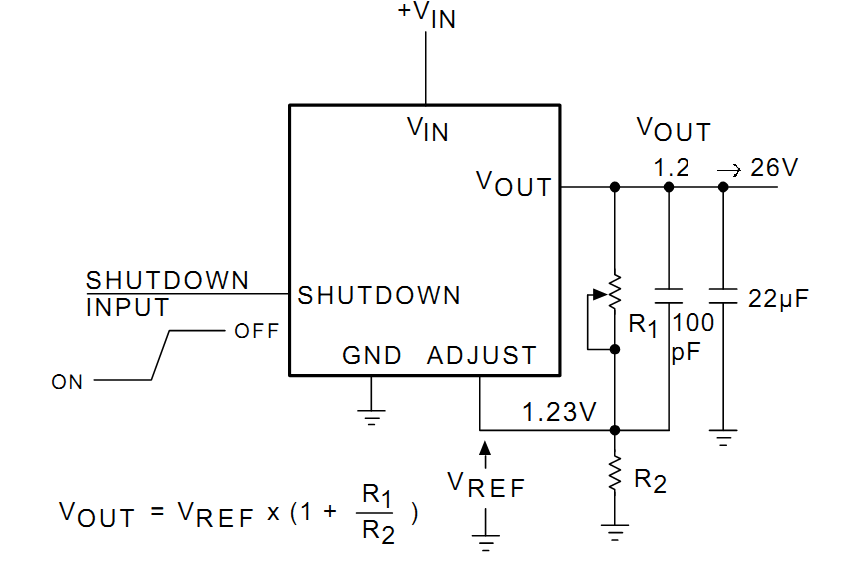

                        You're listing the LM317L, which is in a package without adequate heatsinks, so it's limited to 0.1 A of output.
                        If you get it in a package more suitable to be heatsinked, you will get the one that's capable of more than 1.5A.
                        For example, LM317T (t from to-xxx) can do 1.5A+ :
                        Keep in mind that linear voltage regulators turn the difference of power to HEAT.
                        You should NOT use something like this to convert the 19v from a laptop adapter to let's say 5 volts. For example, a simple small LCD display with backlight draws about 80mA at 5v - to generate this, the linear voltage regulator would turn to heat (19v - 5v ) * 0.08A = 1.12 watts. You won't be able to insert this into a heated laptop adapter brick, because you won't have a fan in that.
                        On a psu that has 12v output , the dissipated power for the example above is (12v-5v) * 0.08 = 0.56w so with reasonably cheap heatsinks (the ones rated for 15-20c/w at natural convection) and if you leave the atx psu fan running to get some air moving the heat, the lm317 will probably work with up to 4-5 watts of heat. It won't be safe to push it to the maximum because even when outputting 5v at 1.5A we have (12v-5v) * 1.5 = 10.5 watts which is a lot. But I'll get to this later in the message...
                        Remember what I told you about the voltage drop these regulators have - the LM317 is particularly sucking at this:
                        If you power a microcontroller and a small LCD screen with backlight, the output will be a bit less than 0.2A, so at 75c which is normal for linear regulators, the voltage drop will be about 1.6v
                        However, if you're going to power a row of leds or some fans or something up to 1-1.5A, the voltage drop will be up to 2.5v
                        So you can't really make an good adjustable power supply because, for example, you can power it from 12v and configure the output to 11v, and it will output 11v at low loads but only 10v when you really demand something from it.
                        You want to pick a regulator that has less voltage drop, guaranteeing you a wide range of voltages without a huge drop.
                        If you go on Digikey you can filter by voltage drop (say a maximum of 1v @ 1.5A for example), then filter to get only positive adjustable regulators, then pick through hole components because those are easier to work with.
                        You will get for example these great regulators:

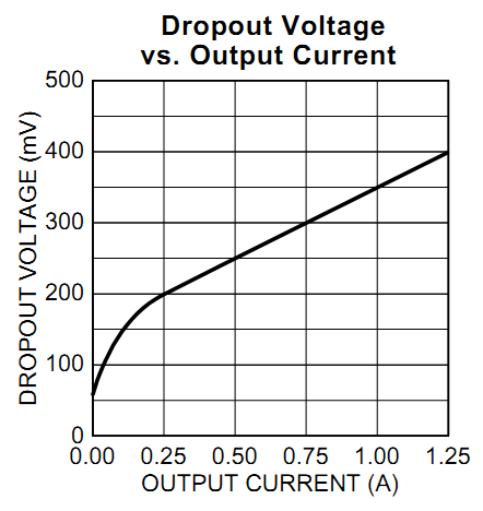

                        MIC29152WT IC REG LDO 1.5A ADJ VOLT TO220-5 - Micrel Inc Positive Adjustable 1.25 V ~ 26 V Up to 26V 0.35V @ 1.5A
                        http://search.digikey.com/us/en/prod...1111-ND/771580 3.15$
                        LM2941T/NOPB IC REGULATOR LDO 1A TO-220-5 - National Semiconductor Positive Adjustable 5 V ~ 20 V Up to 26V 0.5V @ 1A
                        http://search.digikey.com/us/en/prod...NOPB-ND/148144 1.72$
                        So you can see the one I recommended in the posts above is the cheapest at 1.72$ but it can only do a minimum of 5v - for just a bit more you can get the MIC2941AWT that goes as low as 1.24v at 1.25A for 2.54$.
                        With this one, the voltage drop at about 0.2A will be as low as 0.2v and at 1A, it will be only 0.4v:
                        So with an ATX psu, you can go as high as 11.6-11.8v and the circuit is also almost identical to the one I drew:
                        Now going back to heat output - you don't want to generate less than about 7 volts from 12v from such regulator, because of the heat generated at high loads. You can buy two of these regulators and use one to output voltages between 6.5v and 11.5v.
                        With the second, you can use a trick to power it with about 7v - use the 5v line from the psu as ground and the 12v line as input, this way the regulator will receive (12v-5v) = 7 volts.
                        So you'll have the first regulator doing 6.5v-11.5v and the second regulator will do 1.25v-6.5v at any loads.
                        (Or, you could simply leave the first one to do 4.5v-11.5v and connect the second regulator to normal ground and 5v and have the second regulator do 1.25v-4.5v)
                        You can simply use a switch to change between the regulators without moving the leads - connect the ground of the first regulator to the ground on the case banana plug (or whatever you use) and flip between the output of the first and the second regulator using a switch like this one, sending whatever you select to the output banana plug:

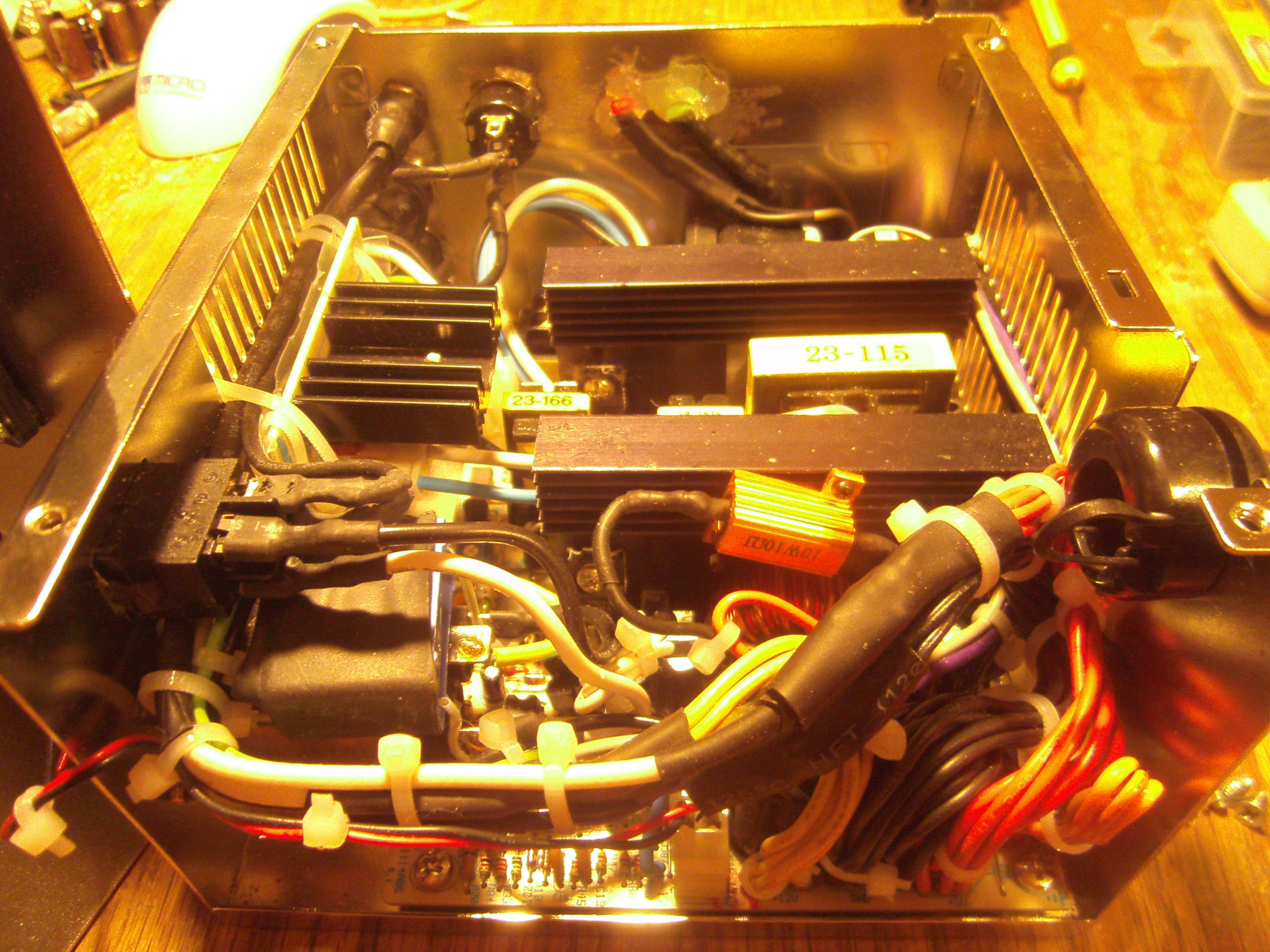

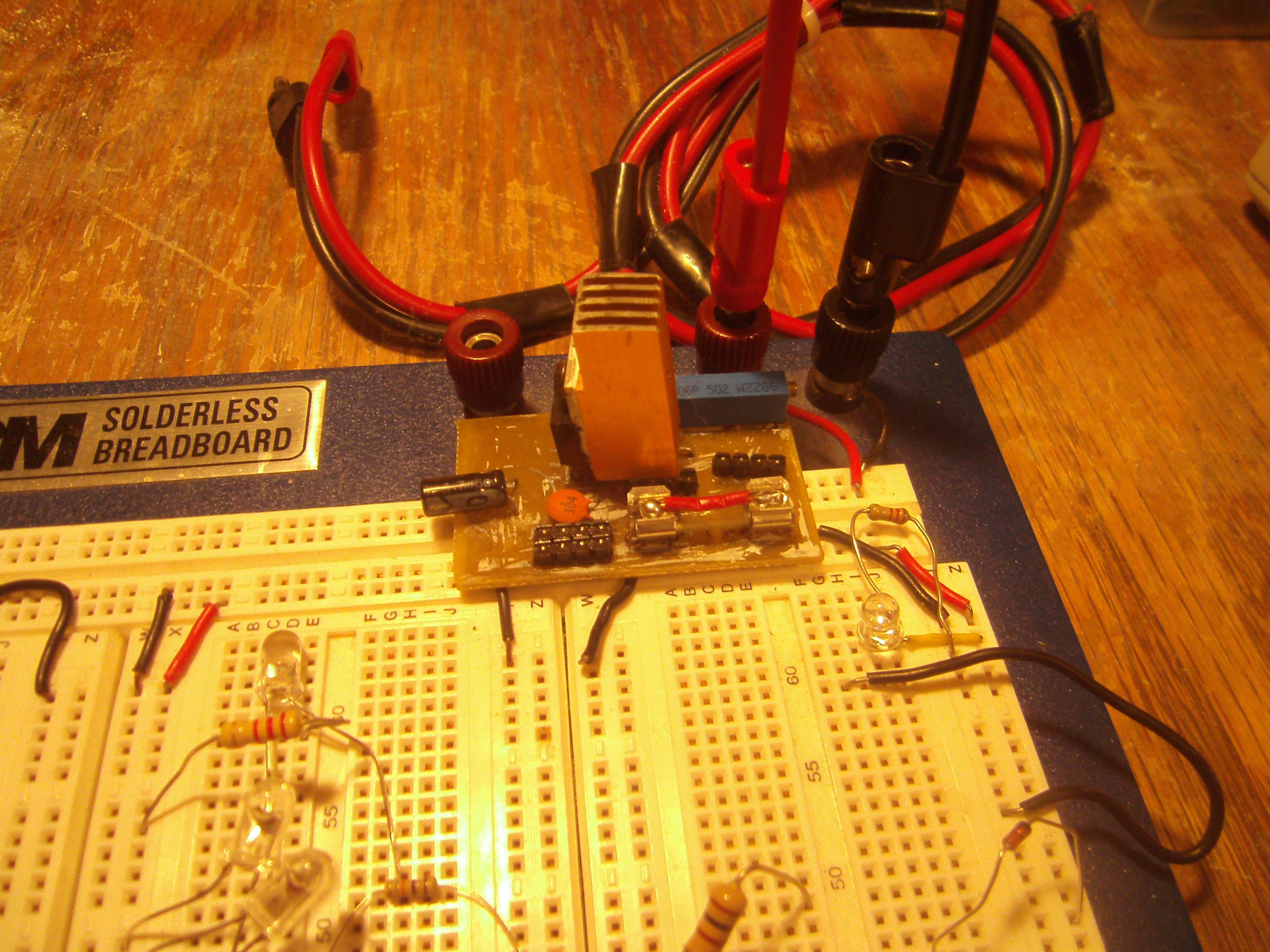

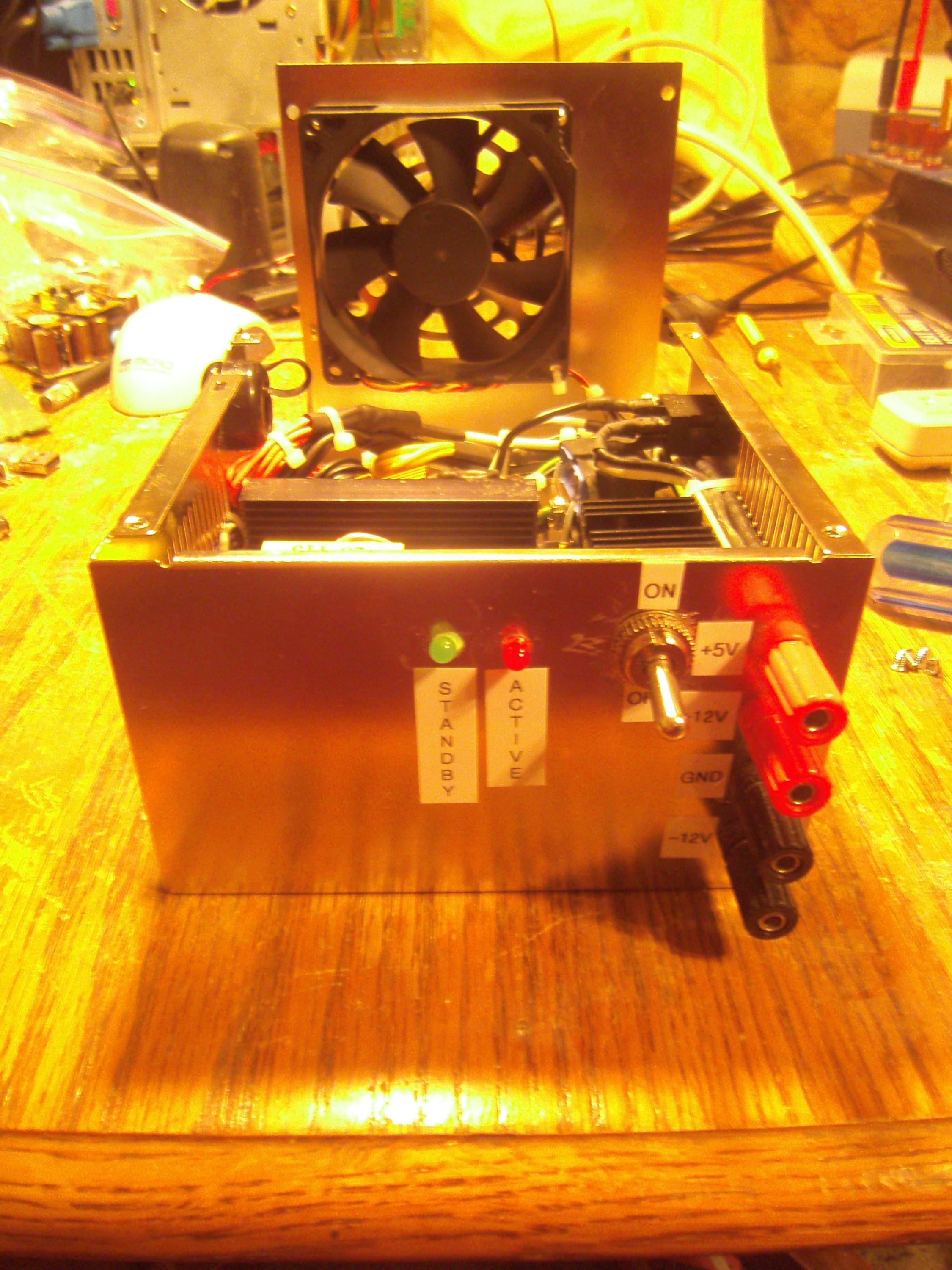

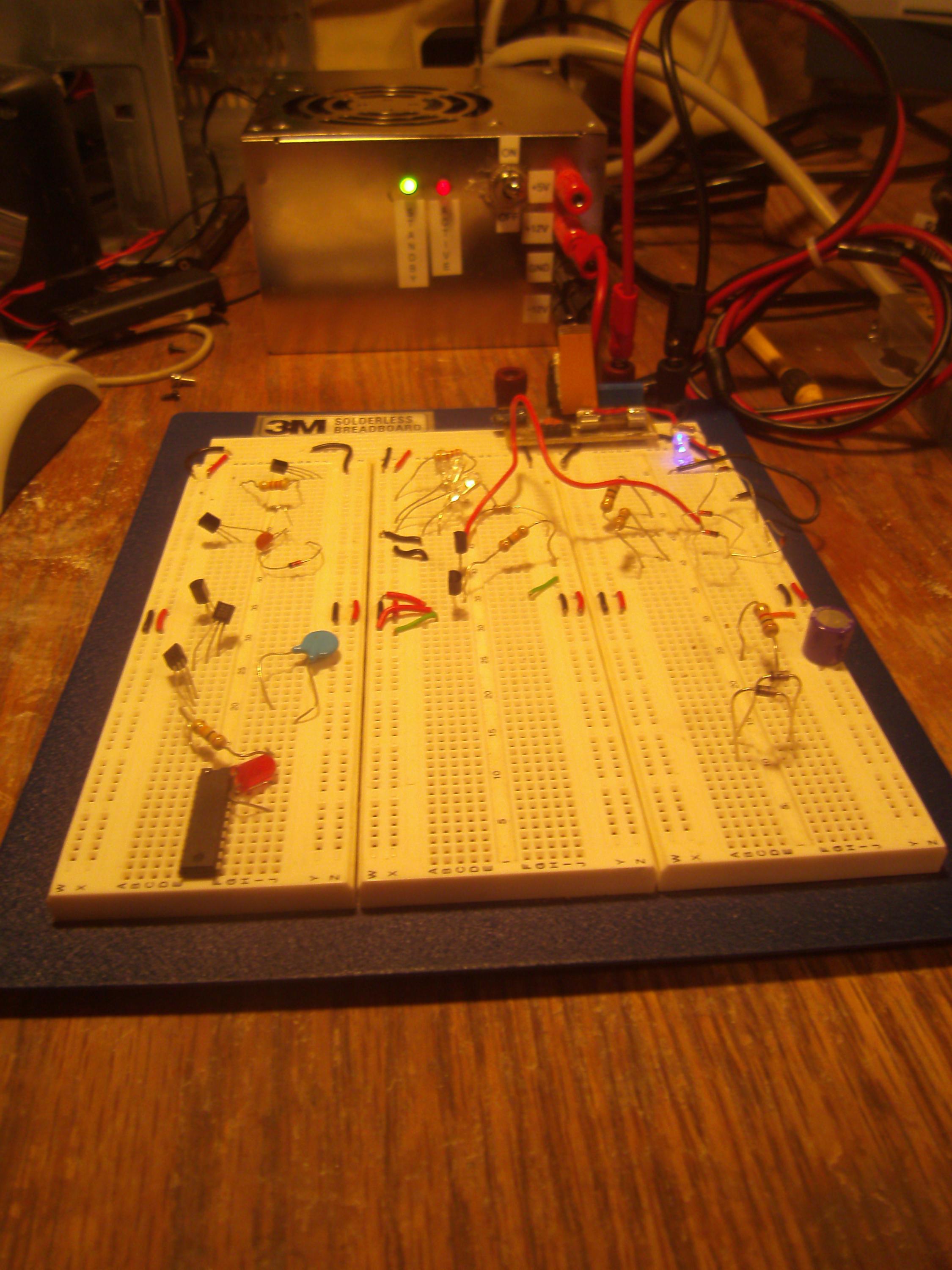

                                      I saw this thread and could not resist posting. I built myself one of these a few months ago for my solderless breadboard projects. I also made a variable voltage regulator, using a LM350T, that plugs directly into the breadboard. I think it was well worth the effort and suits my needs as well or better than anything I could have bought. The most expensive part for me was for the BNC connectors, most everything else I had on hand.
