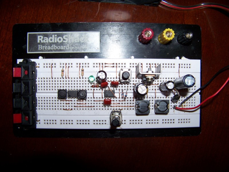

          Here is my 555 timer PWM circuit post apocalyptic mosfet meltdown (from leaving the gate floating unattended while taking a shower... it was fine while I was tinkering with it for several minutes but apparently it decided to switch itself on sometime during the rinse cycle)... using an irf640a mosfet normally the heatsink doesn't even get warm during operation.
          I'm using a SEPIC topology on the output (yeah there is an error on the wiring of the output side, after meltdown I moved some stuff). This gives me a completly adjustable non-inverted output voltage of between 0-20V+ simply by varying the duty cycle.
          I still have a bunch of refinements and add-ons I would like to include...
          1. Switch 555 timer #1 to 556 timer.
          2. Connect a 10k resistor between pin 8 and pin 4 of 556 timer #1, and put an NPN transistor between pin 4 and ground. That way I can perhaps use a zener diode to detect overvoltage conditions caused by fan failure or cranking up the duty cycle too high... when the base of the transistor opens up it should pull pin 4 down low effectively acting as a crowbar requiring a button press to turn the circuit back on.
          3. Rig up 556 timer #2 as an astable multivibrator driving a speaker to act as a fault alarm. Might use a PNP transistor somewhere along the lines so that when the output of timer #1 goes low it kicks on with a side by side NPN to warn when the output voltage is near maximum.
          4. Configure the main PWM timer as to allow for non-proportional independant setting of space and mark time. I'm shooting for a switching frequency of around 30Khz and trying to minimize the ripple current going thru the coupling and output filter capacitors. Might even tinker with doing some sort of low-pass inductor.
          5. Wind a center tapped toroid inductor, optimize inductance, capacitor, resistor values to optimize efficiency. Play with various mosfets and research the need for gate/pulldown resistors.
          6. Maybe incorporate a dual or quad voltage comparator in lieu of zener diodes.
          7. Add on as many jumper wires and or/components on one single breadboard to make things as complicated and/or cramped together as I possibly can.
          8. Incorporate a NTC or PTC thermistor in such a way that I can set my output voltage and have the slope/ramp/gain on the output increase proportionately, this will also serve as an over temperature alarm due to the output voltage going too high trying to compensate.
          9. Say fuck it all, rig up a MC34063 switching an external FET as a boost converter (yes it can be done) to achieve an output voltage of around 16v and then use some other means to decrease the voltage to a level that suits my fancy.
