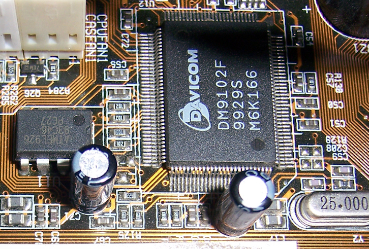

    This is a odd question, and im sure nobody has tried this, so i guess im looking for opinions rather then answers so here goes...
    Would it be possible to swap the onboard ethernet chip with another "similar" ethernet chip.What i mean by similar is that it is same physical chip but different manufacture. Both chips have same voltage,i/o pinouts, footprint..ect..ect.
    So i am thinking that either it will work, and OS would detect and drivers would need to be installed, or i am also thinking that because its onboard that theres code inside bios that needs to be added/replaced. If thats the case its out of my knowledge. I know theres tools to edit bios but i dont know what to look for.
    before anyone asks, theres no practical reason for this experiment, its just curiosity, and soldering practice.

          Sorry that i wasnt specific on the chip(s) in question.
          The onboard chip is Davicom DM9102F. The chip im trying to swap it with is Realtek RTL8139D. They both are of the same IC and footprint so desoldering and swapping would be no problem. Going by there data sheets there shouldnt be any issue with voltages, so i would think that the motherboard should still boot, but im not sure if the bios would need editing, or if the OS would detect it.(kind of like a pci ethernet card) I dunno maybe the bios needs editing, i just dont know what code in the bios would contain the ethernet information.
          The bios is Award. I can open the bios in a tool called awdbedit and can see things like bios logo, ROM files,..ect..ect

                Re: replace onboard ethernet chip?
                ^ Maybe, but the OS finds the add-on card ID because of the programming of the (separate chip) prom on the card. The question is do network controllers now have programmable memory in them. If not, it won't work w/o replicating the memory contents to whatever degree it's needed.
                  look around for a tiny 8pin SOP IC in the area around the ethernet chip.
                  Chances are there's one, which would be an EEPROM of some kind. Same thing should be on the donor-IC-card or board or whatever it is.
                  If it doesn't work out of the box, you might wanna try swapping those around.
                  edit: just curious.. Why do you want to swap ICs in the first place? Is the original obviously damaged or something?

                    Thanks. I would never even thought of looking for another chip to swap aswell. It looks like the one to be replaced is an ATMEL AT93C46 and the donor is HOLTEK HT93LC46. Both are 3-wire serial EEPROMS. I might aswell swap them both if i decide to do it.
                    To answer your question, no the original isnt damaged.Like i said in my original post, theres no practical reason. Its basicly curiousity, and a training experiment. I came across a similar repair awhile back and the idea stuck with me so i wanted to see if it was possible.
                    Anyway, heres a snap of what im working with.
                      RTL8139D and DM9102F?
                      The DM9102 is only available in 128QFP, and the RTL8139D in 100QFP. The pinouts are nowhere near the same.
                      The RTL8139C is in 128QFP, but again totally different pinouts. (Pin 1 is PCLK on the '9102 but VDD on the '8139C.)
                      No way they will ever interchange. You'll likely cause damage. Even at the software level they're incompatible.
                        attached the pic to this post. All I can see in your post is a "NO HOTLINKING" placeholder lol
