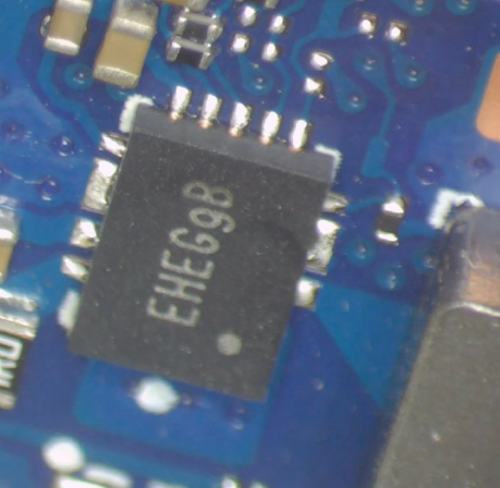

Hi, do you know what component this chip refers to? I need to replace it.

It looks like it's from a laptop motherboard, can you post the laptop model and board number? Maybe there's an schematic available
Found it EHE*** SY8370FTMC
https://www.badcaps.net/forum/troubl...02#post1538202

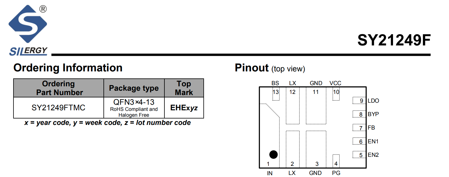

Datasheet
https://www.silergy.com/productsview/SY21249FTMC
But can't find a supplier with that exact part number SY8370FTMC, as the other SY8370*** variants have same footprint but different pinout
