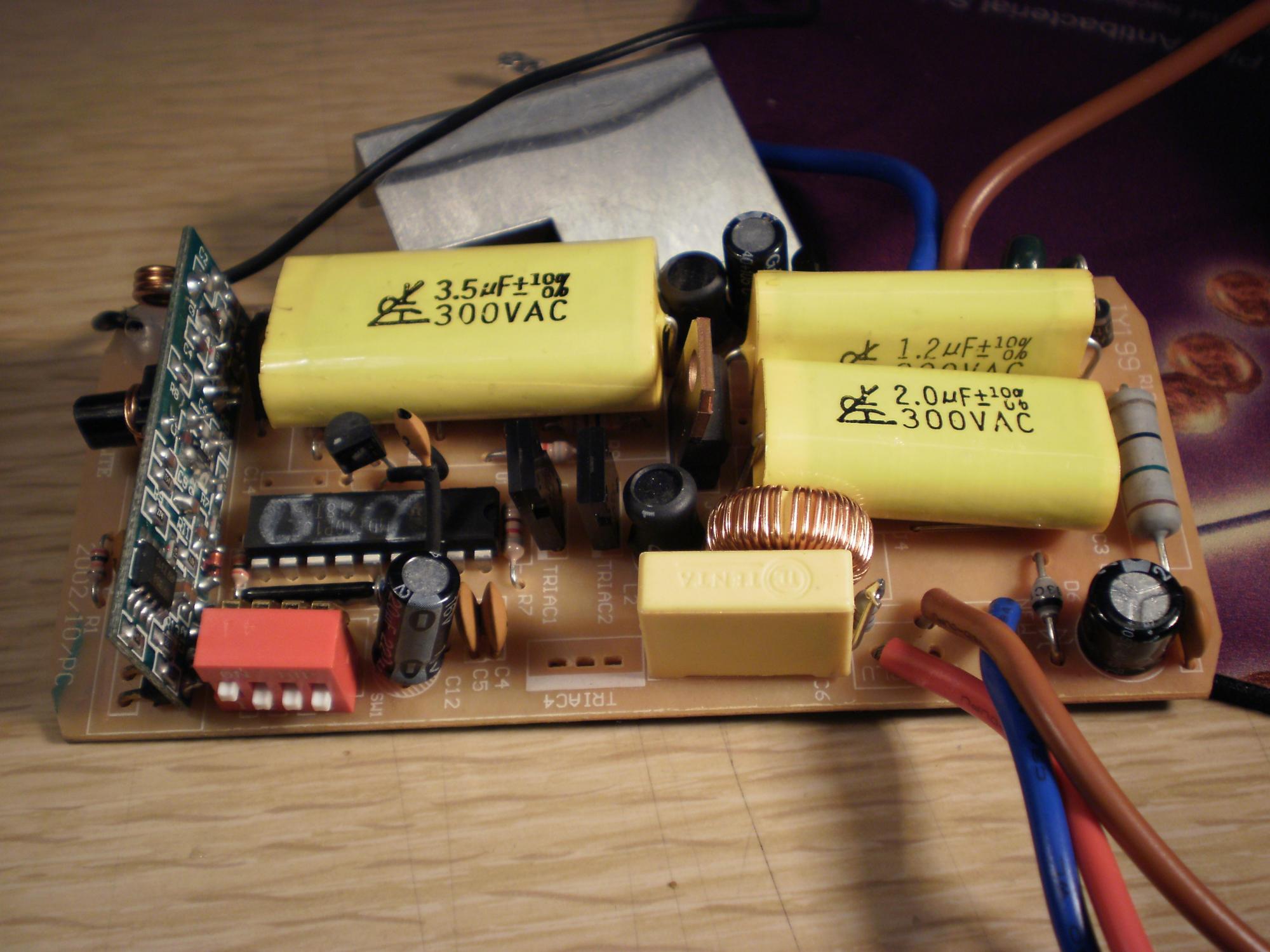

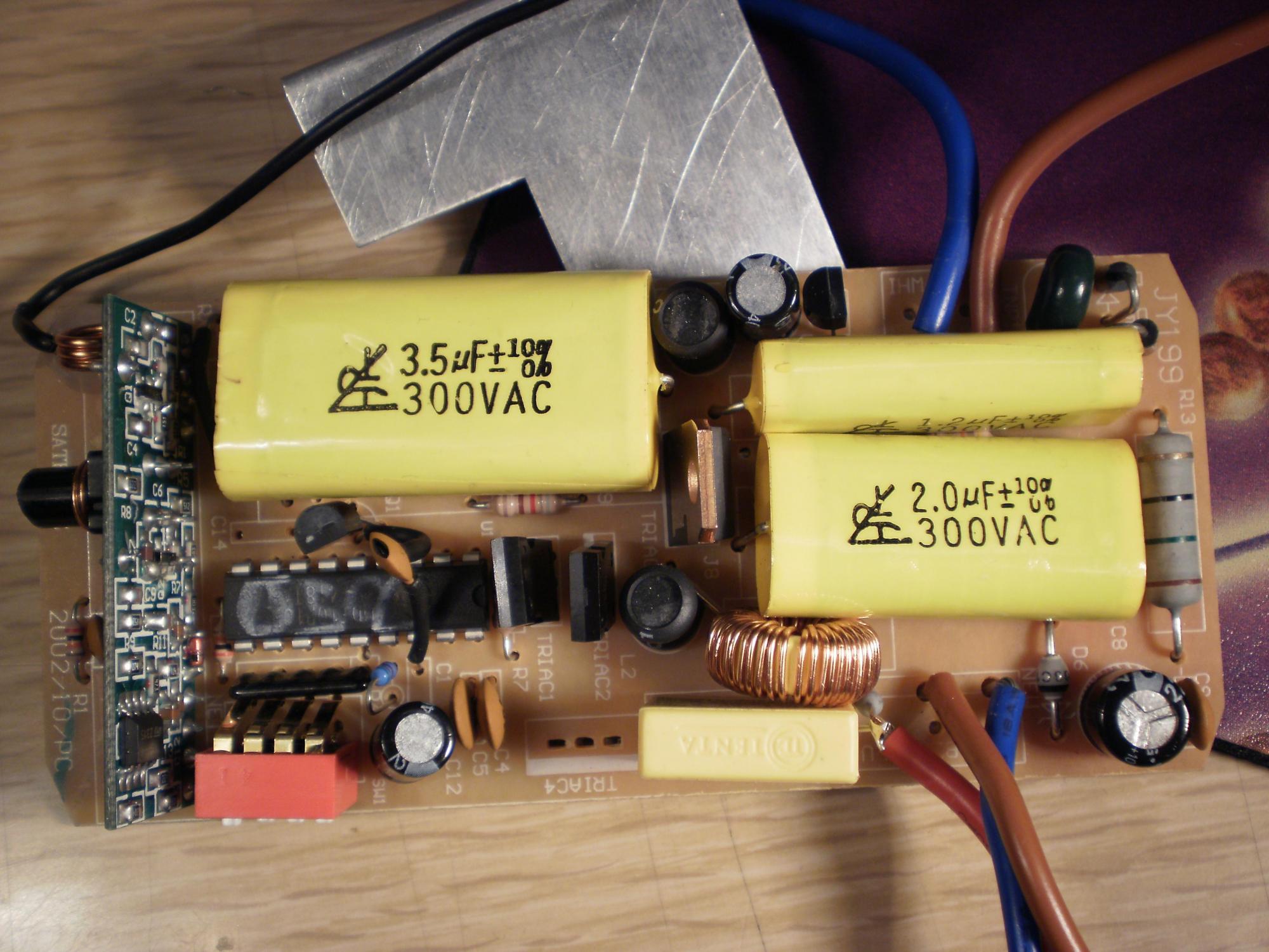

                          i've taken 2 pictures wich will follow so you can see it.
                          what should be checked next?

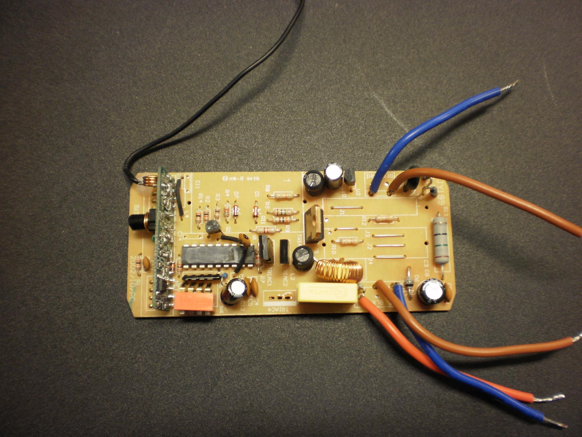

                                    I'd like to see the board component side with the 3 big yellow caps removed. Can you do that and take a picture please?
                                    veritas odium parit

                                      #38
                                      Re: testing RF remote (re-posting)
                                      here you go
                                      • Toasty
                                        • Jul 2007
                                        • 4171
                                        #39
                                        The part I expected to see is not in this circuit. Same as post 5, crystal or crystal resonator. Since it's not here, that is ruled out as a failure/problem.
                                        Either of 2 things at this point:
                                        1) the IC is bad. With the light latched on, I would believe this one more.
                                        2) the receiver circuit (little board) has a failure and is off frequency. That repair requires a scope at a minimum and the ability to generate the 433.9MHz signal.
                                        I think we've hit the wall at this point. I do not see the IC available anywhere.
