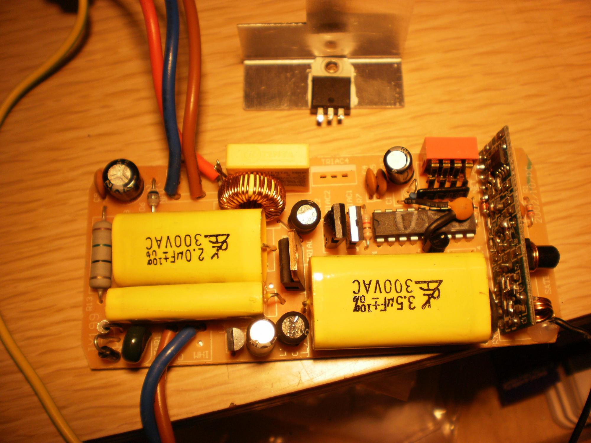

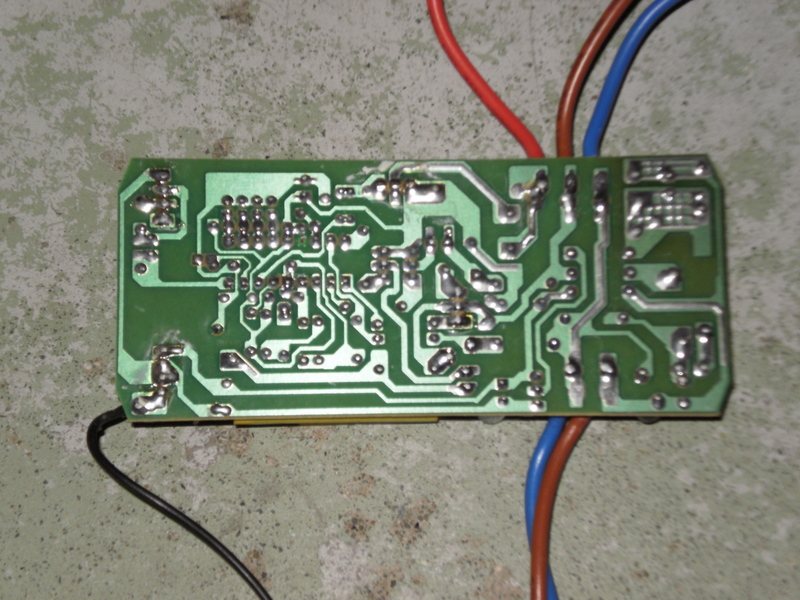

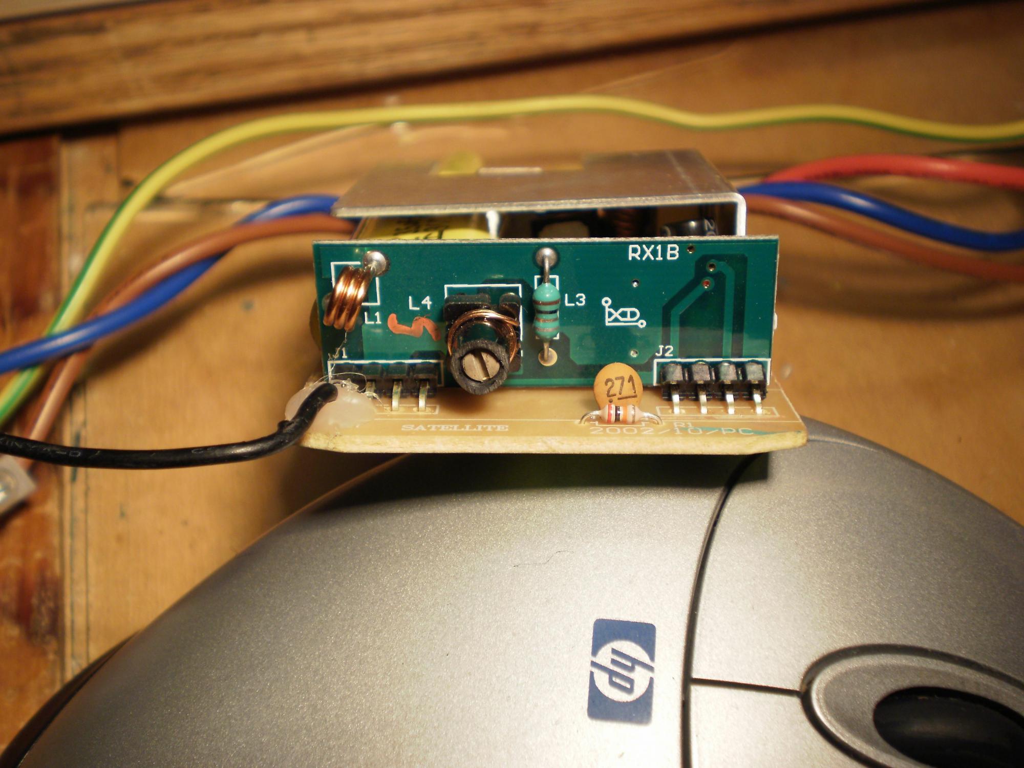

                          and here are the images of the reciever
                          http://img502.*************/img502/5445/pa310161.jpg
                          http://img12.*************/img12/4553/pa310163.jpg
                          One thing I noticest on the PCB was some white residue, is that something to concern about?

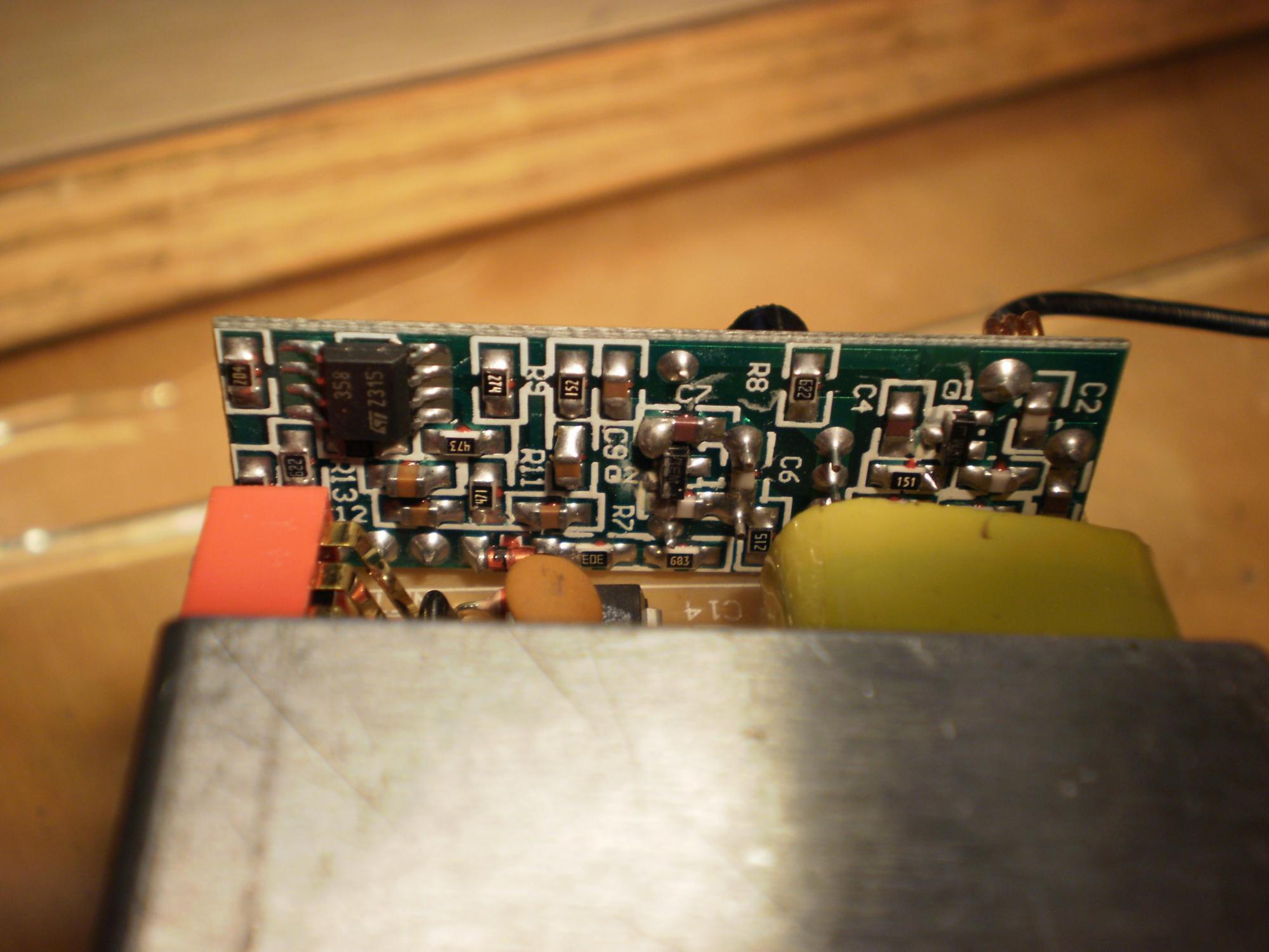

                            Pictures are a bit too dark and small to really make anything out clearly, but thanks for what you provided. The residue looks to be flux from soldering.
                            An end or some side shots so we can see what other components are on the daughterboard. What is under the metal heatsink? What components are under the 2 large yellow caps?
                            Please upload pictures directly to the forum. Use the Go Advanced button under the Quick Reply then choose the Manage Attachments button. You can upload direct from your computer or from a URL. Pictures hosted on external sites may "go away" for various reasons and then the info is lost here for the next person with a similar problem.
                            From what you have provided, nothing stands out as a problem. No darkened areas on the board or burned traces. FYI - a bulb that fails by shorting can take out the triac in the controller. I see this all the time in manual light dimmers.

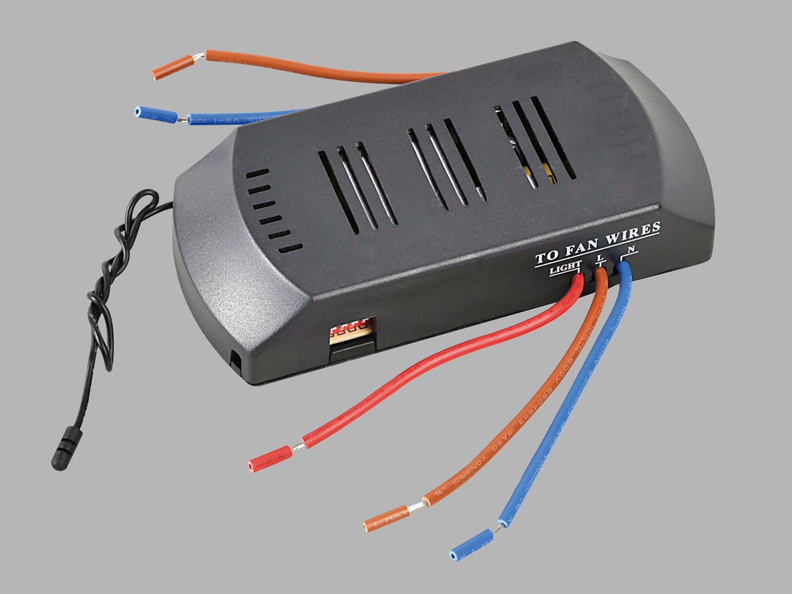

                            By their pic:
                            (The 3 wire side)
                            Red is Hot to the Light
                            Brown is to fan Hot
                            Blue is Neutral for Both
                            The 2 wire side, I'm guessing, is Hot (Brown) and Neutral (Blue) to the unit. There is no picture of that anywhere. Please confirm.

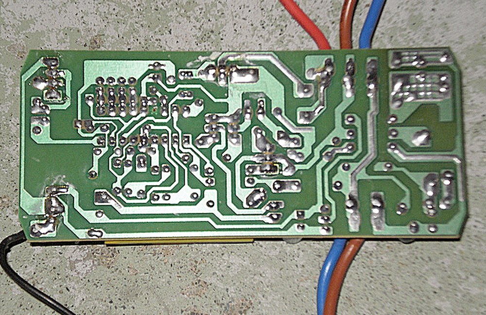

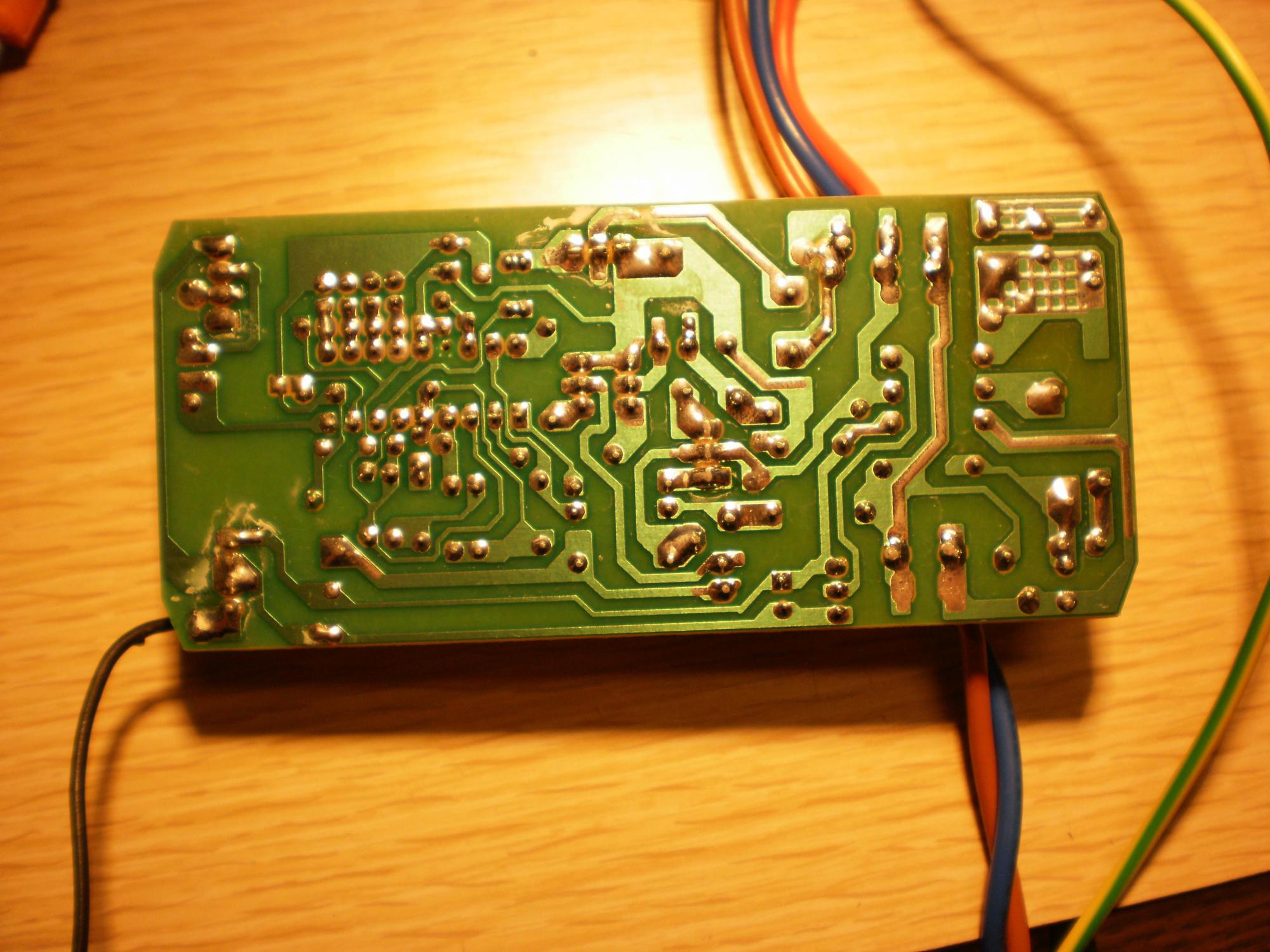

                            By the foil side pic, the Blue (Neutral) is a straight thru feed from input to output.

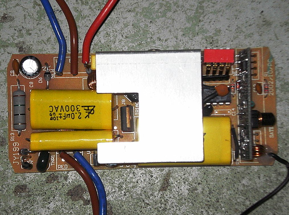

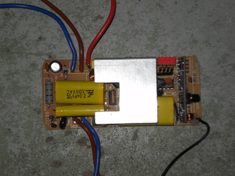

                            EDIT: I cropped, re-sized, sharpened, and brightened your pics and attached your pics from Imageshack.

                              Re: testing RF remote (re-posting)
                              yea sorry about that, I'm a terrible photographer but small? they were 12MP pictures, maybe imageshack had lowered them.
                              there are some resistors under it, I can take the yellow caps out if you want to see under them.
                              the board looks quite nice, besides the white residue. but the funny thing is
                              the light was working (was not able to turn it off though) and now it's not.
                              The 3 wires (Brown/Blue/Red) go to the fan
                              The 2 wires (brown/Blue) go to the ceiling/wallsocket
                              Thats correct, and by the looks of it, there seem to be also resistors connect to the line.

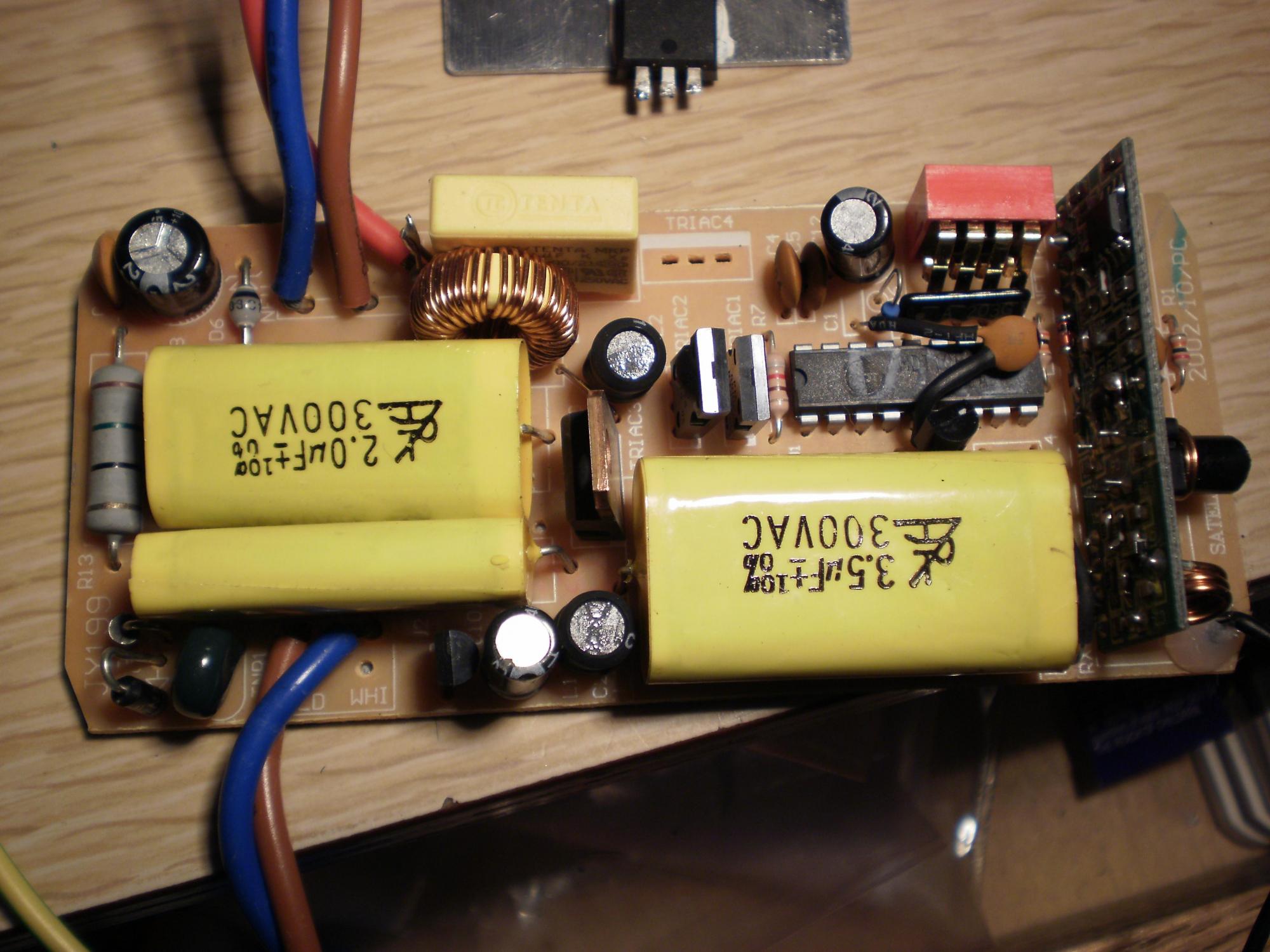

                              thank you for that, I hope the pictures I took now are better now

                                Dry testing means un-powered testing of the components using a VOM (Volt-Ohm Meter) aka. DMM.
                                Excellent job on the 2nd go-round of pics!
                                If the light is staying on, that makes me suspect the triac. It's likely shorted and staying on. The Red output is directly wired to the triac in the center.
                                Triac4 (heatsink) is the fan control device and feeds power thru the toroid coil to the Brown output.
                                The U2(?) device should be checked. It appears to be a voltage regulator and probably is the supply voltage regulator for the main IC chip. Again, with power applied, you'll need to test the supply voltage to the IC and see if it exists and is correct. Some datasheet browsing for the IC and the U2 device numbers will provide clues.
                                Resistors under those 2 yellow caps should be tested to see if they are in spec. as they supply power to the U2 device.
                                The flux residue should easily clean up with some isopropyl alcohol or methanol.

                                  how should I check the triac?
                                  I tried to check it with the Ohm, and got zero readings on pin 1 and 2, the gate gave me quick contact then 0. it was the triac4
                                  The U2, is that the secondary small PCB on the large one?
                                    U2 was a U2(?) so that means I can't be sure of it's designation. It looks like a TO-92 style transistor down by the incoming power next to (again) C10(?) and (again) L1(?)

                                      I belive that this is the U2(?)
                                      http://pdf1.alldatasheet.com/datashe...NGS/79L05.html
                                      and this should be the IC
                                      http://pdf1.alldatasheet.com/datashe.../MDT10P10.html

                                        Google for triac testing. Test all 4. Can you report their numbers please?
                                        U2 is a -5v regulator. You should see that measuring from the Common leg to the Output leg. If you have a VOM and not a DMM, put the Red/Positive(+) lead on the Common leg and the Black/Negative(-) on the Output leg.
