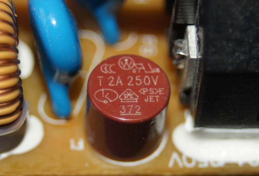

    This fuse is called what?!
    This 2A 250V LCD monitor fuse is blown.
    How one can properly identify and diffentiate a fast blow to a slow blow fuse?
    Thank you,

    That fuse is known as a radial fuse. They sell them at any online electronics supplier like Digikey.
    You could also replace it will a axial leaded fuse as well. They're called picofuses. They look like a standard axial resistor but they have a green package.
    There are also glass fuses with leads soldered to the end caps you could use too.

      It says T 2A. Its a slow blow. F is fast blow and M is in between

        Had to replace one of those in a screen as well, just try to find the cause before you replace it.

          The 'T' stands for 'Time Delay' or Slow Blow.

            Thanks for all the replies.
            The monitor had been working for a while now.
            I did a McGyver, cracked a 1A 250V glass fuse from my stash, use its filament to close the circuit underneath.
            I'm about to re-order caps at Digikey so this reminded me to properly fix this monitor.

              That's a first for me a slow blow on a LCD monitor supply.
              If the fuse is blown you have an over current condition somewhere most likely a bad semiconductor. You need to troubleshoot that first.
              Start on the primary side of the main power supply and work your way to the primary of the inverter supply.
