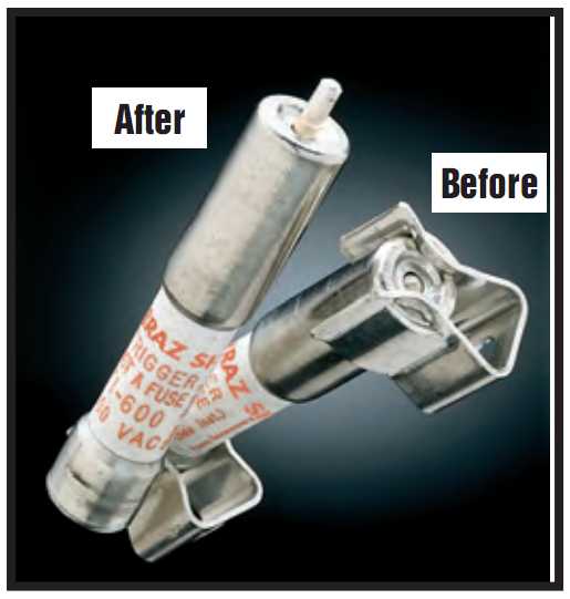

    Looking things over it had a glass main fuse with a piece of white ceramic center with a copper wire wound the length of the ceramic, Looking at the fuse it appeared to be intact. I am really glad I got the ohmmeter out. It was open and the $800 repair turned out to be around 75 cents
    Moral to the story even if it looks good TEST IT.

        Had an application in the navy that used these fuses with pop-up indicators on the end to show they were blown.
        I ordered a 10-pack at some point and they showed up already popped [blown] as new in the box.
