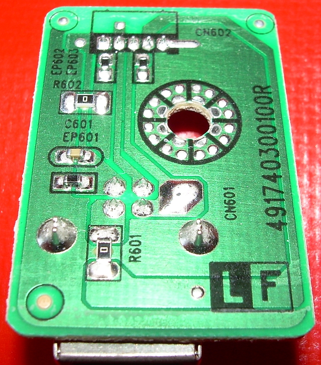

Anyone know what component pcb marking 'ep' is ?
Pcb Markings - what component is ep ?
Re: Pcb Markings - what component is ep ?
G,
Best guess is it's an SMT edition of a self healing fuse.
But I can be wrong.
J"You are, what you do, when it counts"
The Masso
"Gravity, the quickest way down"
Mayor John Almafi
"You ever drop an egg, and on the floor you see it break?
You go and get a mop so you can clean up your mistake.
But did you ever stop to ponder why we know it's true?
If you drop a broken egg you will not get an egg that's new?"
MC Hawking -
The resistors? The marking on these SMD itself says resistance value.
The other compoenents that is capacitors and protective devices like this should be open circuit. For zener it acts like diode when checked both ways.
That all, cheers, WizardComment
