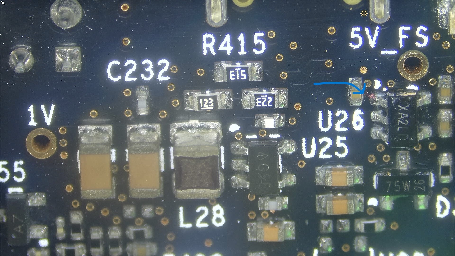

hi all need help with IC marking is XA2LD Sot-23-5
  • Barttech Computers
    • Dec 2024
    • 27
    • Usa
    I'm trying to identify a small SOT-package IC marked "XA2LD" located near the 5V_FS rail on a logic board. The silkscreen shows it as U26/U25, and it's adjacent to components labeled R415, C232, L28, etc.
    Here’s what I know so far:
    • The IC marking is XA2LD (possibly custom or abbreviated).
    • It’s likely involved in power switching or regulation (possibly a load switch or LDO).
    • The package appears to be SOT-23-5 or similar.
  • truclacicr
    • Apr 2019
    • 352
    • australia
    I see 3 capacitors. Could it be a dual fixed output LDO regulator with Enable?
    Could "2" be the year, eg 2022, 2012?
    U25 is AP3418:

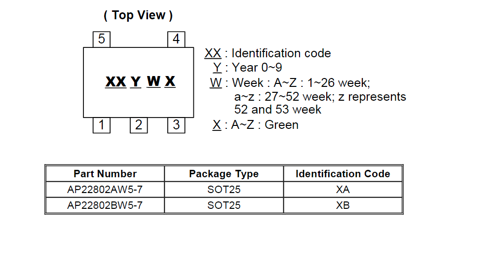

      Compare with datasheet U26 XAxxx - AP22802AW5-7
